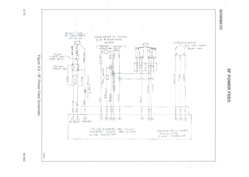

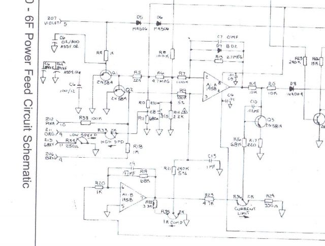

I worried that I might have made a boo-boo on the pot value, so I’ve just been out to measure it. Definitely 50000 ohms not 500. And it only has two wires connected. The control unit was made by Erskine Laboratories in Scarborough. My Bridgeport is an Adcock & Shipley clone, but I’m surprised they used a UK company for the controller. One would have assumed that the parent company would have just supplied their existing, US made, controllers.
The box has a cover over it, but I can just see one of the those old-fashioned Mullard multi-coloured capacitors; haven’t seen those since the 1970s! Mind you, my power feed works at the moment, so I’m not going to poke any deeper, as the wiring looks a little ‘delicate’.
Addendum: Much to my surprise Erskine is still doing power electronics in Scarborough, albeit now part of much larger group.
