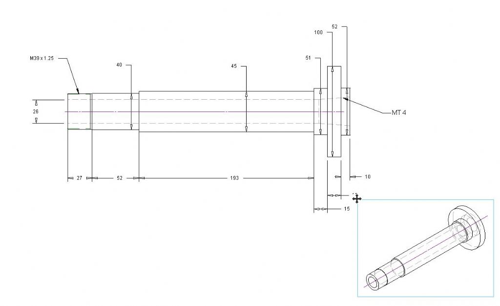

          The 280 headstock is 180mm long though there is sufficient 45mm dia on the spindle that a 190mm long head casting would not cause issues.
          Quick sketch of spindle below, click to make larger. Bore is 26mm to clear 1" stock, MT4 taper, Flange chuck mount. At the far end there is a section of 40mm dia which has a key slot and this takes the gear for feeds and the two step pully. Adjusting nut on the M39 thread. Spacer on the bit of 45dia that sticks out the head so that when nut is tightened everything pushes against the bearing. Sizes are as good as I can get without removing the spindle.
          Edited By JasonB on 15/08/2017 12:26:33

          Niels Abildgaard
            @nielsabildgaard33719
            Thank You Jason
            How do You like the flanged chuck connection or are You dreaming camlock etc all the time?
            #312146
              It is not ideal but I am used to it having had an Emcomat 8.6 for 20 years before the 280 which used flange mount although that did benifit from the short din taper rather than parallel. Luckily I have slim fingers.
              It may be possible to track down a spindle from someone other than Warco that uses the keyhole ring method as some are available with that option and a few have been seen with D1-3
              I'll keep dreaming of that late model Colchester bantam 2000 with its 13" swing, 40" between ctrs and a gap bed.smiley

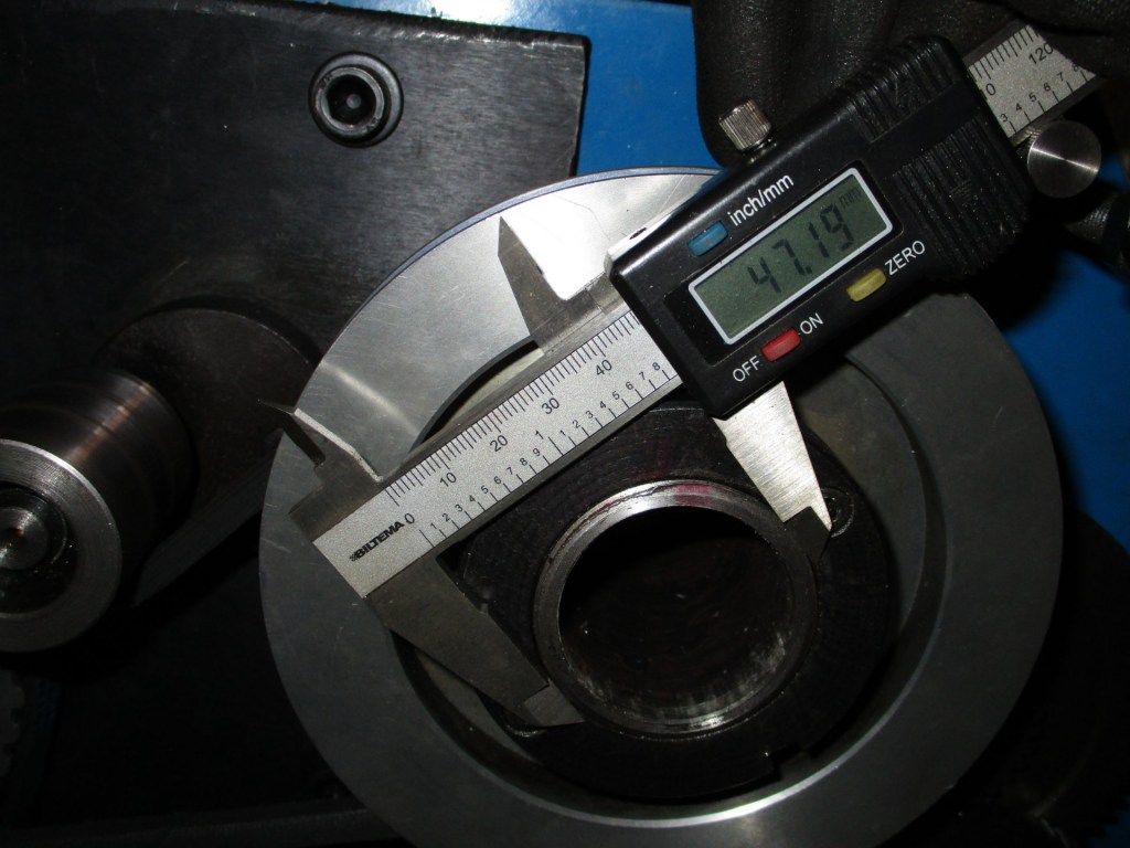

                            Thor 🇳🇴
                              @thor
                              Hi Brian,
                              I don't have the dimensions of the 290 spindle, but the manual says this for spindle bearing:
                              2007109E which should have I.D. 45mm, O.D. 75mm and W 20mm
                              I hope this may be of help.
                              Thor
                              Edited By Thor on 18/08/2017 13:07:03

                                #312710
                                  Posted by Thor on 18/08/2017 13:06:14:
                                  Hi Brian,
                                  That is interesting as it would imply that the 290 with its 38mm spindle bore has a rather thin spindle wall compared to the 280 with its 26mm bore as they use the same bearings
                                  However if that were the case then why would Neils have had to bore things out to fit larger bearings?? Though looking at his linked photos the headstock end bearing appears to be larger and I could not see that bearing spec in a large bore parts list I just checked
                                  Edited By JasonB on 18/08/2017 13:45:14
                                  #312718
                                  Thor 🇳🇴
                                    @thor
                                    Hi Jason,
                                    You are (as always) right, my manual clearly gives the wrong size of the bearing. I have just been in the workshop and measured the rear end of the spindle, an I.D. 45mm bearing wouldn't fit. Should of course have done that before posting.
                                    I assume the diameter is 47mm, I took the photo using one hand on the caliper, the other on the camera, sorry for not being able to line up properly.
                                     In the parts list you linked to bearing 14 is 2007109E (page 30 in the PDF).
                                    Thor
                                    Edited By Thor on 18/08/2017 14:28:38

                                                    #314459
                                                    Niels Abildgaard
                                                      Posted by JasonB on 15/08/2017 12:21:26:
                                                      Jasons idea is very smart.No headstock modification and much bigger spindle bore and /or bending stiffnes .
                                                      Let us calculate .
                                                      Existing set up is lower part of picture and outher profile of spindle is a short piece of 3.81cm and rest is 3.5cm diameter and spindle bore is 2.05cm.
                                                      For a first aproximation let us say 3,6cm outside with a hole of 2.05
                                                      Bending stiffness is a fourth power thing and is proportional to 3.6**4 – 2.05**4 =168-18=150(more or less)
                                                      The new spindle is 45 mm outside and i want to calculate how big bore for same bending stiffnes
                                                      Equation becomes 4.5**4-X**4 = 150 giving a bore of 4.0cm
                                                      Double bending stiffnes is 4.5**-X**4= 300 allowing a bore of 3.2 cm
                                                      If we do not modify the chineese spindle that is 2.6 cm inside we get a stifnesvalue of
                                                      4.5**4-2.6**4=365 or roughly 2.4 times the boxford spindle value.
