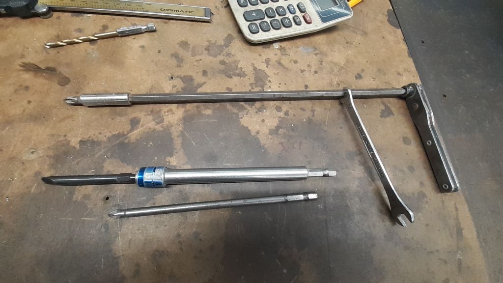

                  #583792
                    I carry 6" and 12" extensions with me so always plenty of length to swing an additional lever even if the screw is hard to get at. Also 6" bits in the commonly used sizes.
                    I also keep the ratchet shown in my site tool box which will give extra leverage when needed but it mostly gets used when there is not much room above the screw. I suppose you could machine a larger hex on the outer dia of the part that holds the hex.
                    A cordless impact driver is really the way to gowink you can also get more pressure on these to keep the bit engaged in the screw. You do need half decent bits as the cheap ones shatter quite easily even by hand sometimes. Same with the bit holders you can strip those if you put a lot of load on them. Most of my screwing is done with the cordless hence all the tooling is recess hex for the quick change holders I use. Hand driver of choice is the Stanley rathet

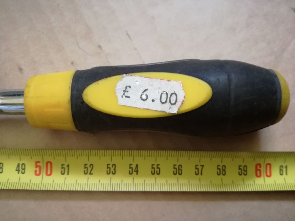

                      I keep one of these in the kitchen drawer, but it doesn't take standard 1/4" bits.
                      Links to https://www.stanleytools.co.uk/products/detail/Products/HAND+TOOLS/Screwdrivers/Screwdriver+sets/STANLEY%C2%AE+6+Way+Screwdriver

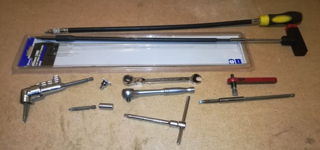

                        Hi, well here's a selection that I have for screws that are a bit tight or in such a position that you can't easily get a good grip on them. The long black metal one is actually and extension for flat wood drills, but at the time I needed a long extension for some screws, that's all I could get off the shelf locally and it did the job OK. The chrome connecter piece, to the left of the ratchet spanner and 1/4" drive ratchet and T bar with the extension, has a 1/4" socket drive which will attach to any 1/4" drive tool and has a spring clip in it that stops the bits falling out like they do in a normal 1/4" socket, the little red ratchet is a cheapy, but does come in handy for very small spaces and the long flexible one is also very useful, but you do need to be able to hold the rotating bezel at the bit end while operating it with the other hand. The handle on the angle drive, can be positioned in 12 different places around the whole of the body, it's sometimes awkward to use, but does help removing some screws from places where you may have to take a few other things off first, when you really don't want to.
                        Regards Nick.

                          Thanks a lot for the further replies and images.
                          I do do some of my screwdriving these days with a Dewalt DCF886 impact driver. I should probably do more. I still like to use hand drivers for some jobs where more feedback on the torque you're applying seems called for. My preferred bits are Wiha Maxxtor 49mm. Any specific recommendations for longer impact-rated bits or long bit holders like in Jason's photo would be welcome.
                          I've had one of those older-style, mainly black Stanley ratchet drivers for many years. It seems bomb-proof and has one of the best handles going, in my view. You can use it two handed quite easily, making the need for a hex bolster almost redundant. Bahco seem to have borrowed this handle design for their bigger Ergo drivers.
                          I believe the newer version (which is more yellow than black) of this old Stanley isn't as good for various reasons. I've only got the black one to go off, though.
                          Rob, the Chapman sets look high quality. Some of the bit holders appear to have opposing flats milled into them as an alternative to a hex. The snag with the sets from my point of view is all the bits seem to be short ones, they have ball bearings in their sides (which may mean you can't use ordinary 1/4" hex bits in the holders/handles?) and many of the sets seem to have a larger number of slotted bits than I'd really want and/or a big range of imperial hex bits I'd probably never use most of.

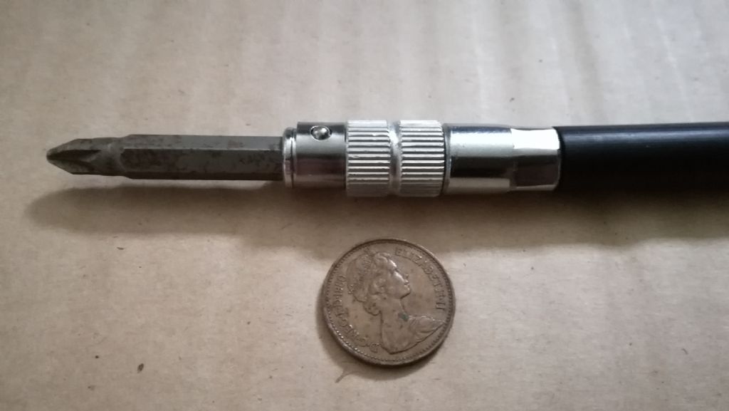

                          Nicholas, I'm interested to see your flex-shaft screwdriver. I don't think I've seen one as long as that. I assume, as with a lot of these, it's only safe to torque hard (-ish) in one direction, and in the other there's a danger of the braided wire shaft uncoiling.

                            Hi Bill, I bought the Flexi-driver some years ago but can't remember where from, I just thought it might be useful and it has been, but not an awful lot. It seems to have the same torque whichever way it's rotated and there is no feeling of it giving up in either direction, but will kind of curl up both ways, with a bit held in a vice and turning as much as I can without going overboard. The minimum radius it can bend at each end is about 120mm. However, I think the limiting factor on the torque is how well one can hold the bit in the screw with the knurled collar that allows it to rotate. It only cost £6.00 wherever I got it from.
