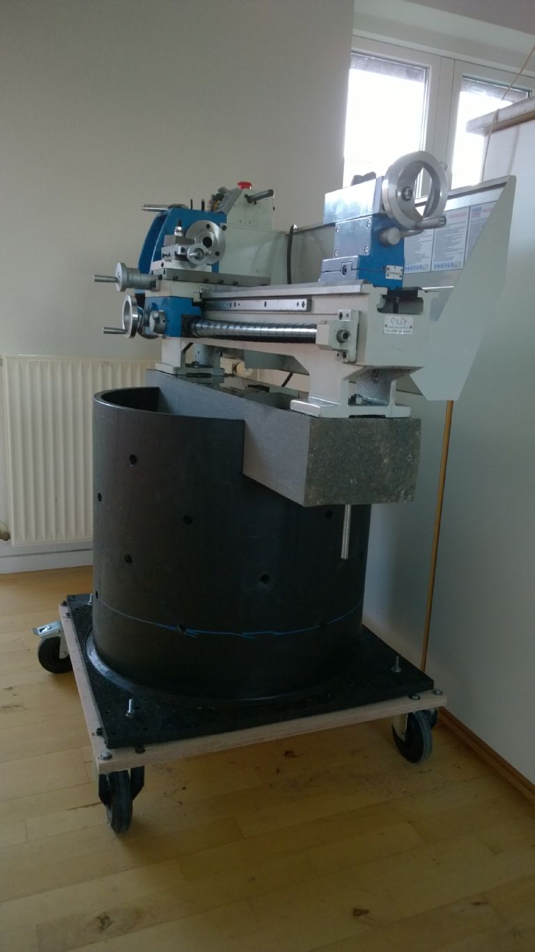

      My latest lathe toy is a VM250 6speed lathe.
      LatheCrane
      Edited By Niels Abildgaard on 27/11/2018 12:38:21

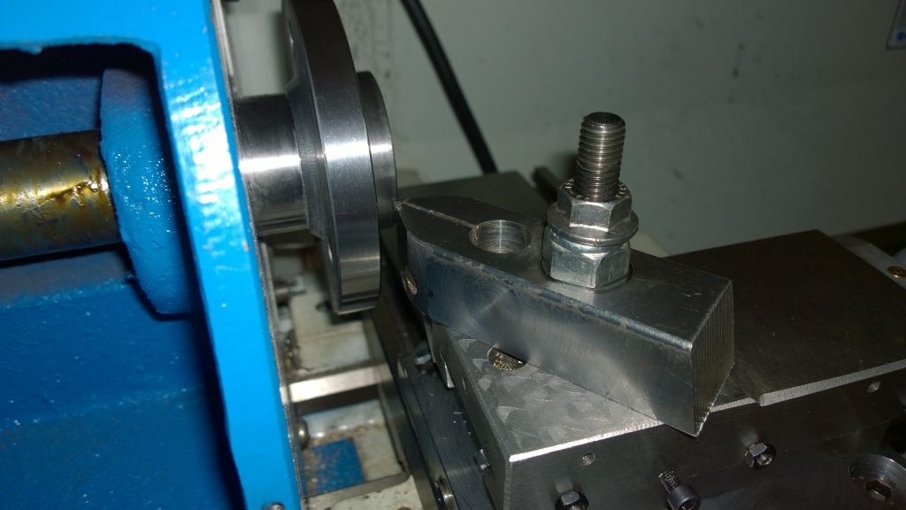

          The tool system is/was a copy of something sitting on a friends EMCO 8 50 years ago and it was idiotic even then.
          I have made something better.Tool System

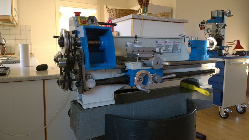

            My two very well made and reliable Weiss Maschines are getting more and more liked and have a chat
            Conversation in livng room.

              Wow, if my workshop were that clean I put a bed in it too. The 'tool system' looks like a tangential?

                Nice addition Neils, looks like a very substantial tangential tool holder, are you planning on making a few more holders of this size?

                  Niels what was idiotic about the supplied setup?
                  #382557
                  Niels Abildgaard
                    @nielsabildgaard33719
                    Posted by JasonB on 27/11/2018 13:03:29:
                    The force way from tip to bed is winded and long.
                    Rigidity is best and the solution I use (copied from SouthBend) is much more direct
                    Modern lathes have no compound arrangement at all

                        Modern lathes have no need for a comound as the CNC can move X and Y at the same time which I can't
                        It is undoubtably more rigid but is it really needed, I have managed quite happily with my 280 for 11 years and an Emcomat 8.6 for 25years before that. I don't just do small work and can often have the need to machine 250mm + cast iron flywheels or large steel fabrications.
                        The tool holder would also be quite slow when it cam to change tooling which I frequently do on a part and looks as if it will be a problem when working on small items when using tailstock support. 3mm round would be like using a tool with 1.5r tip, how do you get into corners with that without leaving a substantial fillet? A larger radius tool also puts more load on the lathe so maybe that is why you have had to increase rigidity.

                          What's going on here?……is that lathe mounted on a cast concrete beam?…..what's with the tub support which will get in the way of the turners knees surely(?)

                            I see you use a locknut – is that to prevent loosening whilst taking heavy cuts, as it does seem rather extended in the pics?
                            Martin.
                            #382568
                              You need the extra overhang as without it that big block mounted to the cross slide will get hit by the chucksmile p
                              not just a locnut but a nylock and a locknut.

                                    Given the sink and fridge freezer in the background, you appear to have a lathe in your kitchen.

                                      Posted by Chris Trice on 27/11/2018 15:16:07:
                                      I am a widower and cannot play piano so that went out and a lathe came in.
                                      It is my present living room-kitchen and this is the reason I prefer carbide tooling.
                                      I go bare-feeted and know imidiately when I have to vacuum to avoid injuring jaws of my dog.
                                      In a month I change to a bigger apartment with two bedrooms and the big room will get plywood all over for lathe and milling machine .Sawing,grinding and filing is done in an outside, unheated shelter.

                                        Posted by blowlamp on 27/11/2018 14:11:42:
                                        Martin.
                                        Excuse the late answer ,but I did not understand Your question.
                                        The nylon lock nut is a M12 and just give distance as the chineese M10 compound slide stud has no thread down there.
                                        The flanged M10 nut just came first when I searched for a M10 nut.

                                              #383910
                                              Niels Abildgaard
                                                Much better                Two pictures of different compound slide system.Standard EMCO copy
                                                Edited By Niels Abildgaard on 05/12/2018 10:01:54
                                                #383919
                                                blowlamp
                                                  @blowlamp
                                                  That definitely looks to be much more rigid, Niels.
                                                  As long as non of the new parts get in the way of anything, then it appears to be a worthwhile modification. thumbs up
                                                  Martin.
