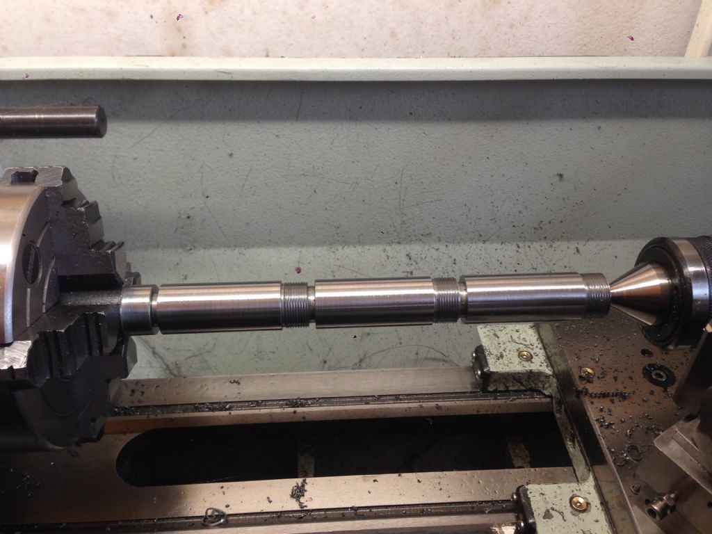

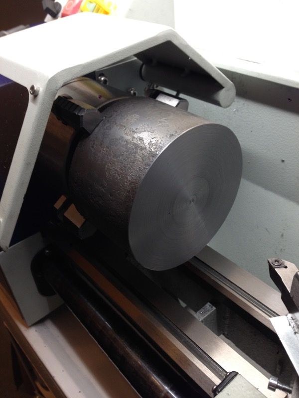

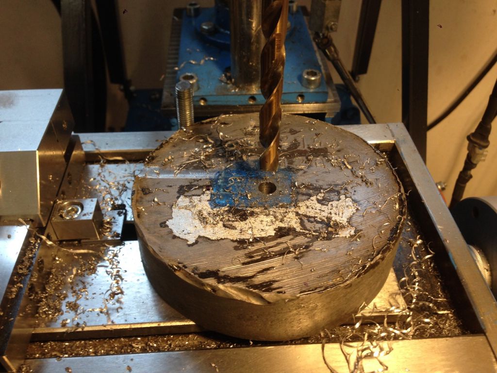

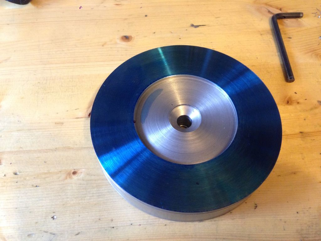

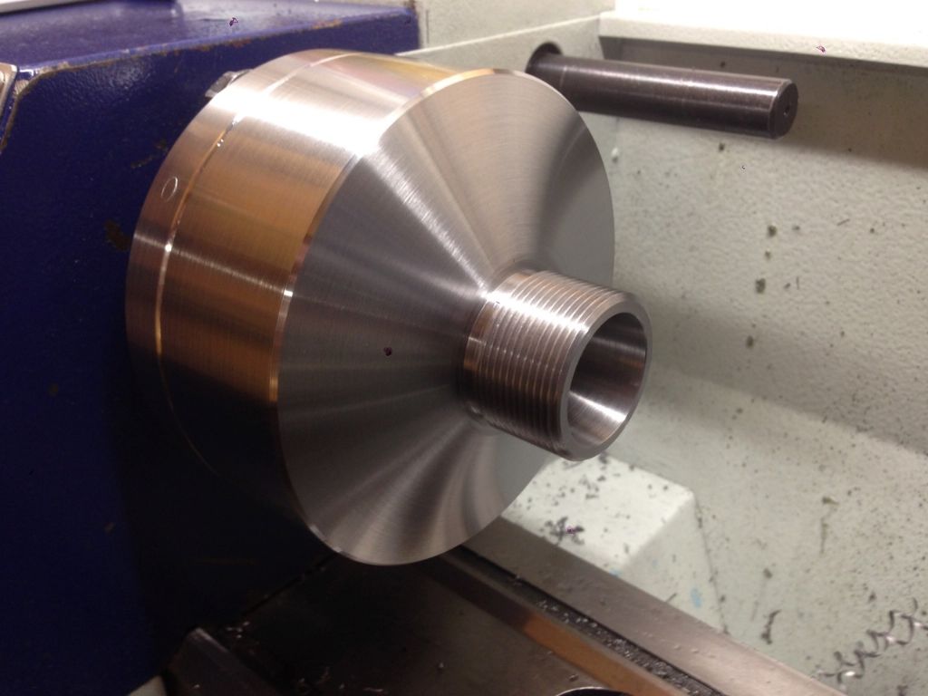

          I will start off this thread with pictures of my current ongoing project. It is a ER25 Collet chuck that mounts directly to the backplate of my mini-lathe. Why ER25 you ask? Well, ER32 would be better due to the upper size limit of 20mm which corresponds to the spindle bore instead of ER25 16mm max. But I had a set of ER25 collets for my milling chuck so I decided to reuse.
          The base material is S355 hot rolled, I acquired these slugs and this is what they look like after pickling in some vinegar to remove the mill scale. The leftmost piece (105mm dia) will be the chuck, one of the pieces to the right will eventually become a steady rest.
          I faced of one end and then got discouraged and left the lump for a couple of months…
          Well some months later things got started up again and now I just kept going, I started making the back face and register for the chuck. Strangely the register on the lathe is 72.04mm as best I can measure (caliper, could not reach with a micrometer, would be nice to have a set of disc-mics).

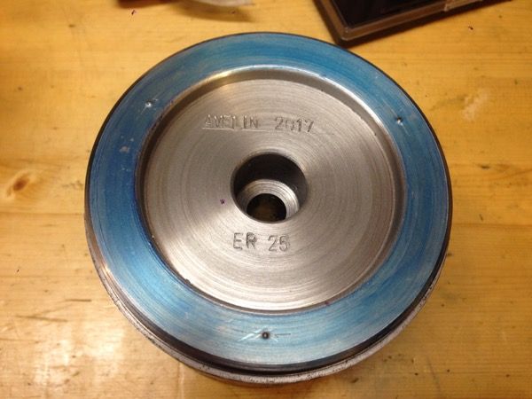

          Time to put a makers mark and drill and tap the mounting holes. I am quite surprised at how straight the stamping became…

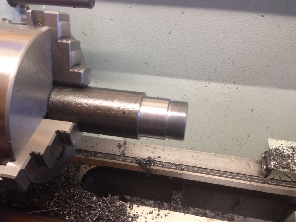

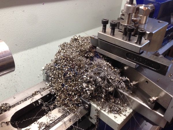

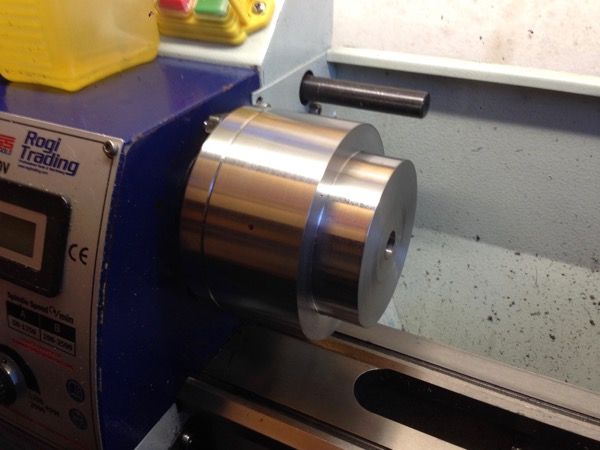

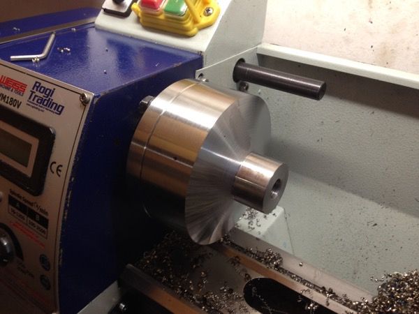

            I then proceeded to mount it on the lathe, a very snug fit indeed but it is removable. I call that a success!
            Now it is time to hog out some material, not a trivial task on this small lathe.
            At this point I was discouraged, I had been using HSS tools and the low rpm range of the lathe lacked a bit of strength at this diameter as well as it got hot and started to smell hot lacquer (nooot good). I then switched to insert tooling and maxed the rpm and kicked up the feed rate quite substantially and some time later and a bag full of chips I came to this point
            Next I proceeded to make a bevel on the front face, firstly for cosmetic reasons, secondly to get access with my threading tool to the small diameter.
            which also ended up with a mountain of swarf
            #287675
            Benny Avelin
              @bennyavelin86238

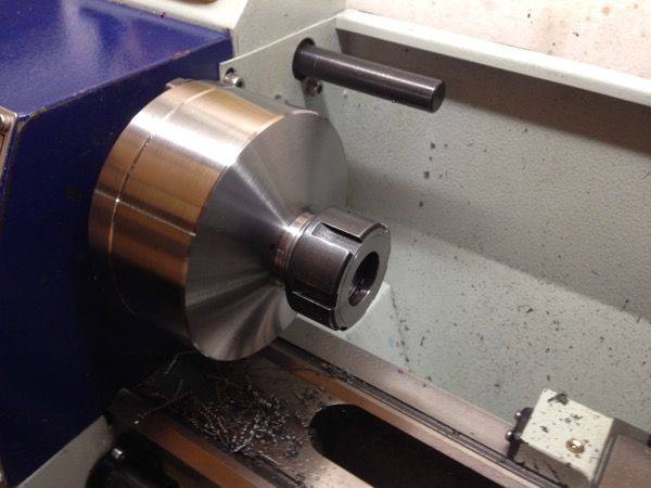

              Next I proceeded to thread the M32x1.5 thread and test fitted a nut. This is all for today.

                  How did you transfer the positions of the fixing studs from the spindle plate?….this was the tricky bit for me as you cant get proper access to spot thru accurately.
                  #287867
                  Benny Avelin
                    @bennyavelin86238
                    Bob. The way I do it is to measure the distance between the holes with a caliper and then subtract the hole diameter to get the cc distance. Then I use this table (disregard the Swedish)
                    to calculate the diameter that the holes lie on, this can then be marked out on the target, then using a compass to mark out the holes.

                      I managed to cut the taper today, I am not sure if I am going to grind the taper with a toolpost grinder or not.

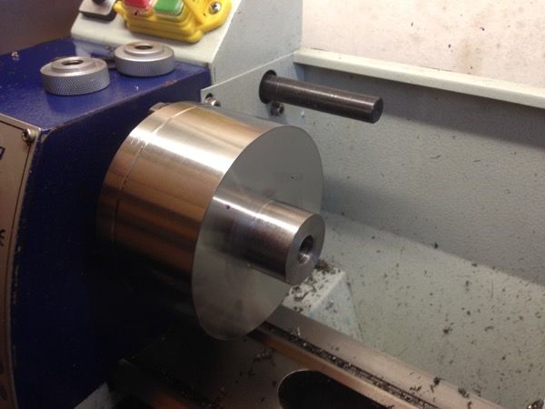

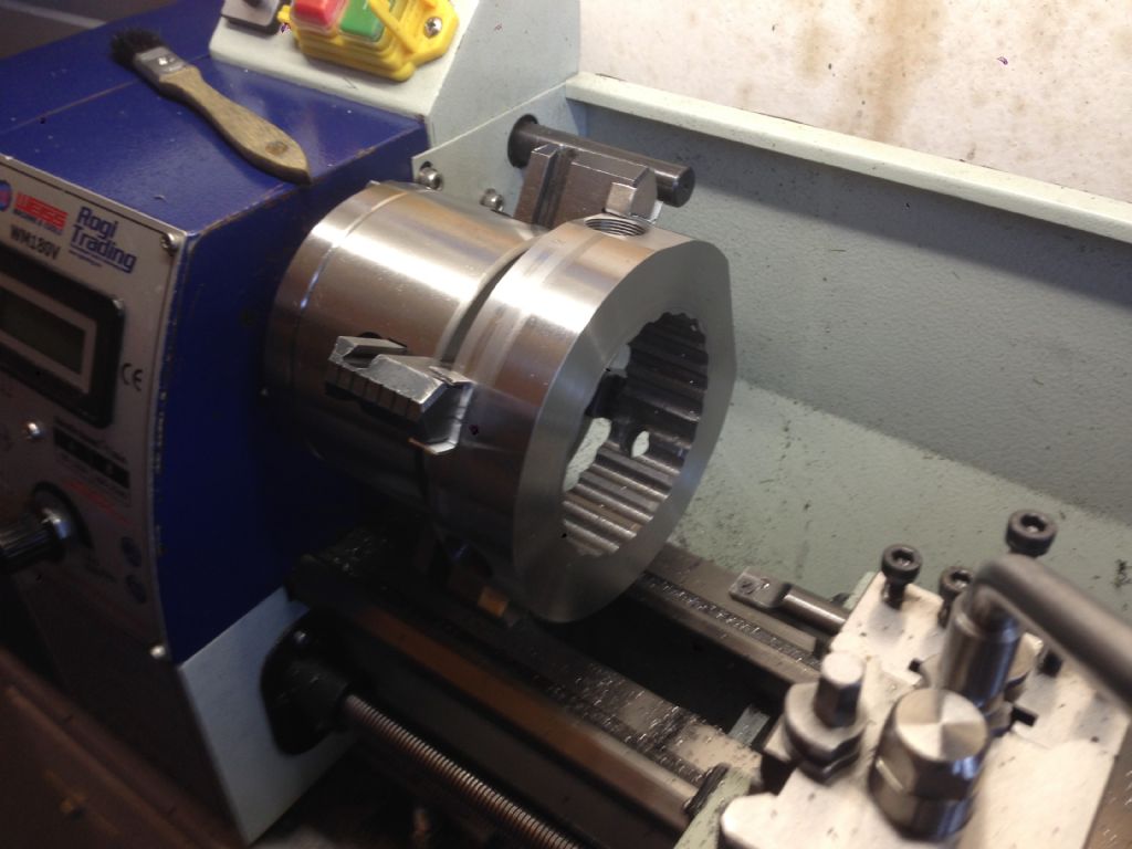

                        This was an interesting turn of events. When I removed the chuck to drill holes for a tommy bar, I realized that the fit over the register was almost loose but before it was a tight interference fit. My guess is that although it is hot rolled it must have been slightly compressed from the mill. This compression got reduced as I turned down the outer layer and thus enlarged the register by a couple of 0.01 mm. I am usually very wary about this when I mill cold rolled steel but I did not know this could happen. I would say cool! Apparently it registers good enough and I have 0.005 mm runout on the body and 0.02 TIR at a test bar 15mm dia 40mm out from the chuck, this is actually smaller than the stated runout on the collets, again cool! As everything seems to work I will not grind the internal taper since I got such a fantastic finish on it.

                          Him Benny, Nice work, looks a great finish. Am wondering why you made the body so wide ? I would have thought it would have been better to have the body thinner and thus the collets are then closer to the spindle nose.
                          Still nice work though yes.
                          #288009
                          Benny Avelin
                            @bennyavelin86238
                            Well it is a combinations of things that led to the wider body. My original thought was that it would look better, secondly it suited the material at hand, thirdly (and this is an afterthought) greater rotational mass seems to improve finish and reduce vibrations when turning. Maybe these are valid points but who knows it's a god question.

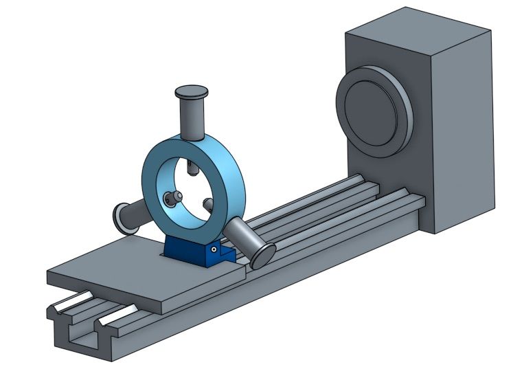

                              #288399
                              Benny Avelin
                                @bennyavelin86238
                                Begun mocking up a steady rest. I decided that this southbend type design is quite neat, now I need a good locking mechanism…

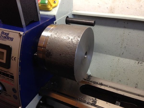

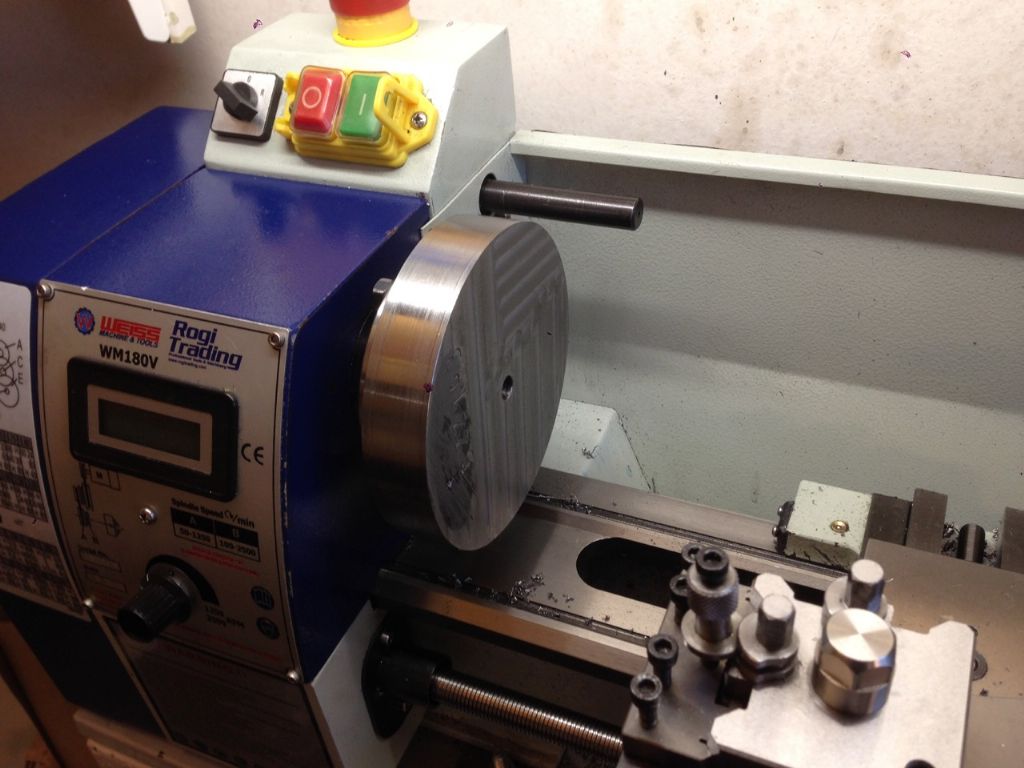

                                          #289062

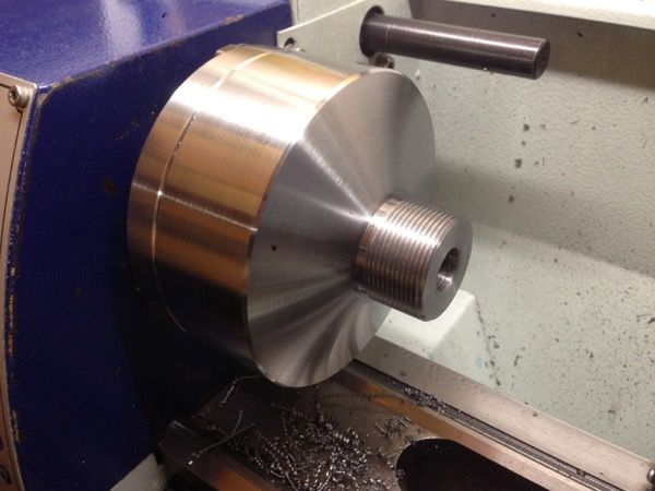

                                          Benny Avelin
                                            @bennyavelin86238

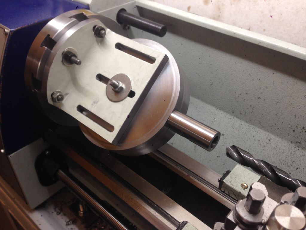

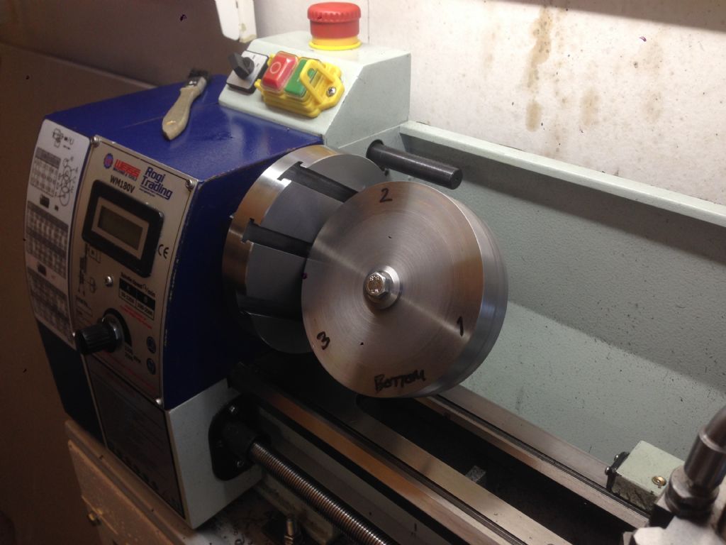

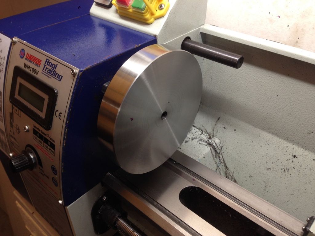

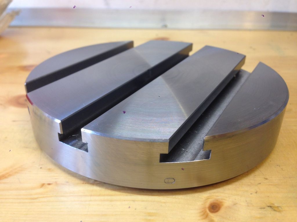

                                            Recently I have had a lack of time in the shop, but I managed to get some time to work on the faceplate. First I drilled and reamed a 10mm hole and milled a flat around the hole.img_2949.jpg
                                            I then pressed this onto a turned spigot and proceeded to face off and prepare the step for the spindle.
                                            The reason for the spigot is that I cannot mount this large piece in any reasonable way on the lathe. However drilling the mounting holes I needed to keep the disc flat on the milling table and since this is a scrap piece, actually the end of a bar I had to mill the other side reasonably flat before drilling the holes for the mounting screws. This is where I realized that end-pieces can be quite tricky. One of the edges had a moon shaped inclusion of steel that was noticeably harder than the bulk material, had to take it slow on my less than rigid milling machine.
                                            I then drilled the mounting holes and put it on the lathe.
                                            This is where I again noticed the problem with the hard inclusion, it showed up when turning. Even though I was taking material off the whole diameter the lathe sounded like it was taking a mild interrupted cut and the finish was terrible on the harder part. I hope it will not come back and bite me but I just decided to polish the surface until everything looked homogeneous.

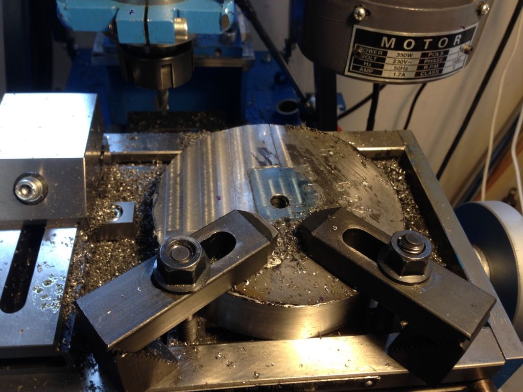

                                            I decided that the next step will be to mill t-slots in the faceplate. On the Myford you have a threaded spindle so the faceplate for that can have slots all the way through and almost all the way down to the centre of the plate. However these mini-lathes have this rediculous backplate making the faceplate concept less then ideal, therefore t-slots will allow me to move the mounting points as I please. I will be making the t-slots to the Myford dimensions to improve compatibility of things.
                                            Btw. In all my photos you will find splotches, this is due to my broken camera that I have not taken the time to fix (Iphone). Apparently a new camera costs about 10 £, but you have to disassemble most of the phone to get to it. Maybe I will take the effort at some point.
                                            Edited By Benny Avelin on 16/03/2017 08:43:40
                                            #289370

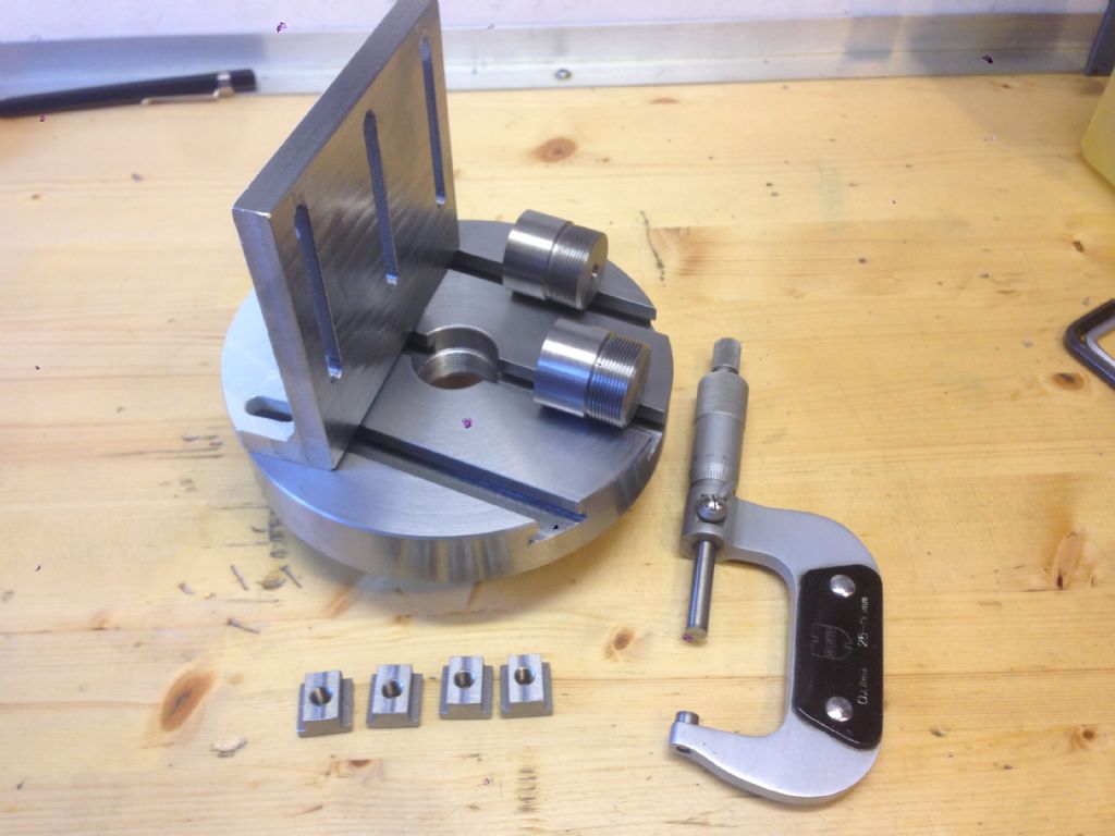

                                            Benny Avelin
                                              @bennyavelin86238
                                              I have now milled the T-slots. Wow that was time consuming smiley
                                              Of course it got crooked after milling. So now how do I get it straight again? Maybe I should try to straighten it by pressing or should I just mount it back on the lathe back plate and that would maybe make it straight, as long its on the lathe.
                                              #290612
                                              Benny Avelin
                                                @bennyavelin86238

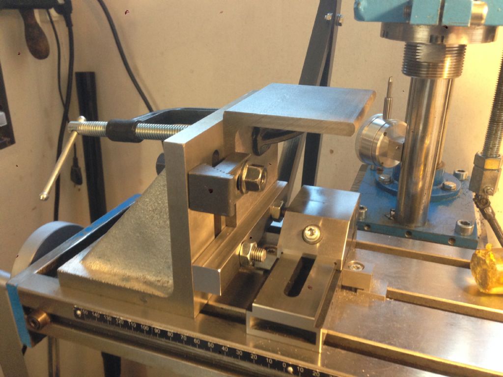

                                                Making an angle plate from some hot rolled angle iron, not the best material as it seems to have a high resonance.
                                                Making center plugs for the faceplate, the idea is to be useful in locating and also to be able to attach mandrels and such.
                                                This is the current state of affairs, what is left is completing the centerplugs
                                                Another view of the same
                                                Thats all for now.

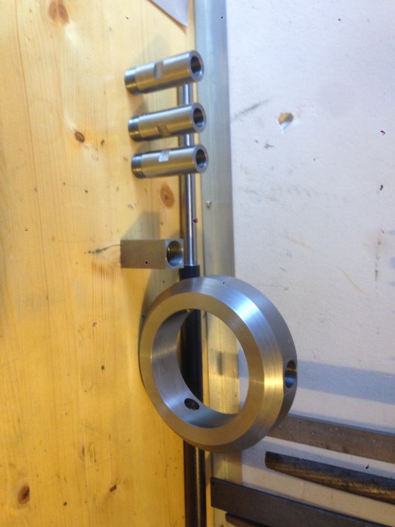

                                                #294208
                                                Benny Avelin
                                                  @bennyavelin86238

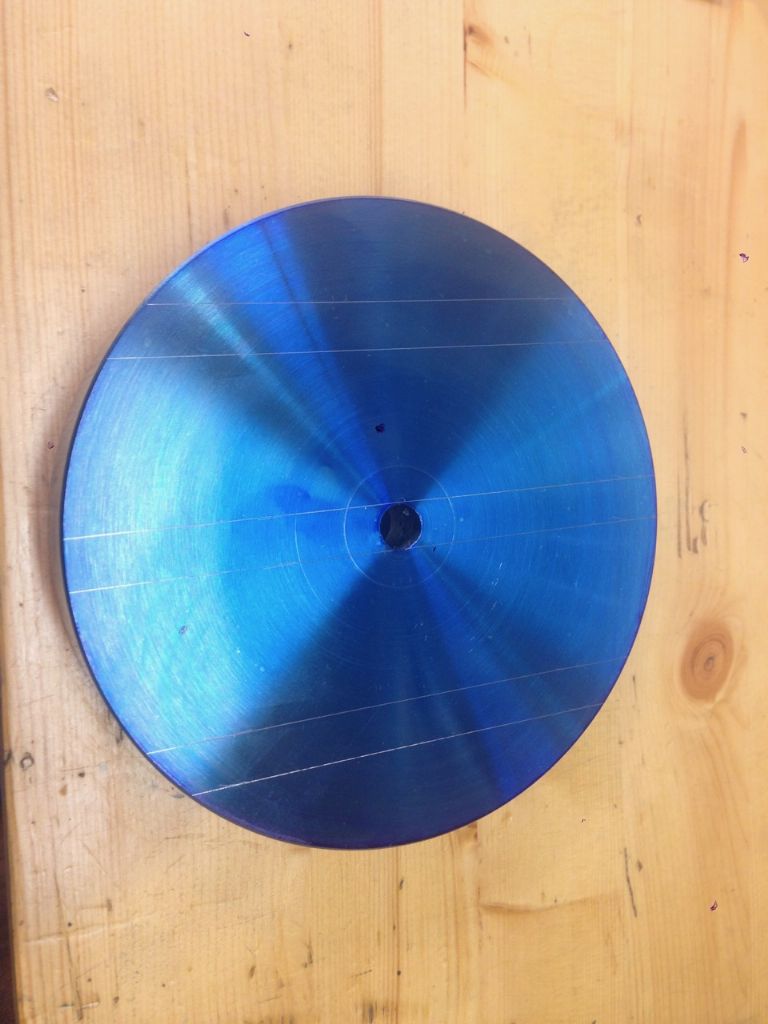

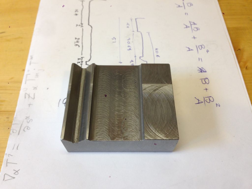

                                                  I have begun working on my steady rest, this is the first machining operation, getting a flat disc with a hole in the centre.

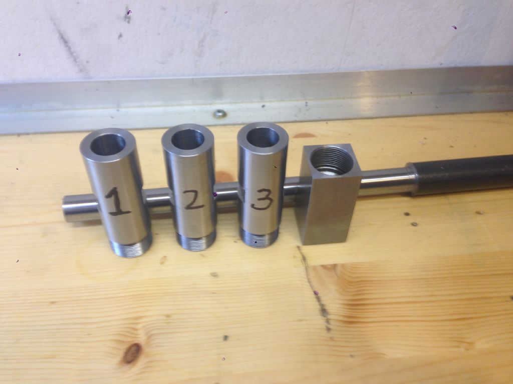

                                                  These are the "sleeves" that the rods for the steady rest will go inside.
                                                  I wanted to make this steady rest by drilling the three holes for the sleeves and this was the reason for making the faceplate and angleplate that I showed earlier.
                                                  This is how the holes came out with this setup, worked just fine.
                                                  #294210
                                                  Benny Avelin
                                                    @bennyavelin86238
                                                    To improve concentricity I drilled and reamed the sleeves in the same setup.
                                                    These are the finished sleeves and the arbor to hold them while milling the flats for a spanner. Behind is the 12mm material for the rods.
                                                    When all operations where done in that setup I drilled out the centre, so much swarf…
                                                    #294211
                                                    Benny Avelin
                                                      @bennyavelin86238
                                                      I also finished the bottom plate with the vee grove, fits just fine.img_2987.jpg
