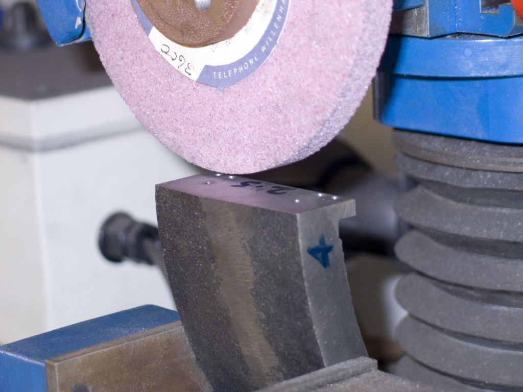

          My Union tool & cutter grinder works reasonably well as a surface grinder for the few odd jobs that I need to do.
          Unfortunately they are not that easy to find second hand, but hey do turn up now and again. I made a bespoke head for mine so I could run the wheels at a faster speed, and it also fits the cross slide of the Myford if I need to do cylindrical grinding.
          This shows it grinding accurate angles on the segments of my model mill engine flywheel.
