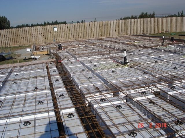

                              Ian S C
                                @iansc
                                Here in NZ the earthquakes over the last 3 years have seen changes in the requirements for concrete floors. Don't quote me on the dimensions. the area gets dug out about 600 mm packed down, I think a layer of black plastic goes next, then gravel, then 200 mm thick foam plastic, with gaps between , reinforcing is layed in the gaps, then the reinforcing mesh is put on top of the foam blocks, on top of plastic cones, then comes the concrete. I'v got a photo on the camera that I'll put in my album soon. Its called raft flooring, underneath there are all these 200 mm ribs with a fair bit of steel. Friend has had to put his workshop on hold until he gets an engineer to design a floor for it, he was just about to start building last year, when the new regs., came in. Ian S C
                                #144514

                                    #150904
                                    Ian S C
                                      @iansc
                                      This is the preparation for a house near to my place, this design is the result of changes made after the earth quakes 3 years ago. That is 200 mm thick poly foam.The right hand side is where the workshop would be, that's the garage. dsc00757 (640x480).jpg Ian S C

                                          #150921
                                          John McNamara
                                            @johnmcnamara74883
                                            Hi Ian S C
                                            The concrete construction method is also called a "waffle pod".
                                            **LINK**
                                            Fairly easy to construct and they use about 20% less concrete, also minimal excavation is needed if the step up to floor level can be accommodated in the design. Excavated material is becoming very expensive to dispose of in big cities.
                                            Regards
