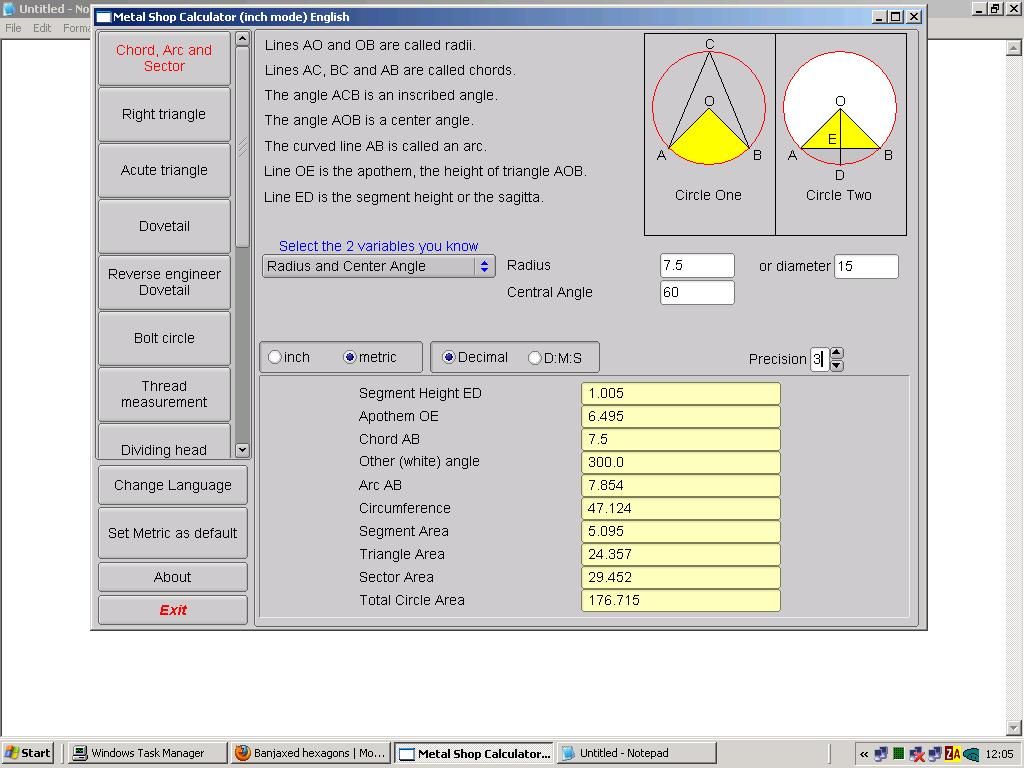

                  There's a small free computer app called Shopcalc.exe which you should find somewhere on the net
                  According to that, you should go in 1.005mm, or basically, one mm
                  Also, the max size of any flat should never exceed 7.5mm (A-B)

                                    From earlier post depth of cut = 0.067 D , where D=15mm
                                    so depth of cut = 0.067 x 15 = 1.005 mm
                                    Probably check the actual bar diameter first and use the measured value – not sure how close it will be to nominal.
                                    Looks like your hexagon will be very close to 13mm AF (1.00 mm off each side).
