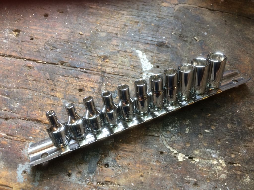

                      Its coming up for Christmas present ideas – This set of Ba Sockets 0 to 10ba are exquisite and come from one of our regular suppliers Mac Models. They are 1/4" drive and the set comes with just the sockets (because you probably have a 1/4" wrench).
