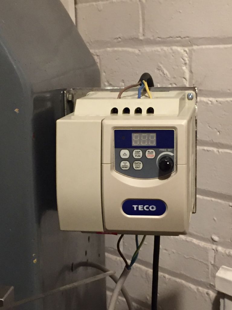

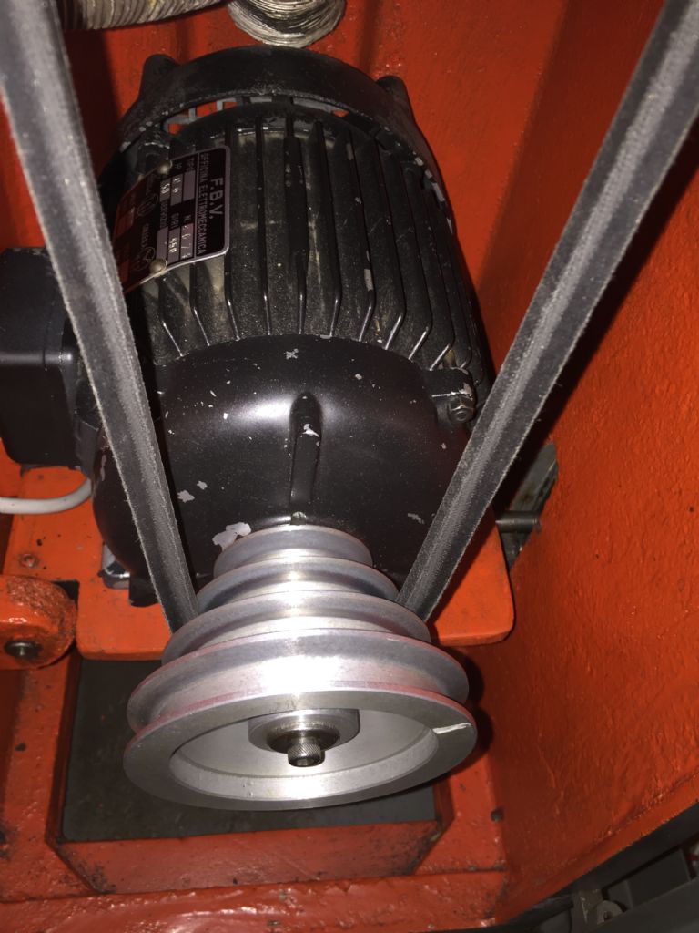

              Hi Jim,

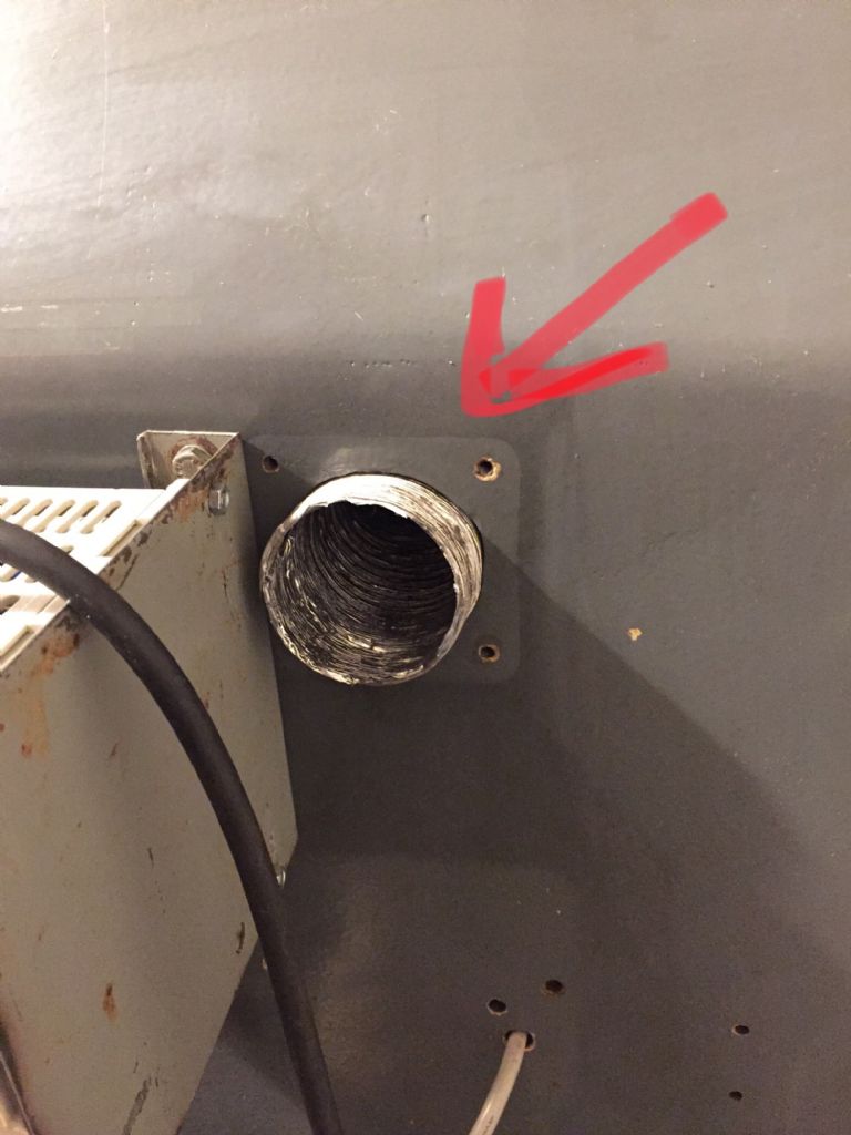

              My L4 came with the original 0.6 hp 3 phase motor and a four step pulley so I changed the connections on the motor from star to delta and bought a variable drive to run it off 240 volts. I also inserted a pipe in place of the switch to give the motor a better flow of cooling air.

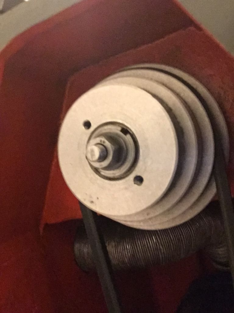

                The speed control is really a necessity for horizontal milling of steel. I recently finished fitting a triple pulley set to the Astra. It was from a cheap pillar drill. The previous owner of my machine had fitted a washing machine motor with a home made basic variable speed capability. The motor did not produce sufficient torque with the pulley arrangement he had. The additional reduction and choice of ranges provided by the new pulley set has made a world of difference. I can now actually remove metal with the Astra.

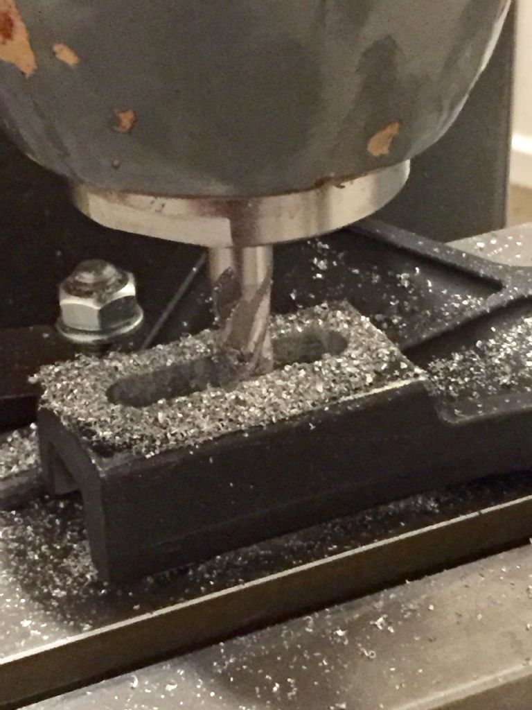

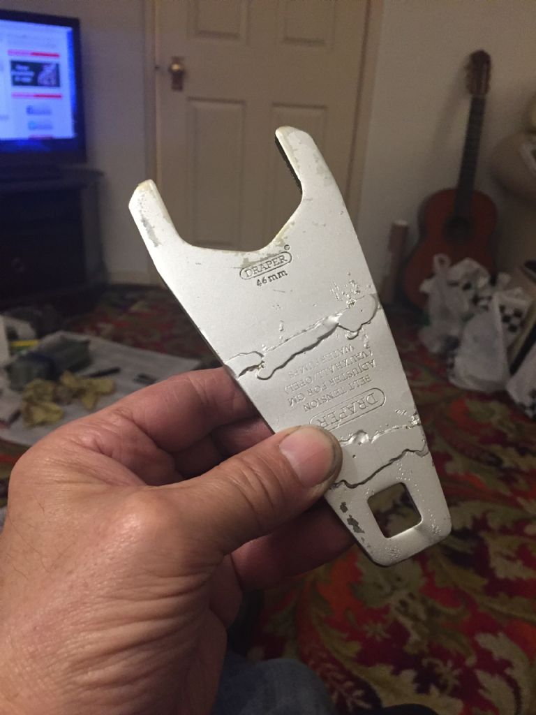

                  I am also using MT2 collets directly in the drive head to gain some much needed workspace hight, and in order tighten or loosen the drawbar nut I filed two flats on the edge of the shaft and straightened out a 46mm water pump spanner with which to hold it, you can just see one flat in the first image.
