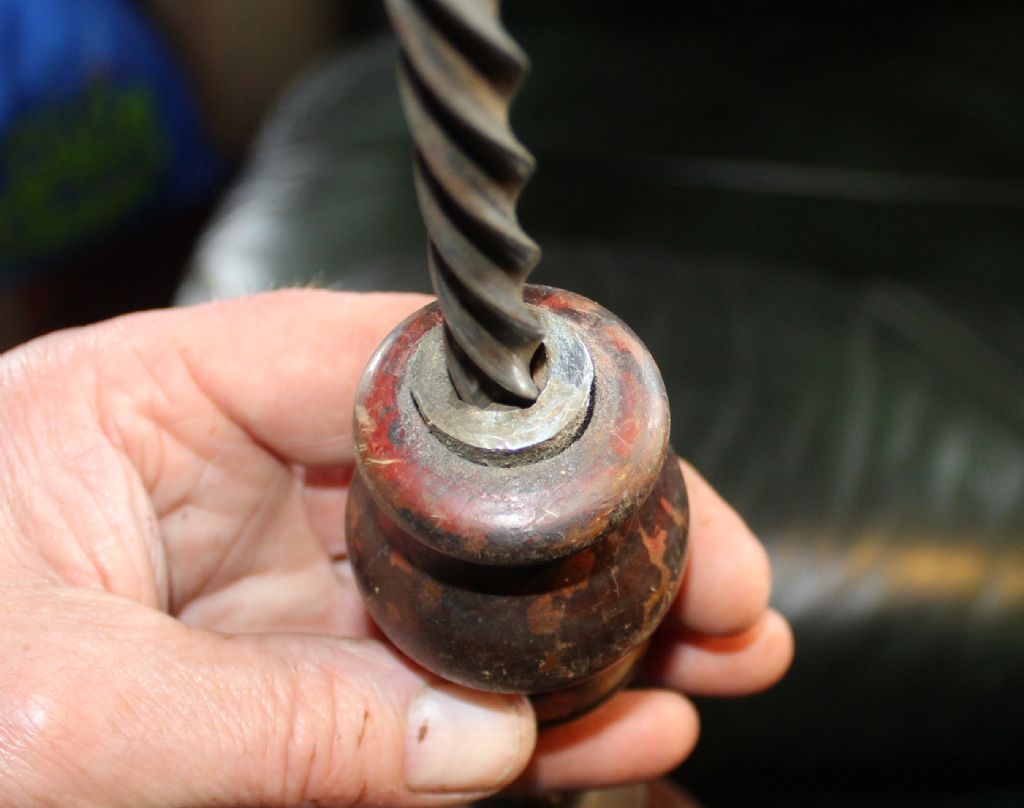

      drill 3.jpgdrill 2.jpgHi all,
      Just got this rather nice Archimedes Jewellers Drill from France.
      The sliding section is a brass insert in the ebonised beech wooden part.
      It should engage in the twists in the central spiralrod to rotate the shaft when pushed down but is completely worn out.
      Anyone have any thoughts as to how I go about replacing this part? It does not matter if I have to turn a new wooden part in ebony or whatever.
      The shaft ia approx 1/4" diameter and a very 'slow' spiral as shown.

          I'd remove the three screws and take out the insert to see how its made. The grooves on teh spiral are quite deep and you may find its nothing more than a series of pins that engage the spiral that should be easy enough to replace

            I wonder if you could cast the part around the existing spiral rod in some kind of resin, perhaps adding powdered bronze to it. PTFE spray or similar as a release agent. I'm sure others on here will know more.

                  Sorry guys! First thing I did was to take out the three screws! Inside its just a piece of brass rod with a hole through it. At one time there would have ben (might !) a hexagon shape to the hole but very hard to tell. Will take it apart again and post a pic when I have a moment.
                  Neil: I suppose that it is possible that the end plate had filed gooves (points ) to fit into the spiral I will ;look more closely at it under a glass.david: like the idea of resin casting!

                    John McNamara
                      @johnmcnamara74883
                      Hi Martin
                      If you Google the following words:
                      epoxy bearing materials and method
                      You will find a few posts I made for an epoxy bearing material process I developed in 2011. There is a PowerPoint presentation attached to them showing the process.
                      It used Araldite (The slow cure version not the 5 minute) to cast a nut. It is available worldwide. I also used the material to re-bed my lathe saddle after the ways were reground. I still use the lathe and there has been minimal wear since rebidding it.
                      The material is easily turned. one method might be to after applying a liberal amount of release agent to the splines of your tool thickly coating the spline shaft then allowing it to set. After it has hardened for say 2 days turn the coating to an even diameter and tidy up the ends (without touching the splines!) and press it off. To make a nice job of your tool maybe you could replace the brass bearing with one counter bored from the inside so that the epoxy nut is unseen. You could epoxy the turned down cast nut into the brass section.
                      The epoxy coat has almost no shrinkage, maybe coating the splines with a liberal coat of shellac before you apply a release agent would be a good idea. It will provide some clearance once the shellac has been removed with methylated spirit later. Otherwise the cast nut will be a very tight fit. I still have the test nut I did in the presentation. It has never worked loose. It also has a metal sleeve.
                      The design uses metal powder. Recently I had to turn some hard brass rod down. the brass turnings came off as very fine flakes. I kept them! While a bit coarser than the metal powder I suspect they might work for your application. You could experiment.
                      Regards

                            Even if not that old it is a future antique. Therefore the original wood and brass should be retained and a small slug of brass soldered into the tube to file to the required shape,

                                Thanks guys, I like the idea of 'casting' an araldite sleeve over shellaced core, will give it a go and report back.
