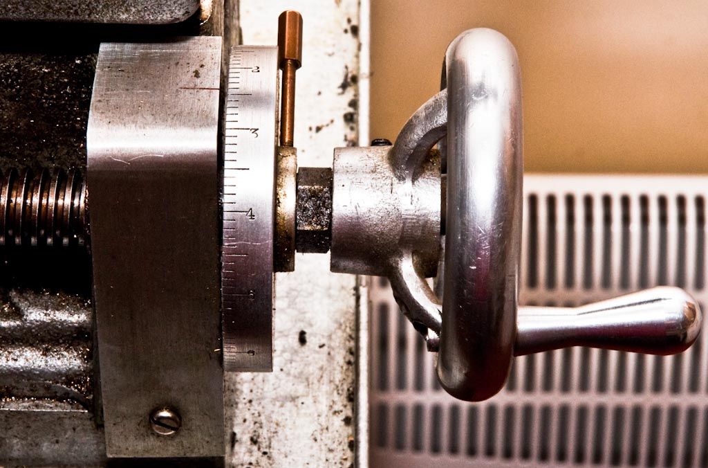

                              When I had an ML10 I did this for the leadscrew dial. The aluminium disc was fixed to a bush which was a close running fit on the end of the leadscrew. A hole was tapped in the bush to take the screw ( made from a bit of phosphor bronze hexagon – that I happened to have by me!) and this nipped it to the LS when required. All a bit Heath-Robinson maybe but it served me well for 20+ years! The only problem was that of inscribing 125 divisions on the periphery of the disc to match the 1/8in. pitch of the screw. Despite access to a well equipped college workshop and knowledgeable tutors the best they could come up with was 124 divisions. In the event that proved quite satisfactory for all the time that I had the lathe!
                              Regards
                              Norman
