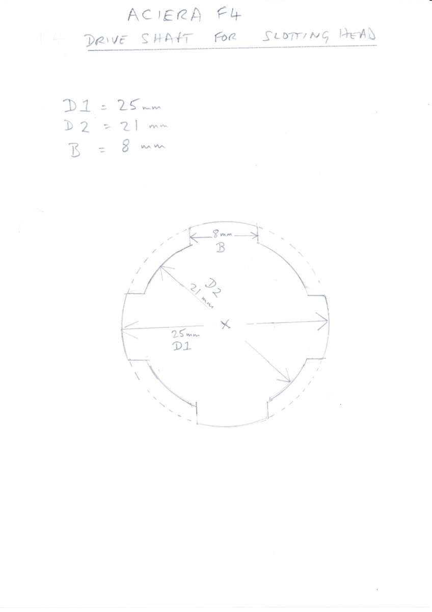

          #716532
          DC31k
            @dc31k
            Please could you advise length of part. Something 30mm long is a different proposition to something 300mm long.
            Providing it is short enough, at 8mm wide, some pre-drilling and plunge milling to remove excess material (preferably before forming the 21mm bore) would make an armstrong method on the lathe less laborious.
            I am not sure it makes any difference, but OD of the part might be useful.

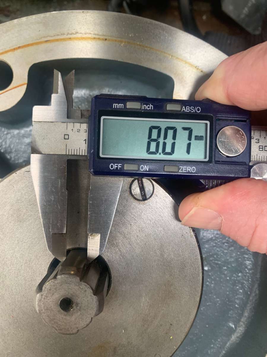

            Adam Harris
              @adamharris13683
              Sleeve OD 35mm, length 75mm. Please see attached diagram and photo. Aciera F4 drive shaft for slotting head
              #716536
              Adam Harris
                @adamharris13683
                IMG_5364
                #716537
                Adam Harris
                  @adamharris13683
                  Sides of splines are parallel , not sloped (as they appear in photo)

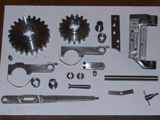

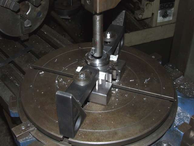

                                  Anonymous
                                    I assume this setup is what the OP was looking for; pity I’m in the perspiring dreams place:
                                    Slotting_2
                                    And the finished gears with internal splines, top left:
                                    Gear_Change_Final_2
                                    The slotting head on the Bridgeport has a 4″ (100mm) stroke.
                                    Andrew
