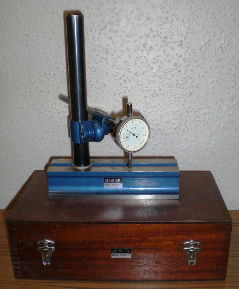

        Hopefully somebody can tell me something about this?
        #521354
        Oldiron
          @oldiron
          Looks like a Mercer 108/401 comparator stand. Used in a test lab or toolroom. It is a very heavy piece of kit and very stable.  Could also be a CE Johansen item as they were almost identical.

            I have one, but don't remember noticing a maker's name. To elaborate Oldiron's post, if uncertainty persists, the small dia. rod, lying adjacent to the corner of the base casting, fits into the clamp already fitted on the vertical rod. A dial indicator is clamped onto the small-dia. rod. It's a very high quality, and rigid, stand, for use primarily on a surface plate. Horribly expensive new!

              Another vote for a comparator stand. For inspection room use rather than production. Production comparators would have the reference surface incorporated into the instrument. The name Sigma seems to ring a bell.

                        Hi, here's a photo of the Mercer 108/421 that I have. Looks a little different than the O/P's one.
                        Regards Nick.

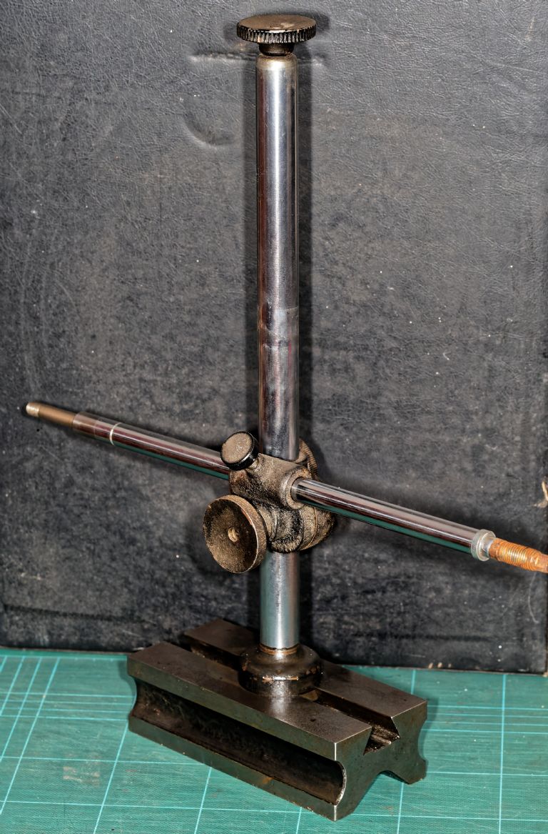

                            Not the best of photos, I forgot to do it before it went dark.
                            Anyone know what make mine is please, just out of curiosity really.
                            Almost certainly UK/US as the sizes are imperial, ½" hole for the cross bar, so this shock absorber spindle is just too loose. 13/16" for the column.
                            The base is 6"x 2¾" x 1 ¾"
                            Thanks
                            Bill

                                  Posted by Nicholas Farr on 21/01/2021 20:38:43:
                                  Regards Nick.
                                  Edited By Nicholas Farr on 21/01/2021 20:40:35
                                  Nice box Nicholas. Have you got the platen that goes with the base for comparison measurements? I have one some where but not sure where at the minute.
