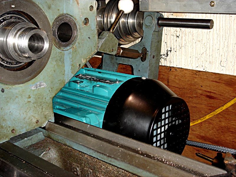

        You can buy motors John specifically intended for variable frequency drive. This can even include taking account of circulating currents doing nasty things to the bearings in the motor. There are plenty about where they have just added forced ventilation. Some get a better balanced armature. Costs escalate – too much as usual.
        Brooke at the time I bought my motor – very cheap because it seems they have a shelf life before they should be relubricated – were talking to Mitsubishi, if I understood correctly along the lines of building inverters into the motors. Mine runs ok at 100Hz anyway but I have no need to drive it that fast and given the lack of hard info would wonder what might happen to it. I doubt if I could find another similar motor at the same price.
        My main reason for posting what I did is that there are people who will assume that pulleys and gears aren't really needed when an inverter is fitted. One cropped up on another forum recently. Do away with all of the pulleys on a miller including in this case a pretty extreme reduction gear. The low speed end is the main problem. There are retailer that would say fine and sell a package to do exactly what he wanted to do and no mention of the sort of problems he could have. He eventually found the correct TEC catalogue and seemed to get annoyed because it showed him that he couldn't do what he wanted to do but still wanted to do it. Then comes a video of a demo from some one else – drills hole running normally then changes the cutter to sort of face cutter – more like a fly cutter, slows right down with the inverter and faces around the hole. Great but that operation took about 30 secs..
        Most people who fit inverters and look into it fit a more powerful motor than the one that was fitted to try and get round the problems. One good thing about Brooke motors in my view is I get the impression that they are concervatively rated. I don't really have any interest in running at very high speeds. I went for a 6 pole to help get round the low speed problems. Some get attracted to 2 pole motors on the basis that 2,800 can simply be slowed down to what their 4 pole currently runs at. winkMost I am aware of stick to 4 pole but I decided to be different. For really low speeds I just have to swing 2 levers so went to 6 pole. It works out well for me. It on a Boxford ME10, 1HP i was sure that the frame size would fit easily until I actually put it in place. Finished up having to add some M4 fixing holes to do it – high tensile of course.
        1hp is a bit big on an ME10
        The front bearing cover is normally on.
        Edited By John W1 on 28/06/2015 17:36:22
