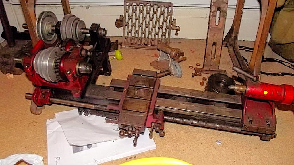

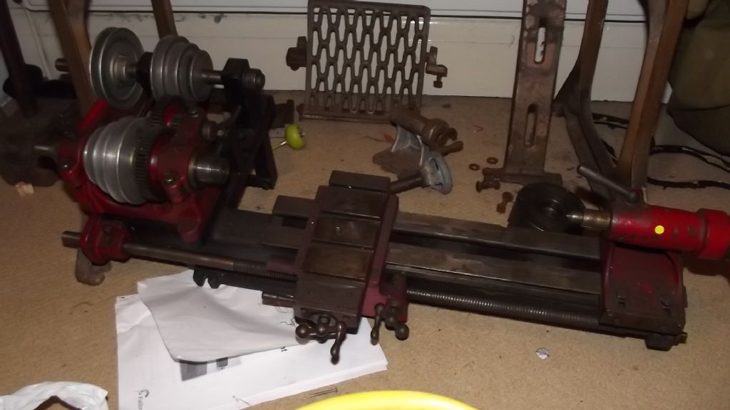

        New (well of course not actually new) lathe! Aceria escaped me but heres what £55 gets you at auction.
        15×3, screwcutting [no gears :^( ] and backgeared with countershaft.
        Of course lathes need motors! For a nominal charge of £20 or something heres what you get
        Boy it was fun lifting that up.
        In addition to the lathe the lot had a 3 jaw chuck, a spare tailstock and saddle.
        So questions:
        Anybody know what lathe it is?
        Is 2 HP too powerful for it?

            Thought it could be a Winfield/Randa, but although the tailstock looks right, headstock and cross slide details look wrong.
            Could be a Zyto, maybe even this very rare one:
            Zyto BTC 3"
            Zyto BTC 3"
            A later model was advertised as the 'finest and cheapest lathe ever produced'.

              The tailstock and the rear headstock bearing with that rear facing fork look very Myford ML1 ish.

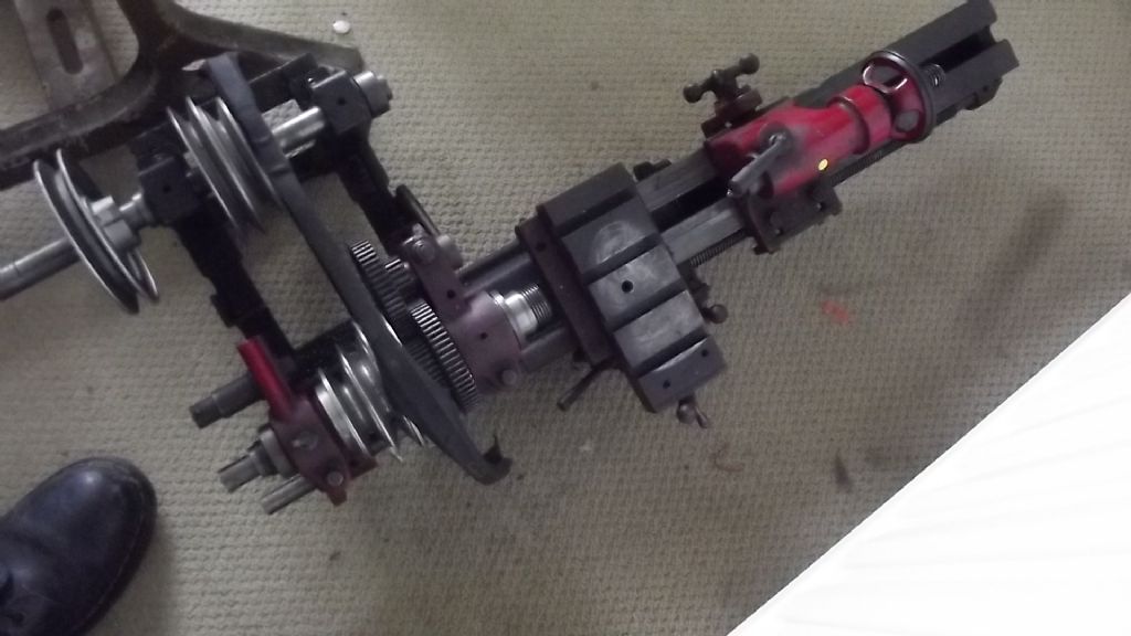

                Be better with a front view or even one with the lights off sooner than a top view wink

                  Well spotted, although with the four-slot cross slide an ML2 might be the one.
                  http://www.lathes.co.uk/myford-ml2-ml4/
                  But Rainbows doesn';t have that sort of luck… does he?

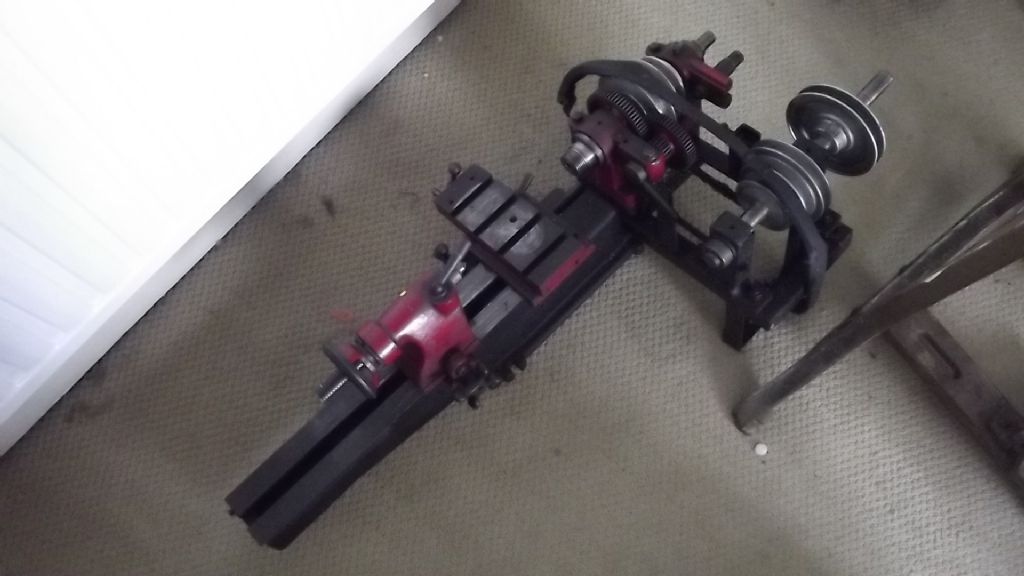

                    Significant points
                    The screw cutting is controlled at the saddle rather than with a toggle switch at the headstock.
                    The headstock is bolted on suggesting against an ML1 though I agree they do have great resembalance in parts.
                    Countershaft is almost definetly home made and bolted onto the castiing.
                    It came with a Burnerd 3 jaw chuck marked "Speacially made for Myford ML7 Lathe" and instead of using a backplate is threaded on the body. (which is convenient cause I lost my thread gauge)
                    And you know I mentioned a spare tailstock and carriage? Without mounting it on to be certain I would say the spare carriage fits the lathe too.
                    Also there is a protrusion on the countershaft that kind of stops front views by making them top views. Once I find out what it does I will either cut it off or wait for it to be something other than incovenient.

                      Augmenting the photo a little it might be an ML 1 1/2 or at least a copy. Myford would cast their name in the bed
                      ML 1 !/2 as some sell these as ML 2's but there is no tumbler reverse.

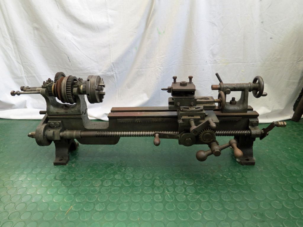

                        Hi All,
                        Does anyone recognise this lathe on ebay.
                        I've been offered one just like it, for free and will be collecting soon
                        Just curious as to the make?
                        geoffhttps://www.ebay.co.uk/itm/Engineers-metal-turning-lathe/123068281811?hash=item1ca770f3d3:g:QssAAOSw73Nay34c

                                  Geoff, the lathe has some features in common with the Brittania No. 14 from 1890-1900 – see **LINK**

                                    Andrew, thank you for your reply. Yes the lathe shown does have some characteristics of the Britannia lathe.
                                    I have yet to collect my inherited lathe from its current location but will post some pics when I do.
                                    I'm reasonably sure that it is Leyland and Barlow, made just down the canal from where I live in Trafford park Manchester

                                      When I looked again at the two photos I realised there were subtle differences everywhere, the Leyland and Barlow looks like a perfect match though.
