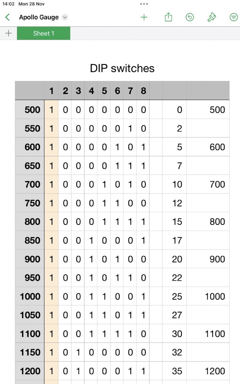

        So … I peered into the tank and decided that the boiler’s opinion was good : there was just enough oil to reflect my torch-light, but the tank is effectively empty.
        Therefore, the mighty Apollo must be telling porkies !!
        I unplugged it from the mains, and had a look at the DIP switches:
        1, 2, 3 are ON
        4, 5, 6, 7, 8 are OFF
        This configuration is not listed on the setting chart in the instructions !!
        so what does it do ?
        I don’t need help, I worked it out this morning
        … but I thought some of you might enjoy the puzzle.

                          I agree with your analysis, John … but that wasn’t actually the question
                          What I asked was what setting just 1, 2, 3 ON would mean.
                          … because that’s how it was set.

                              Switch 1 is just the warning sound enabled. That's why it is always on in the table.
                              123 is 2425mm depth with warning on.

                                so depth might be around 1300
                                1 = 500mm …eg depth of 500mm
                                7 = 50 … eg depth of 550
                                6+8 = 100…. eg depth of 600
                                So 650 mm is 1,6,7,8 ie 500 (1) + 50 (7) + 100 (6+8)
                                Therefore 1,2,3 is ….well, I haven't got round to adding it all up but I think that is the gist of it

                                            2425

                                                I will show my working later, but I ended-up with 2420

                                                  O.K. here we go …
                                                  The first obvious problem is the presentation of the ‘switch setting chart’, which serves only to obfuscate a simple table … so I put all the values into a simple spreadsheet.
                                                  Then we note that Switch_1 serves a special purpose, and is not relevant to the height of the tank.
                                                  The pattern [clearly visible when the settings are neatly tabulated] is simple binary.
                                                  So … assign values to each of switches 2 to 8 and add them up for each row
                                                  Then notice that the sums contain those Red Herrings that I mentioned !!
                                                  Now leap to the obvious conclusion that the list of heights has been fudged for ‘cosmetic’ reasons … they don’t really increment by 50mm, but the whole hundreds work.
                                                  The value in my column L is always 500+(20x the value in colum K)
                                                  … As presented here I have left the 40mm increments blank
                                                  The bottom line is that 1100000 = 96
                                                  and 500+(20×96) = 2420
                                                  So my empty tank was showing approximately half full.
                                                  Having set the switches appropriately, it now reads empty and I am sitting here waiting for a delivery of oil.

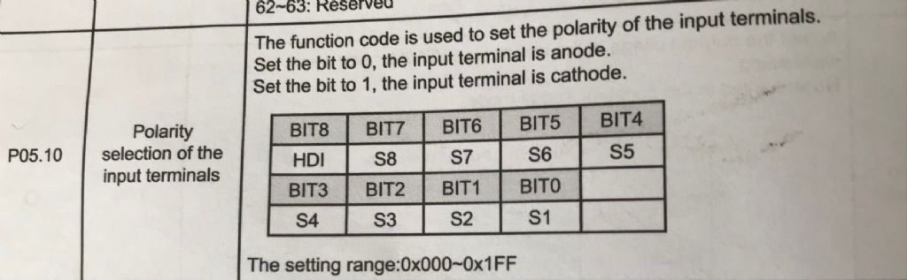

                                                    I assumed it was binary and that a fudge factor had been included in the table, but I just took an educated guess at the value. It reminds me when I was trying to program my inverter and struggled to work it out but got it in the end.
                                                    Basically you have to create a 9 bit binary number and convert it to hexadecimal and enter that into the VFD. in my case I wanted to change the polarity of terminal S4 which is bit number 3 so:-
                                                    Bit number 8 7 6 5 4 3 2 1 0
                                                    Bit setting. 0 0 0 0 0 1 0 0 0
                                                    Convert 0 0 0 0 0 1 0 0 0 to hexadecimal (that’s easy use a converter from the interweb) = 8
                                                    Entered 8 on the VFD, result it works.
                                                    Suppose you wanted to change the polarity of all terminals, the binary number would look like this:- 1 1 1 1 1 1 1 1 1 The hexadecimal is 1FF which is what to enter in the VFD, also hexadecimals are usually prefixed with 0x so it should be written as 0x1FF.
                                                    Edited By Bantam Bill on 28/11/2022 16:03:04
