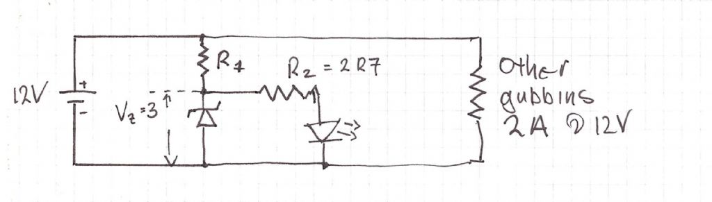

      It's Panto time again – this time I have to make a prop which involves some electrical parts running from 12V DC and also some LED fairy lights which run from a 3V (2xAA) battery pack. It would be good to have a single (12V lead acid) battery and a single switch to run  the whole thing.

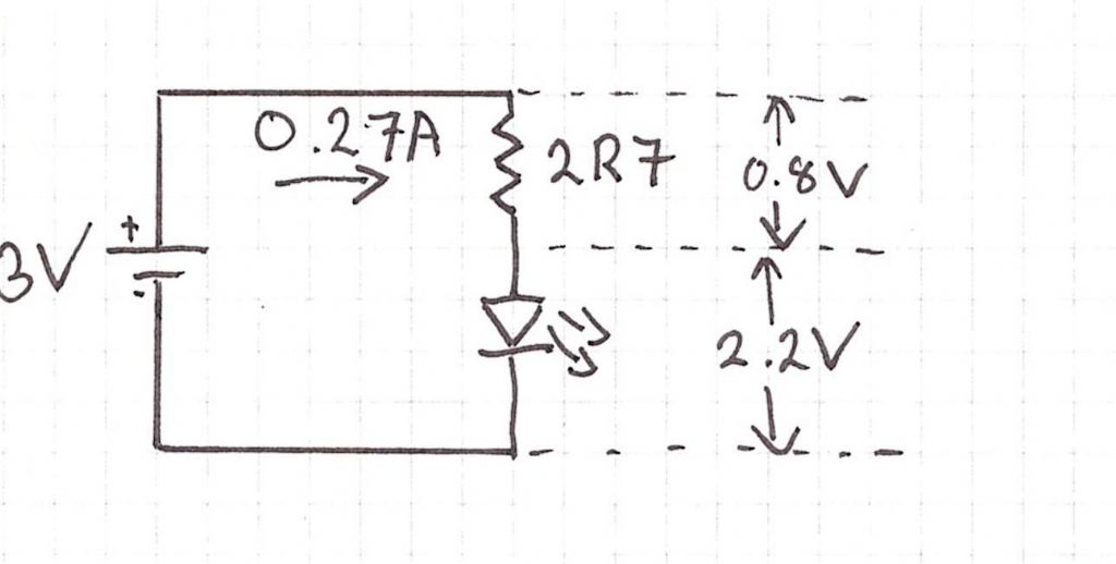

      This is the fairy light circuit:
      OK, the numbers don't work out exactly, just measurements with what I have, but ballpark.
      My first thought was to use a Zener diode to replicate the 3V from the AA batteries:
      but (a) I'm unsure as to how to calculate the value of R1 (b) I'm not sure if I need R2 – it's just there to limit the current through the LEDs, but presumably that could be done by a correct choice of R1? And (c), maybe this is the wrong approach altogether – I'm an ignoramus about this sort of thing. Maybe a simple potential divider would be easier?
      Any advice would be welcome.

          R4 simply has to be sized to carry the LED string current, plus a bit more to set the Zener safely in its operating range, with a nominal 9 volts across it.
          But a fiver or so will get you a DC-DC 12 volt to 3.3 volt step down converter off E-Bay which will be rather more efficient than a resistor and zener set up.
          Or you could use a linear regulator IC such as the venerable LM317 et al.
          Back in the day I did a similar job, albeit 12 to 6 v, using a voltage controlled PWM oscillator, power transistor and decent size capacitors. Stiil have the circuit somewhere. Quite simple but I'll bet its not cost effective against an E-Bay special DC-DC device.

            You want the led running on 12V. The current = 0.27A. Add a second resistor (serie) that has a voltage drop of 9V at 0.27A. That is a resistor of (9 / 0.27) 33R0.
            So you don't need a Zener.
            You could replace the 2R7 resistor by a 39R0

              Is your sketch representative of the inside of the device? – ie, is there only one LED fed from the 2.7ohm R? If so, 270mA is very high for basic single LEDs, even hi-bright types. Max is typically 80mA , and often down to 20mA.
              As LEDs start conducting ( and glowing) , the actual knee voltage of the LED is well defined. A few 10's of mV above that knee and the current through the LED increases dramatically. That knee is typically 2V for red leds, and 3v for green and white leds. I suspects your leds are white? The 2.7ohm resistor may almost just as well not be there – @270mA it drops 0.1v, hardly limiting the led current, and that is why the current is so high. A small variation of the two cells voltage will cause big variations of LED current in this case.
              The better options is as has been suggested, but if it is a single led after the 2.7 ohm resistor, then rather limit the current to maybe 20-30mA – so @ 12V supply, 3v across the led, needs a 270 to 330 ohm resistor.
              If there are leds in parallel, then you need to work is so that there is say 30mA per led and use total current to get the resistor value.
              Led's in parallel are not recommended, some will be brighter that others, but maybe the fairies won't care…

                    I'm with Huub – make R1 (in your sketch) 33 ohms and delete the zener diode.
                    Note that it will be dissipating about 2.5W so will need to be suitably rated (say 5W minimum) and is likely to get warm even so.

                          For this particular application a simple series resistor to limit the current to 270mA.
                          However just for general information there are a number of 2 pin constant current diodes available in at various values of current such as the following offering, that make for simple LED driving ccts.
                          **LINK**
                          Thy can be run in parallel to increase the current drive or at a pinch in series to share power dissipation and increase the voltage range.

                            Thanks for replies. I think that this, for me, is an example of not seeing the wood for the trees. I became focused on the idea of making a 3V source from a 12V battery without thinking about the actual application.
                            It's been educational – I didn't know that DC-DC voltage converters were a thing!
                            I now see that a 33 Ohm resistor in series with the fairy lights will do the job. Boringly!
                            Robin.

                              There is a problem with the simple circuit, which is a risk of catastrophic failure.
                              The circuit is required to feed 2.2V at 0.27A to a fairy light string of parallel LEDs. Fed by a 12V battery, the resistor is calculated to drop 12-2.2 = 9.8V at 0.27A. From Ohms Law R=V/I so R=9.8/0.27 = 36.3ohms. Also, because Watts = VI, the resistor has to be big enough to dissipate at least 9.8V*0.27A = 2.65W
                              The dissipation isn't critical, anything bigger will do : I'd use a 5W type.
                              36 ohms isn't a standard value, so it's tempting to use the nearest resistor which is 33ohms.
                              What could possibly go wrong? What follows is a simplification, see Joe's comments above.
                              1. V=IR, so 0.27A * 33 = 8.2V, putting 3.8V on the LEDs rather than 2.2V, causing them to draw more current and get hotter. Exactly how much hotter depends on the characteristics of the LEDs, but they are all being over-driven.
                              2. How accurate is the 12V battery? A nominally 12V Lead Acid Battery is actually 13.8V when fully charged. If so, the 33ohm resistor only drops 8.2V, putting 5.6V on the LEDs, further over-driving the LEDs and making them even hotter
                              3. Sooner or later one of the over driven LEDs is likely to fail. This reduces the current being drawn through the resistor, causing the voltage on the LEDs to rise again. The extra stress is likely to pop the next weakest, putting yet more volts on the survivors. A chain reaction is likely.
                              The risk would be reduced by using a 39 ohm resistor, but a potential divider circuit is really too simple if any level of reliability is needed. Should be OK for a theatrical production provided the plot doesn't depend on them! Definitely not acceptable in an emergency lighting system.
                              A better answer is a voltage or current regulating circuit, like those already listed. These ensure that a chain of LEDs aren't over-driven by input voltage changes or as a result of LED failures. The switching type are also more efficient, not wasting a couple of watts in the dropper resistor.
                              Most educational this forum. I'd no idea the 'diode' devices identified by Martin existed! They're purpose made for this problem – some rather complicated electronics packaged inside a 2-pin device.
                              In practice, for convenience in a non-critical situation, I'd be inclined use a 39 ohm resistor and make sure the battery is 12V, not 13.8!

                                      Dave’s cct is safer than he thinks as the LEDs are reverse biased as drawn so will not take any current to speak of.
                                      Apart from the somewhat bad practice of running LEDs in parallel which generally means some are brighter than others due to mismatched forward voltages the first parameter of interest is the forward voltage across the string. The OP states this as 2.2V so the current limiting resistor will see 12 – 2.2 = 9.8V
                                      For 270mA we need 36.3 ohms dissipating just under 2.7 watts. A series of 6 6R2 0.6W resistors would fit the bill. In the event of a led failing the forward voltage of the string will remain the same so the available current will be the same albeit shared between one less led. Not likely to cause great harm assuming the LEDs are not being driven to the max current.
                                      However if a lead acid battery is to be used then the above calculations need to be redone with a max terminal voltage of 13.8V The current limiting resistance needs to increase to about 43 ohms
                                      adding an extra 6R2 will do it.
