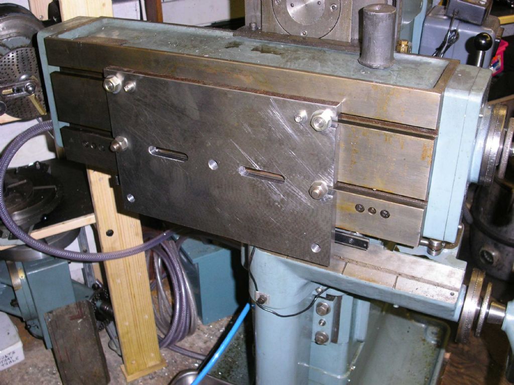

      Does anyone know if a riser block was ever available for these machines?

            There was a riser block made for use with the die grinding head on the Deckel FP1.
            Not 100% certain but I think the Alexander has DP gears and the Deckel has Module gears.
            Good luck with finding one of those !!
            I came up with a different solution when I need more headroom, and that was to make a dropper plate so the table can be attached lower on the vertical axis slide.

              Turning the head sideways is another way to create space on this style of machine.

                  Rotate head 90deg and either mount the work to suit or end milling becomes side milling if that's OK. .
