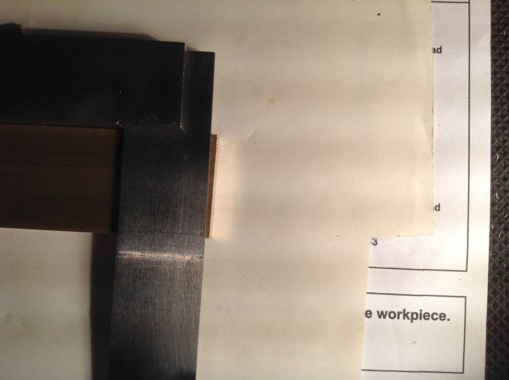

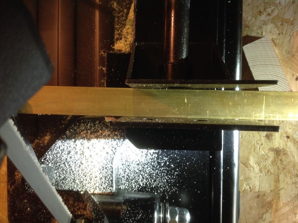

                    I've just taken delivery of mine.
                    Either I'm being very stupid or the saw has problems.
                    First "problem" is that the vice jaws don't meet or clamp parallel. I took the fixed jaw plate off, and tellingly there was a grape-pip sized piece of swarf mashed between the jaw plate and its mount, but unfortunately removing the swarf only improved the problem slightly, it didn't cure it. Short of shimming the fixed jaw (am unwilling to) I can't see a solution.
                    Second problem is that the saw blade leans out, i.e.doesn't come down perpendicular on to the work. The outcome of this can be seen in the image with the square. The brass bar in this case was cut standing on its edge – partly to minimize the ferocious jaw lift when anything under about 1/2 inch thick is clamped in the vice.
                    Any advice would be appreciated.

                      Hi Bill,
                      I think you will find that there has been a fair bit of negative comment on YouTube about the vice provided (and it's poor quality). I intend to use the saw mostly in vertical mode – I'm busy making the stand at the moment. However if I find I do need to use the horizontal cutting stand provided, I'm simply going to change the vice for something more suitable, as I have a suitable one made some years ago. On my power hacksaw, I sometimes have problems holding the stock being cut securely (and the vice on that saw is very well made) and get around it by using packing (to help keep the jaws parallel and/or help grip the work better). I sometimes also have to provide sacrificial support beneath the work to stop it being pushed down.
                      I've not noticed the other problem you mention but as I've only used the saw to rough-size some stock material (before machining it) mine may have a similar (as yet undiscovered) problem. Are you sure it's the blade that's off-kilt – or could it be the stand mechanism? The later may be easier to fix. Are you also sure the work isn't moving?

                        Thanks for your reply, Ian.
                        I'm pretty sure the workpiece isn't moving; I cut half a dozen different pieces of material in succession and all showed exactly the same small degree of unsquareness (as seen in the pic) after cutting.
                        I can't really tell at this stage whether the blade lean is a fault with the blade twisting or is being caused by the support arm/pivot mechanism not holding the saw blade perpendicular to the base. I've tried to remove as much slop as possible in the pivot mechanism by tightening the 19mm domed nut at the pivot point as hard as possible to still allow unhindered pivoting up and down, but it made no difference to the blade lean. If the mechanism is what is causing the lean the only thing I can think of that might cure it is to put packing under one side of the arm's base plate, but I'm not sure how satisfactory a solution this would be.
                        Did you have an alternative idea about a fix for this?

                          I've just put a square on the vice, with the saw blade near the bottom of its travel and the vertical of the square just touching the edge of the saw blade. I raised the saw up until the edge of the blade was level with top of the square – distance betweeen saw blade and square at the top was approx 3/16", whilst being zero at the bottom, hence the angled cuts I am getting. Am still hopeful of a solution before committing to a return.

                                        I disassembled the pivot assembly this morning. Basically it's been machined in such a way that when you snug down the axle bolt with the lock nut it pulls the saw into a slight skew and there is no means of compensating for this I can think of except shimming the base plate or reboring the hole for the axle (straight this time) and putting in a thicker bolt.
                                        I've given up and initiated a return through Aldi, which is a saga in its own right, involving 6 phone calls so far, and we're not done yet. In response to my request for a pre-paid return label (none was included in the package, when it should have been, apparently) they've just unhelpfully emailed me a copy of the delivery note.
