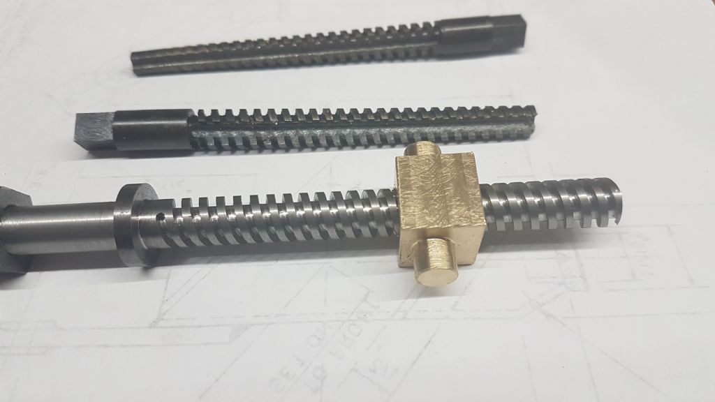

      I made these square thread serial taps:
      to make the nuts for the brake shafts on my traction engines:
      After I'd made them I cut a trial thread in brass which was easy. In contrast the bronze I used for the actual nuts was a total PITA.

        The comparisons of ease of tapping suggest one possible advantage of the reviled standard Myford nuts; better to have to replace a relatively cheap component than the expensive leadscrew?

          Wow, thats impressive! I dont think that grinding HSS to make taps would be an overly easy job.
          Anyway, ive been looking at different taps on the market and they appear to be fairly tapered and long so should in theory make it very simple to cut the thread without a sequential series of taps.

                    Like Andrew I have made my own taps for a 3/8", 2 start square thread, made from silver steel, then hardened and tempered, the thread was milled using a 1/16" cutter rather than done on the lathe as there was no run out to go in to on the part, the taps made with the same set-up. Using the taps in brass was fairly easy, about 1 turn, then remove to clear the swarf.
