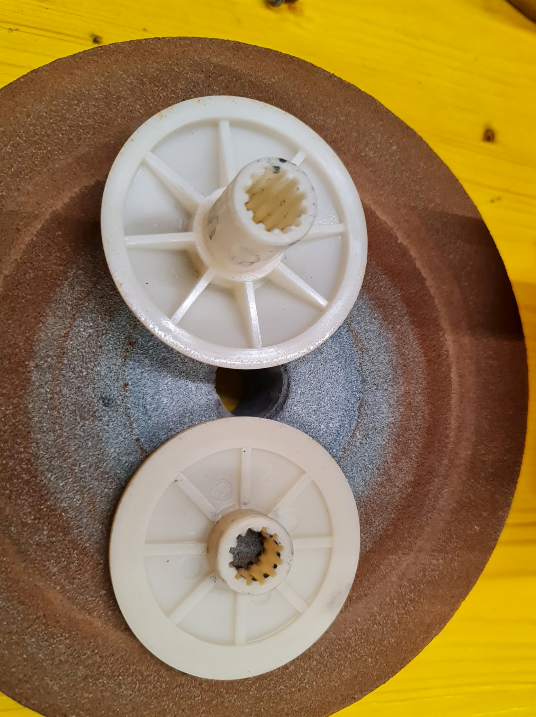

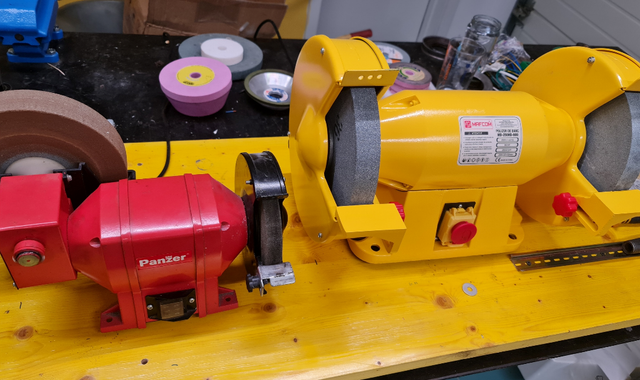

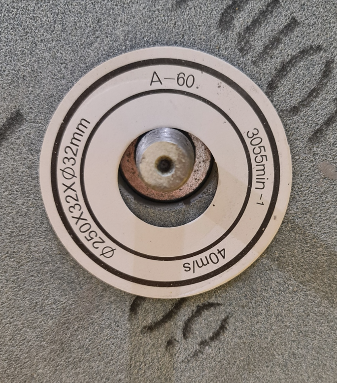

      This is a review of two bench grinders I have. For some reason I regard the grinder as the most unimportant machine in my shop. Because of this the first one I bought was that 30 euro red thing. It has a 250W motor, a 150mm dubious quality grinding wheel on a 12mm axle and wet slow turning wheel that has almost 10mm left to right runout
      The large wheel got glazed after grinding some mild steel. I tried to dress it with a flat diamond tool, like I read in Machining Fundamentals. But I glazed it even more. So now is useless.
      Just check this glorious concentricity:
      I traced the problem to this plastic nuts.

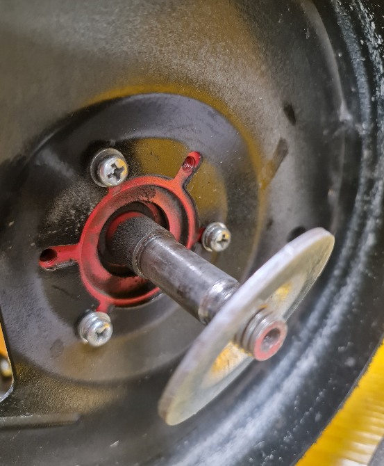

      Another sad thing is the ridiculously small shoulder on its fast spinning axle, ~1.5mm. This is causing severe runout with some wheels.
      Also, recently I purchased a bag of HSS blanks, and I started to make different lathe tools. The 150mm diameter wheel is too small and it created a visible radius on the workpiece. So, I decided to buy a new grinder with a 250mm wheel.
      Since I am cheap when it comes to grinders, I searched again for a low cost one. And I found this no-name yellow grinder that is a good match with my workshop color. It weighs 35kg. Heavy is good. And at two hundred euro it is significantly below other more known brands. There was also the option to buy an old communist 3-phase grinder. The seller warned me that two people cannot lift it from the ground. This only increased my interest. But I had enough fun with restoration projects with my milling machine and I wanted an already working machine.
      The first impression was good. The grinder feels solid and is very heavy. I spined the wheel by hand and I quickly noticed that the right wheel is quite oval. I measured the spindle runout but as you can see it is fine. I added the nut, and it is still not bad. This nut is a better system comparing with the old grinder. So, in the end I blamed the wheel.
      But the horror came when I turned it on. The vibrations are severe. Now I have 35kg of metal jumping on the bench instead of some 8kg before.
      I could try to dress the wheel. But with that dressing tool I was able to fix only a green wheel. That is more friable, and it turned round quite nicely. Or I just throw away the wheel. Anyway, I want to replace it with a white or pink one since I ground HSS most of the time.
      But overall, the grinder is not bad. Whit good wheels it should be fine. The motor itself is quiet. The axle has 18mm instead of the more standard 20mm, but this is not a big deal.

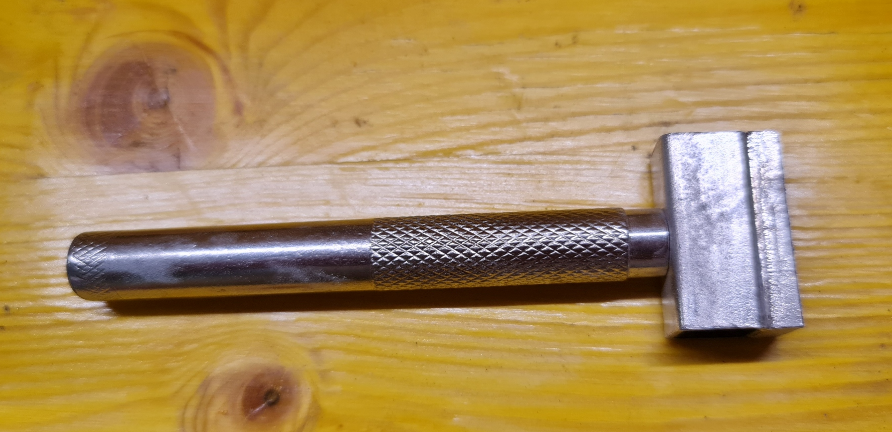

        Dress the wheels with a ‘Huntingdon pattern dresser‘. It will make a lot of mess but will make the wheels circular instead of oval. It will also be useful if you load the wheel up by grinding soft steel or brass etc. and just to keep the wheel ‘sharp’
        The cluster diamonds are good for very fine dressing, but not very good if you want to ‘machine’ the wheel. 🙂
        PS:- the link was just for an example. I am certain that you can find the same thing locally.

          Have you installed the wheels with “blotters” on each side?  If not, please do so before you have an accident.

            Good to know, I’ll look for one here.

            Yes, the wheels have them on both sides. They are a little thin if you asked me, like an A4 sheet of paper. And are smaller in diameter than the large metal washer. So maybe I should replace them

              You said the wheel was oval before you even switched it on. How did you determine that? It is common for the label to be non-concentric on low cost items. If hand rotated check the plastic bore adaptors for slapdash making of fitting.
              The labels you have indicated are not ‘blotters’. Make new. Old fashioned cornflake box used to be good but a lot of modern packaging is way thinner and so hard milled that it has less give than aluminium. Select wisely.
              To evaluate the wheel make a test arbor (not for motor spinning, just measurement) out of plastic or wood that is a good fit and does have a flange. Then you can hold it in a v-block, improvised as necessary, to confirm its shape.
              The 1.5mm shoulder is enough if the washer flange is a correct close fit. If the holes in your supplied washers are punched with a vague or punch-chamfer make new as they won’t fit true.

                They should indeed be thicker and you are right: the raised rim of the washer should be fully supported on the paper.

                Those two grinders seem so poorly made they should not even be allowed to be sold. As made, they are not safe and many of their buyers are likely to lack your machine-tool knowledge, so would not recognise the hazards and try to correct the faults.
                I see one is labelled Panzer – a German word. Like some router-bits I bought of “Erbauer” brand, but whose packing small-print states the truth, I suspect Chinese manufacture given a German name to allege traditionally high German engineering quality. The Chinese can make good stuff but they also know they can sell lots of poorly-made items at correspondingly low prices. Whether those bits, bought from a certain DIY supermarket, will flake out after the first few feet of routing, remains to be seen…..

                  If you find a Huntington type wheel dresser with worn out wheels/discs that’s no problem as new wheels or discs are available and not very expensive. Or just buy the discs and make your own holder. Noel.

                    You can see that the wheel is oval without turning the thing on. See the second video.
                    I ordered exactly that type of wheel dresser. I found it in a shop here in Romania.
                    Panzer is a very common brand here for low cost tools. Together with Stern. Many of their tools are not so bad. But I agreed that my Panzer grinder is bellow any expectation.
                    As for the yellow one, since the axle has no runout I think the other problems could be solved. I remember Blondihacks saying in one of her videos that when you buy a grinder you buy actually a motor, or something like this. The idea is that the original grinding wheels anyway have to be replaced. Maybe for more high end grinders is a different story. But with that dresser maybe I could save the oval wheel.

                      I always dump the pressed steel washers, as they are complete waste of time.
                      The last time I had a cheap bench grinder, £12.50 from Argos, I’d have been better off just going ad buying a good quality one at 10 time the price (though where such a thing is sold, I have no idea).
                      I had to change the washers, pull the whole thing apart and put new bearings in and then put 2 good wheels on….

                        Making new flange washers can transform a cheap grinder; turn them up from mild steel using the pressed steel ones for a pattern.
                        It’s easiest if you have soft jaws for the chuck, if not try and complete the main features at one set-up and take some care to face the back dead-square if you can’t just part it off.
                        When you make the central holes, finish them with a boring tool so they are ‘best-possible-fit’ on the shafts.
                        It sometimes helps to mark the wheels and try turning them say quarter-turns when you first mount them, sometimes with a bit of patience you can find a ‘happy place’ where the (im)balance of each wheel helps cancel out the vibration of the other, worth spending a few minutes experimenting.

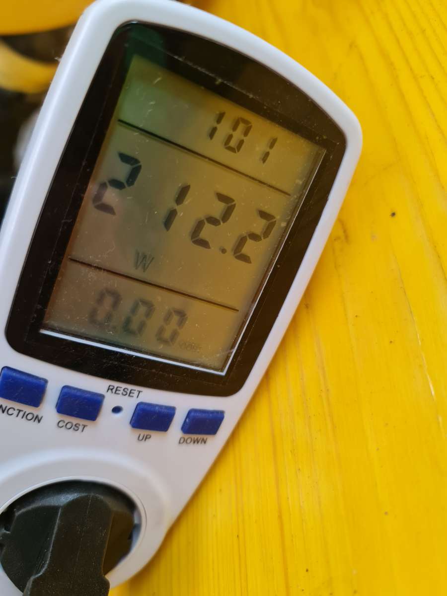

                                      Sonic Escape
                                        @sonicescape38234
                                        Is not easy to measure the power for one grider. This one consumes less than a quarter of its oficial power. But this is when it is idle.
                                          20241005_124238
                                          Agreed!
                                          Motors don’t deliver a constant power output.   Power depends the amount of work the motor is asked to do, which is determined by the load.
                                          Starting a motor briefly consumes a lot of power because the rotor is accelerated hard to get up to speed for several seconds.  Then the motor idles.
                                          An idling motor consumes relatively little power, basically only what’s needed to overcome bearing friction, to turn the impeller, and spin whatever else is connected to the shaft.
                                          When the shaft is loaded, say by pressing an HSS blank into a grinding wheel, the motor has to do real work – cutting metal.   This causes the motor to draw much more power, and because a proportion of this, about 20%,  can’t be converted to work, the motor gets hot.
                                          It’s how hot the motor can get before burning out that determines it’s maximum power output, which is much higher than the rating.  The rating is the sensible power the motor can sustain for some period of time, not necessarily continuously.  Many motors are only rated to operate in bursts 75%, 50%, or 25% of the time because they save money when the work is intermittent, with plenty of time between operations for the motor to cool down.
                                          One difference between hobby and industrial equipment is industrial machines are far more likely to come with a generously rated continuous motor able to take a beating on a 3-shift factory floor.   The hobby equivalent is rated for intermittent use, because hobby workloads are expected to be more genteel.   The hobby motor produces the necessary power, but only in bursts, and the operator must allow it time to cool down.   Ditto the electronics.  Chaps used to industrial machines might burn out a hobby motor.
                                          A naughty sales trick is quote motor input power rather than it’s output.  Due to inefficiencies, input power is about 20% higher than output, making a motor sound better  than it is.   Definitely misleading, especially when the salesman quotes peak input power, the maximum the motor can take for just a few seconds before something melts.
                                          Short of owning a dynamometer, the most meaningful measurement is power input whilst the machine is working normally.   Power output is very roughly 80% of that.
