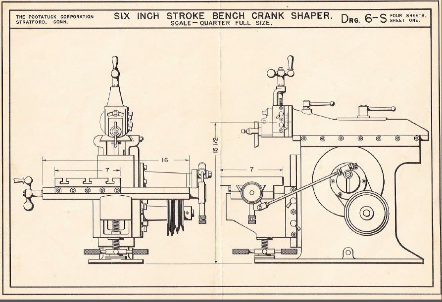

                                              There is a very fine set of shaper drawings (4 pages) Here:
                                              **LINK**
                                              You have to register I had no problems.
                                              A good project for epoxy concrete castings
                                              Regards

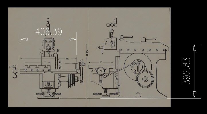

                                                The page has been inserted "Insert menu raster image" as a background. (Just a screen grab from the PDF enlarged to fill the screen) Bigger is better.
                                                Then scaled to fit as metric in Autocad. using the "Scale" command.
                                                Using the table as a reference 16 inches = 406.4mm I got it to within .01 of a mm That L Do!
                                                The z axis not quite as good but within a mm
                                                So the plans were in good condition when they were scanned.
                                                Is anyone interested in building one?
                                                As is? or should we change it….. A Timing belt on the bull wheel maybe.

                                                  Very nicely done, John
                                                  It's way bigger than I have in mind for mine
                                                  But if the plans are that good, they would be easy to scale-down.
