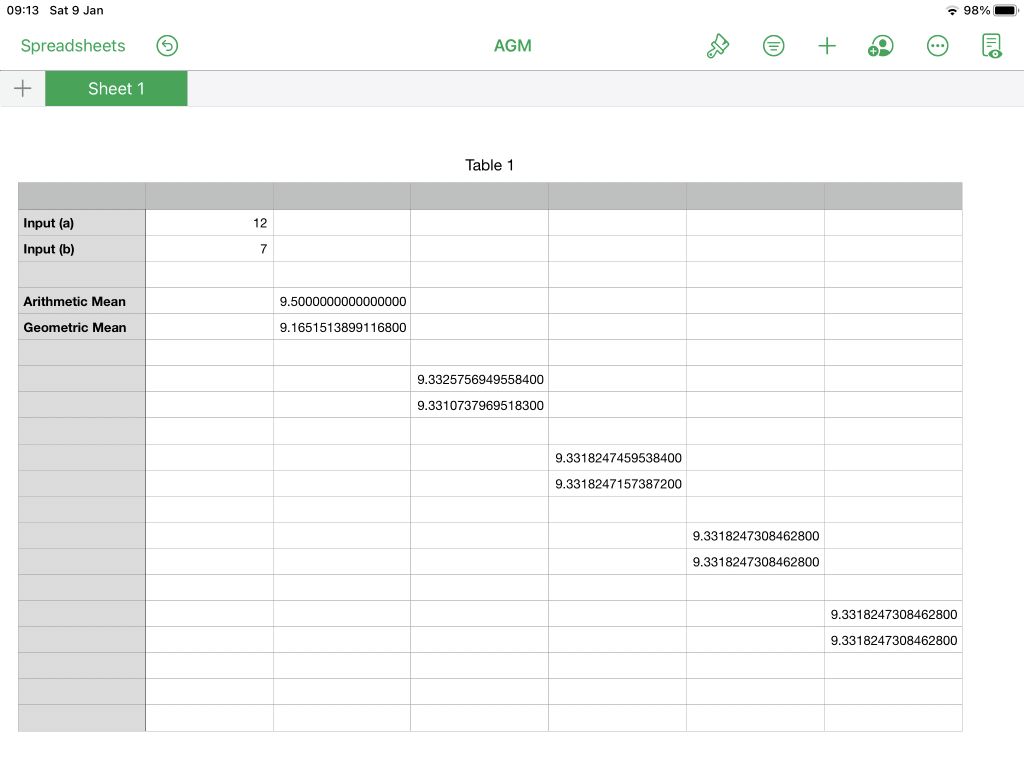

            #518571
              I did a quick check … and he’s right about the Means converging in just a few iterations star
              So this looks like it might be very useful indeed

              #518573
              Martin Connelly
                @martinconnelly55370
                I'm being picky but:
                Even though the formula is exact as soon as you start calculating the mean of a rational and an irrational number it loses this exactness. It is only exact as long as you compute the square roots to an infinite number each time (unless the number is a perfect square to start with). As long as the irrational numbers are truncated it is still an approximation. It may be a good and useable one but perhaps this approximation in the calculation should have been pointed out in the written paper.

                  #518590
                    Very true, Martin …. but this does get us [with very little effort] several orders of magnitude beyond the classic ‘simplified formula’ which only works for small swings.
                    What excites me about it is that it’s accurate [or trivially inaccurate] for large angles.
