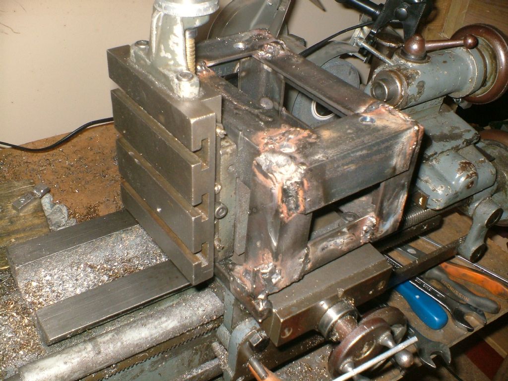

      This started as an acorn and is turning into a major work in progress, I don't like milling btw and have no milling machine aspirations
      but, sometimes we will have no choice in a project sooo…
      Originally I welded some metal onto the bottom to try and improve things but that only highlighted a milling slides inadequacies
      So I ground it off and went for a full wrap
      The only damage to the slide is two 6mm holes in the base and two 8mm holes in the upper part of the back of the slide, no other harm was inflicted and the slide can be removed
      The t-nuts are ski-nuts to make it easier to fit
      All welding was done in situ so the fit is great
      There are holes in the upper body so a hex key can reach down to the bolts
      B+Q fencing provided the angle iron, 30mm mostly
      The bottom swivelling part of the slide has been removed

          So is it any good?
          Well yes and no, it's obviously an improvement but now the vice is moving minutely instead of the slide
          So I'm making a dedicated 4 point vice now, just for the slide, which will take me a while
          All it's really done is move the eternal lathe milling problem somewhere else
          So as I say, it's currently a WIP
          Other points to note at the minit
          The envelope is small, I would guess at 2-3 inches, that myford cross slide extension mod will be essential
          I lost about 15mm in the vertical by removing the base to bring the bottom of the slide hard up against the cross slide with that 12mm bar

            Blimey, that's given the dancing vertical slide a good seeing to. It wouldn't dare get out of step now. Every time I use mine I swear to bolt the bottom of the vertical part directly to the cross slide. Never thought of the full orthopedic frame though. Certainly looks stout!

                Sorry Andy1 but I don't like it .
                To weld in situ can cause stress related movement which can effect more delicate parts .Weld spatter can stick on slides , bad earth can track and trash motor and switches
                Cast iron can and will snap/crack quite easily under stress
                I would make it off the job clean it up and fit to the job.

                  That's OK Eric, I described it badly too
                  There was half a dozen tack welds on the lathe itself then the entire cross slide assembly was removed and taken to my welding and fabricating bit in the garage for the bulk of the work

                    I'm curious why you needed to make this. Traditionally you lock all the slides not in use which usually stiffens everything up.
                        Doesn't really work for many hobby lathes without a lot of effort to sort out tiny unwanted movements which can wreck a workpiece, especially for steel
                        This is an attempt to find a one shot solution to simplify milling on a lathe
