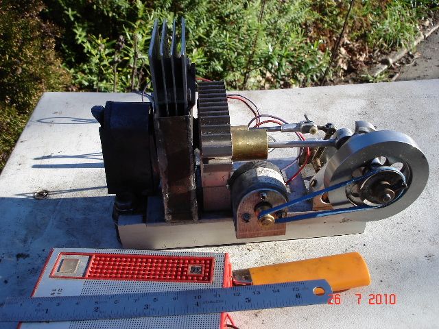

                                      #390832
                                      Ian S C
                                        @iansc
                                        Even a fairly small Stirling Engine will turn over a small DC motor to give enough volts, and current to power a small transistor radio, or light up a few LEDs.
                                        This little motor has a power cylinder bore of 5/8", and a stroke of 1/2". The motor used as a generator came from an old cassette tape recorder. The hot air engine is based on a design by JustenJones and was featured in ME vol 178/4038 P 158. There are two versions of the motor GAMA, and BETTA, my one is the GAMA type which I suspect may have a slight power advantage. This design won the Gnat power competition 1996 (I think).
                                        Ian S C
                                        2.5 cc, and 3volt generator
