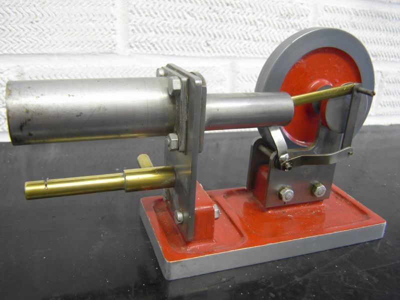

        Good morning,
        I'm in the process of making a Stirling Hot Air Engine. The construction requires a cast flywheel made from "zinc based alloy". Casting for me is out of the question, so I wondered if I might be able to get a billet of said, or similar, material, 90mm dia x 25mm thick. Mild steel is an option, with a bit more machining to bring the mass down, but I'd like to keep the finished engine as true to the plans as I can.

          You could substitute Aluminium instead
          #468033
            ‘Zinc based alloy’ would typically refer to MAZAK or ZAMAK which is used for mass-production die castings.

                Myfordboy on youtube uses ZL12 to cast his flywheels. Its casting temp is about 500C so is not so hard to do casting. Artisan Foundry sell 1KG ingots for £7.99. Maybe near you could cast you a blank.

                        Many old designs expected you to cast your own parts and I'm with Adrian that something like ZL12 would be ideal, think it is only 10% lighter than cast iron. Myfordboy does do one off castings for people so you could contact him for a casting or just a simple cast disc.
                        Steel would be OK and probably a lot less hassle.

                                Michael, you missed the words "construction requires a cast flywheel made from "zinc based alloy"
                                As the OP says he can't do the casting he wants to cut from solid in a similar material hency the search for a billet of same.

                                                  Probably not in this case, the low melting point of alloys such as ZL12 made them easy to cast with the smaller school furnaces or even in a ladle with a big brazing torch and as teh OP wants to keep it looking as close to the one he previously made the colour of brass would also be wrong on the usually unpainted rim.
                                                  Should look like this

                                                      I suppose the point of specifying Zinc Alloy like Zamak, or as my Dad called it 'Sh1t Metal', is its easy to melt and cast – no problem at all in a school metalwork class and very educational. Car door handles used to be made of it, and an ordinary blowlamp could melt them in a steel saucepan.
                                                      For a flywheel, almost anything roughly the right size and weight will do. My few examples were machined from a 150mm dia Aluminium rod or turned from a Cast-iron block cut to an octagon with an angle-grinder.
