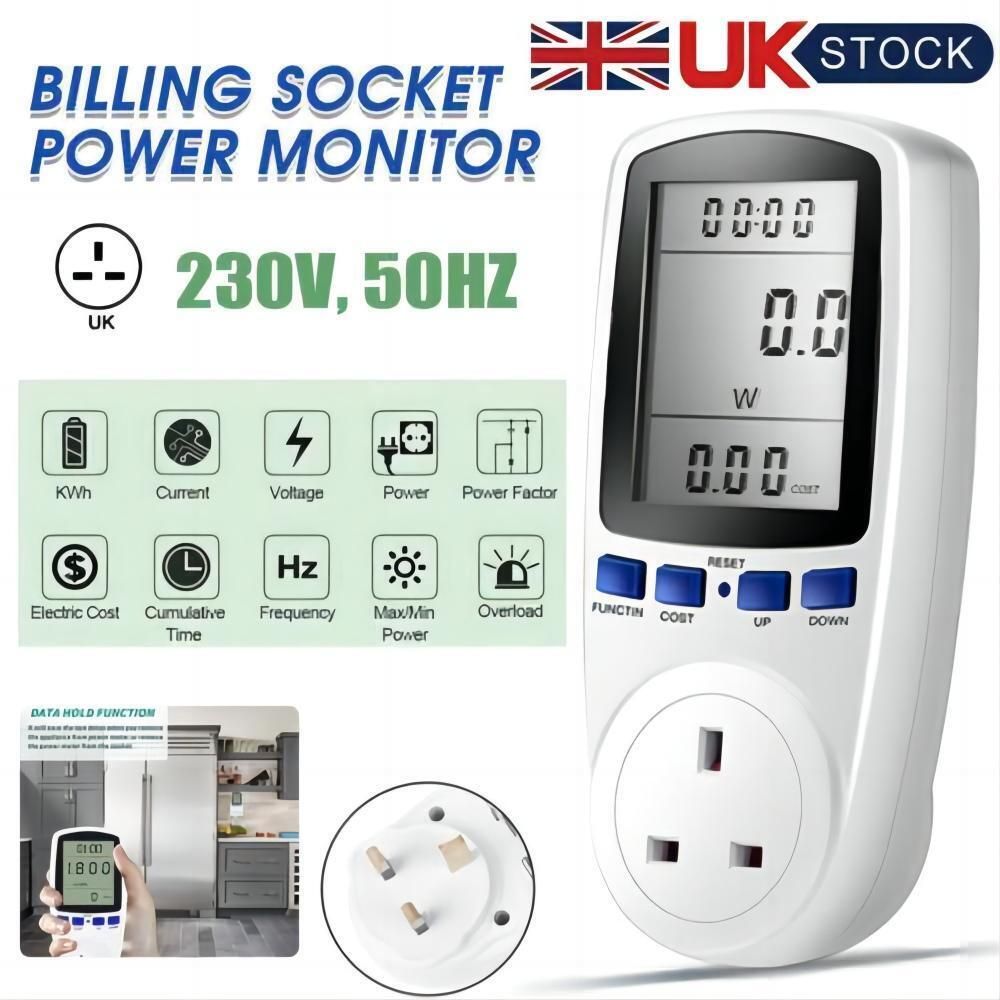

                                        The Owl meter in that madmodder thread looks very similar to an old Efergy unit that I have and no longer use.
                                        I discovered it misread inductive loads badly and claimed my kitchen hob was using 200W on standby,
                                        Could a similar thing be happening with the ballasts/chokes in the tube fittings?
                                        The "now" function on my (dreaded) smart meter appears much more reliable.

                                            I suspect the measurement too! Be good to see a circuit showing how the LED tube was connected relative to an unremoved LC ballast. Even if connected, it's difficult to imagine how a ballast could consume more power than a LED lamp. Maybe rewiring connected the ballast directly across L and N? Seems unlikely.
                                            Maybe the answer lies in the nature of the ballast. It's an inductor and capacitor in series, not a resistor, and reactors do not behave like resistors when AC current passes through them. Where it not for the ohmic resistance in the copper coil, the inductor would be lossless, and the capacitor is near lossless too. Reactors work by charging and discharging efficiently, and as energy in is very nearly energy out, the loss in a well-made device is usually tiny. For example, power transformers are about 99% efficient.
                                            I suspect the measurement. In the scientific sense power is the rate of doing work, energy transferred per second, and power is measured in Watts. In a DC system, Watts are simply volts times amps, because the two are always in phase. Not so in an AC circuit with inductors and capacitors. Being reactive these shift the phase of the voltage relative to the current, so simply multiplying AC Volts and Amps doesn't give Power. The unit being measured is a Volt-Amp, which is 'apparent power', not 'real power'. To convert Volt-Amps to Watts, it's necessary to correct the measurement for phase difference. The maths is more complicated.
                                            The purpose of a ballast is to limit and stabilise the current flowing in a lit fluorescent tube, and they're unlikely to waste much power, certainly not nearly 60W per lamp. The acid test would be to measure the temperature of the ballast components, because they'd be cooking hot if they were really consuming 60W! As far as I can see that test, or smoke, isn't mentioned on madmodder, so my money is on Volt-Amp confusion.
                                            Do sparkies cover inductive and capacitive weirdness? Electrical and Radio Engineers do up the ying-yang, but maybe this part of AC theory isn't useful to the chaps who do the hard work. Wiring up and installing is another skill set.
                                            So, yes the ballast will waste some real power, but the amount should be tiny. I think the meter measured apparent power, VA, and the confusion is due not converting VA to Watts with the right maths.

                                              I had thought I understood some of this but clearly I don't understand enough. Can anyone suggest what type of "wattmeter" I could get which would read "real "watts on AC mains circuits. I don't need an expensive professional standard thing just something to give me an idea of consumption.
                                              Thanks
                                              Rod

                                                      Posted by Rod Renshaw on 23/05/2023 19:15:14:
                                                      Thanks
                                                      Rod
                                                      One where the blurb mentions reactive loads or Power Factor measurement.
                                                      I don't think all socket-type wattmeters do Power Factor, but the electronics aren't expensive. This example on ebay is £7.99:
                                                      Don't expect a precision lab watt-meter, but should be good enough for domestic work.
