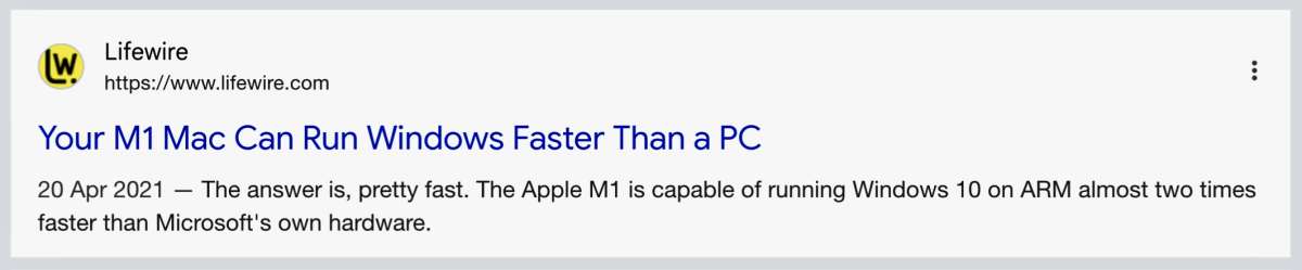

                                                  Apple. I used both Apple and PC’s at work but did most of my work on a Mac. While I was there a number of people switched to buying a Mac for home use and there was a universal statement I heard from all of them after a few weeks, “I will never, ever go back to using Windows again”. More software for Mac than Linux but if it’s niche software then vendors may not offer a Mac version. Having said that you can run Windows on a Mac with software if needed. I don’t know about the current situation, Macs now have M4 chips.
                                                  IMG_3713
