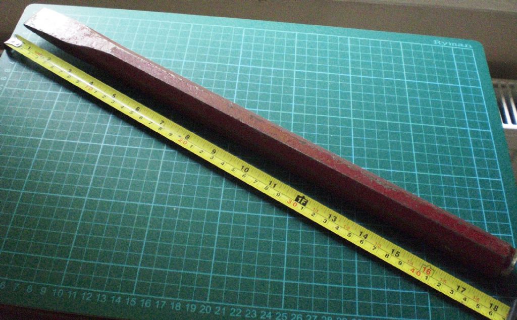

                        Hi Mike Poole, I don't know what length you consider as long commercial cold chisels are, but I have this 18" x 1" octagonal cast steel one manufactured to BS3066 and has had plenty of heavy thrashing with a 4 lb lump hammer and has shown no sign on bending. This is the second one of these that I've had and the first one had loads more thrashing without bending, but that one got nicked when the firm I was working for had a break in. However I do agree that a long slender one like Chris wants won't stand up to a lot of hammering and only the cutting end should need heat treating.
                        Regards Nick.
                        Edited By Nicholas Farr on 23/07/2022 09:25:00

                          Hi Nick, you could probably pound that all day with a 14lb sledgehammer without a problem, the chisel I had in mind was about 2ft long and 1/2 diameter, it was my grandfather’s who was a plumber by trade. Faced with some concrete chiselling for some new fence posts I bought a Screwfix cheapy SDS drill/ breaker, it did the job in style and if it never comes out of it’s box again it was worth every penny. Cast steel used to be the material of choice for cold chisels and was what my apprentice made chisel was made from, CrV seems to have become popular nowadays.
                          Mike
