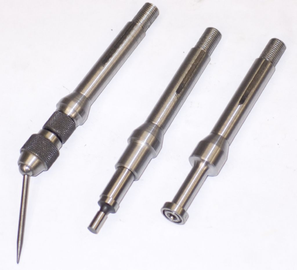

                                          I have all of the above including a Haimer, but my go to tool is one I made myself.
                                          It is a small ball race loctitied to the end of a plain shank, with it spinning in the spindle I approach the work until the outer part of the ball race stops spinning due to the contact friction.
                                          I get repeatability as good as a split cylinder edge finder, the Haimer is very good, but takes up too much headroom for most jobs and will not fit my Boley jig borer anyway.
                                          I have a selection of home made ball race types with different shank diameters that will fit whichever collet happens to be in the spindle at the time. Plus some dedicated ones for the Boley that fit directly into the spindle as shown below.

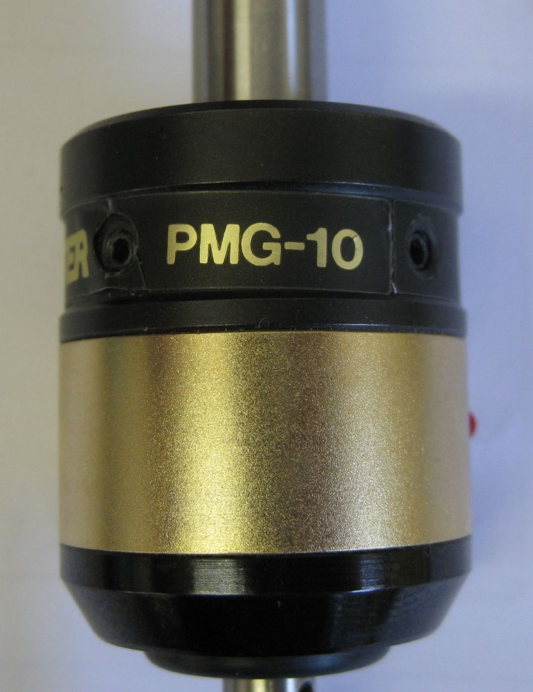

                                                      I hope this is not to far of topic…
                                                      I have one of these edge finders –
                                                      It has always worked very well, very repeatable and easily set for zero run out. It has a small really oddball battery that fits inside its shaft. However..it no longer works – It relies on electrical contact between shaft and ball tip ( through the machine itself) and then the LED comes on – but the led no longer comes on..
                                                      I HAVE checked the battery, tried a new one, looked down the shaft battery hole with slim video camera, cleaned battery contacts, etc…Something has come adrift inside, or the LED has failed…Does anyone know how to open one of the things? I have tried unscrewing the body – there does not seem to be any unscrew witness marks, etc. The 4 grubscrews are to set the ball tip run out only. I did peal off the label strip – no screws hidden under..
                                                      I have emailed the company ( Japan) about 10 days ago, but…
