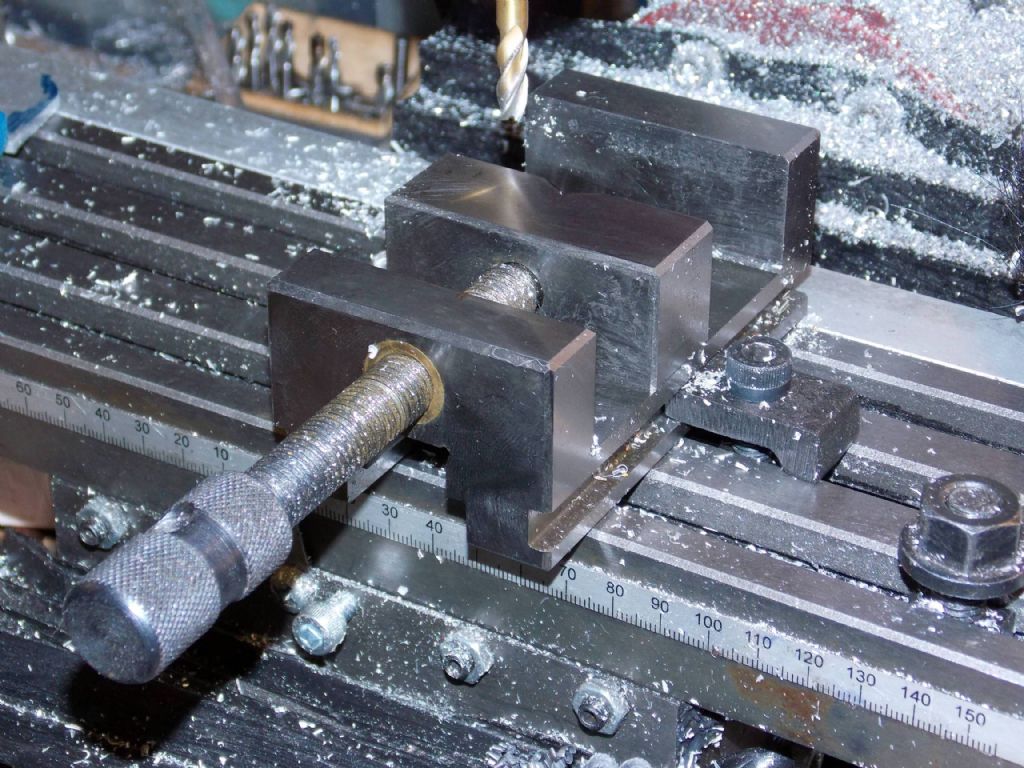

                                                Sub Mandrel
                                                  @submandrel
                                                  I paid £15 for a small SOBA 'precision vice' and ended up having to true up the jaws.
                                                  In contrast this one (I've only started using it recently) seems to be as accurate as I can measure, is very rigid and the finish is amazing (it looks like a mirror finish but is actually very finely ground).
                                                  Note the bronze insert for the clamp screw
                                                  My brother bought it for me for about £22 from Proops at MMEX a few years ago.
                                                  Well, at least you can't accuse me of being one of those people who never makes any swarf…
                                                  Edited By Stub Mandrel on 28/01/2013 20:19:48
