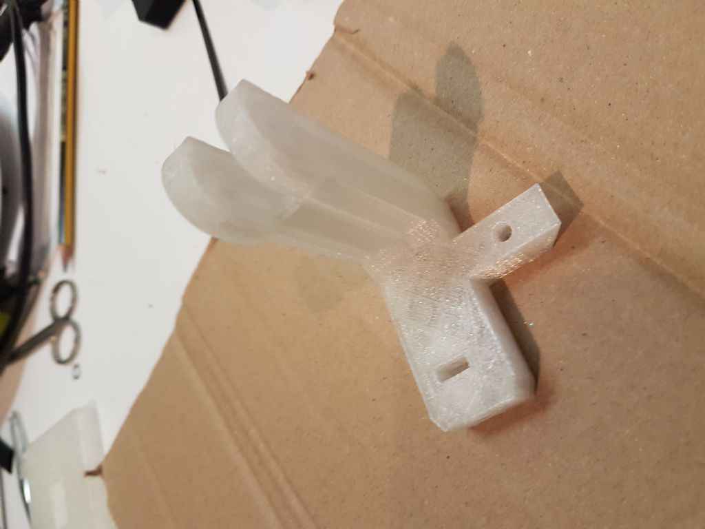

              Posted by Mark Simpson 1 on 22/12/2017 15:28:22:
              By coincidence, here's my first print from my new factory 3d Printer…
              Looking good (so far!)
              Is that the new quick release holder for the MK8 hotend?
              Could you post some pics from the side, I think I want to print myself one!
              Y-idler tension screw is a sensible addition too.

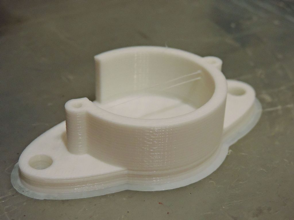

                Posted by Colin LLoyd on 22/12/2017 16:47:17:
                The apparent "brim" around the outside of the wall is actually part of the pickup cover allowing the two items (pickup and pickup cover) to be joined to the pickguard. On the question of PVA – do you just use any DIY PVA from the likes of B&Q or some specialist "fine" PVA as sold as paper and cardboard glue by Smiths? Also what dilution do you use?
                Yep, realise that, the Cura brim goes around the whole perimeter, inside and out. I'll post a pic in a bit when the stepper mount I'm printing is a bit taller.
                I use super-cheap PVA from Hobbycraft, diluted 50/50. Just make sure it's 'washable' not waterproof!

                  #333473
                    Here we go, this is a brim, it looks chunky but the brim is the thickness of a couple of sheets of paper.
                    Actually, that's a good test of Z-height and levelling, start a sizeable print and stop it after one layer. If you can peel off a flexible sheet with no holes or splits and reasonably consistent thickness, then your machine is well set up.

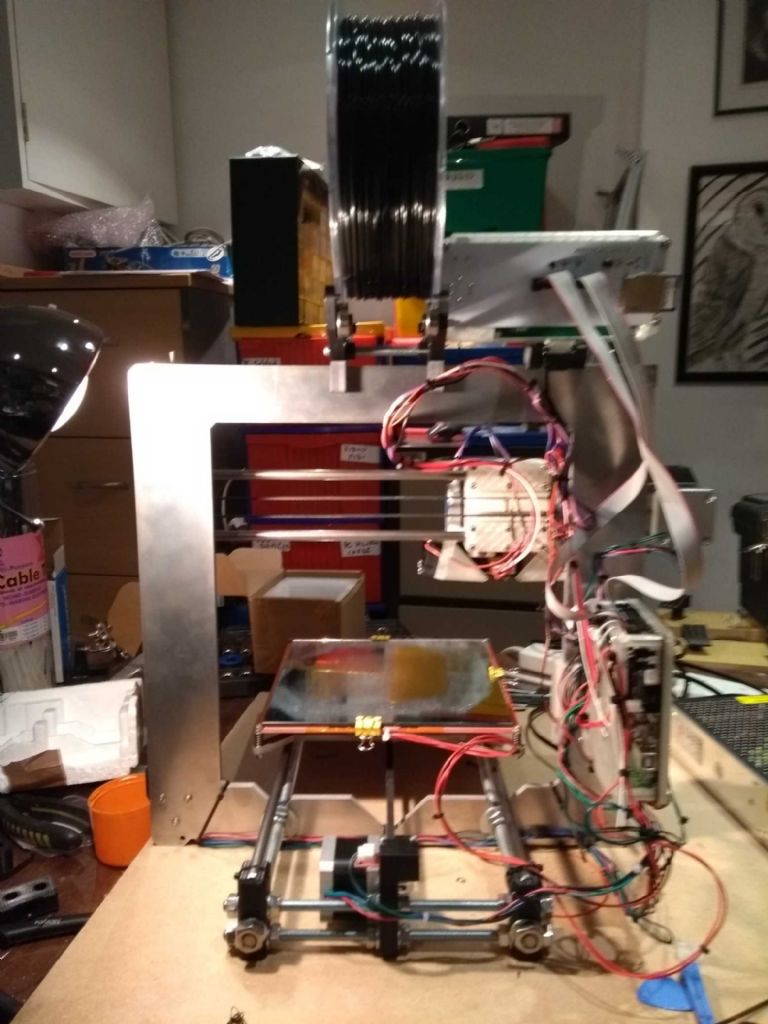

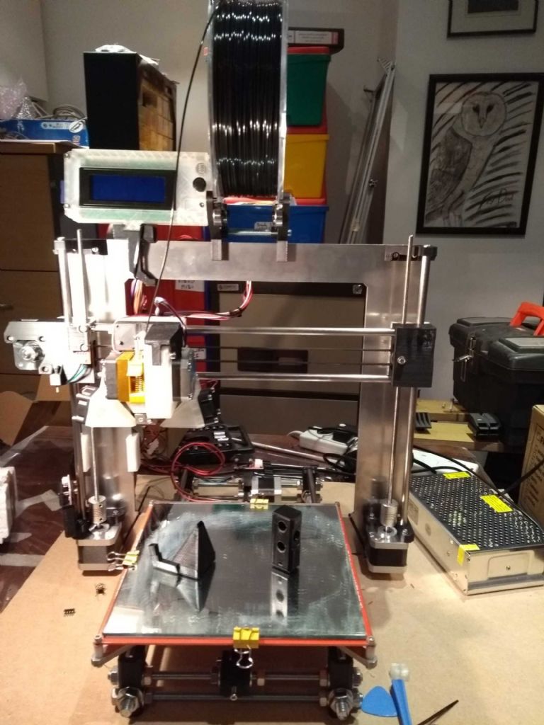

                    Iain Downs
                      @iaindowns78295
                      End of today and the machine isn't far off. Just got to put the Head bits on and the electronics.
                      Apart from the general Y axis setup, the hardest thing so far is getting the little washers in the idlers. tweezers and a deep breath managed it in the end.

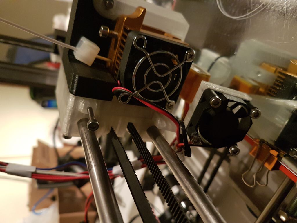

                      Mark Simpson 1
                        @marksimpson1
                        Neil.
                        "Is that the new quick release holder for the MK8 hotend?
                        Y-idler tension screw is a sensible addition too"
                        3 extra photos in my 3d printing album, let me know if you want dimensions
                        There is a square socket at the bottom for a captive square M4 nut

                                      Ian Skeldon 2
                                        @ianskeldon2
                                        Posted by Neil Wyatt on 22/12/2017 21:02:08:
                                        What are the two lines running across the internal diameter Neil?

                                          Posted by Mark Simpson 1 on 23/12/2017 10:24:53:
                                          Neil.
                                          Thanks Mark – but I was meaning the whole assembly – I assume it uses a different back plate as well?
                                          #333681
                                            Posted by Ian Skeldon 2 on 23/12/2017 20:45:03:
                                            Just stringing. I pretty much have the retraction settings dialled but occasionally a particular shape will cause one to form.

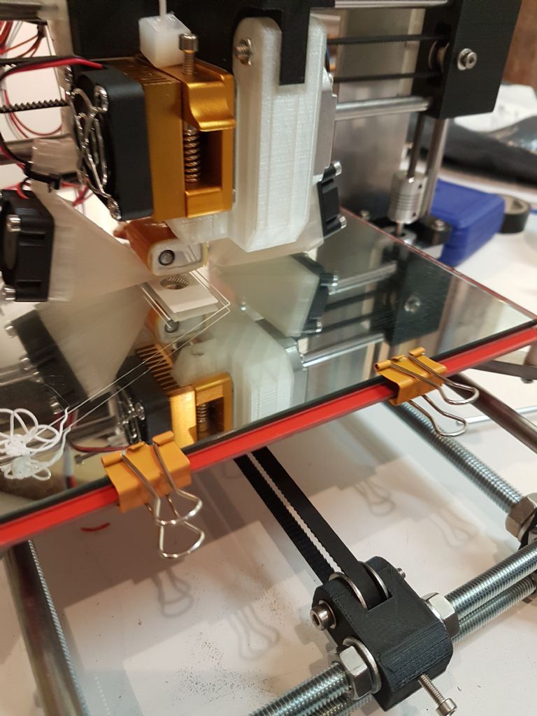

                                                  Mark Simpson 1
                                                    @marksimpson1
                                                    Posted by Neil Wyatt on 23/12/2017 22:47:27:
                                                    Neil.
                                                    More photos in my 3d printing Album of the parts… I guess the backplate with the bushes is probably the same, then through bolted to that is a piece with two dovetails for the build fans, and the same bolts carry on to the "black in my case" overarm support.
                                                    The only bit of the whole thing I don't like are the supports for the build fans… They flex with the acceleration of the print head and on the second print caught on the printed part and one tore off. So I added a bit of 1/8" gas welding wire right through and a blob of araldite and no further problems….I will improve this properly with new cowl after talking to Mike at factory3D following his Christmas break…. Mine was the first MK2 kit to go out so if that's the only problem I am impressed.
                                                    Not really found the right way to tidy up the wiring yet, I'm sure I will work it out but no tidy solutions are obvious to me yet.

                                                    Iain Downs
                                                      @iaindowns78295
                                                      Hey, Mark.
                                                      I appear to have been one of Mike's other guinea pigs for this new build.
                                                      I too had trouble with the build fans. the wedge mount snapped off on one of them with little provocation and again on an early print. Superglue has come to the rescue both times, though I'm not sure I expect the repair to keep working. I've printed another mount for when that fails.
                                                      I had some issues with the electrics. the plugs don't really match the sockets and my last build issue turned out to be a bad contact on the Y motor.
                                                      I've managed to sort of tidy up the wiring with profligate use of cable ties, but I agree that it's not the nicest part of the kit. Nor did I entirely like the electronics box.
                                                      Throughout this (and most noticeably even over Xmas) MIke has been on hand with advice and support and appears to be taking all feedback very seriously.
                                                      I'm happy with my new machine, though I've still to find something I can make which will please her indoors. I have some ideas, but let's see.
                                                      Now for the struggles with the design and slicing software. Keeps you young (ish)…
