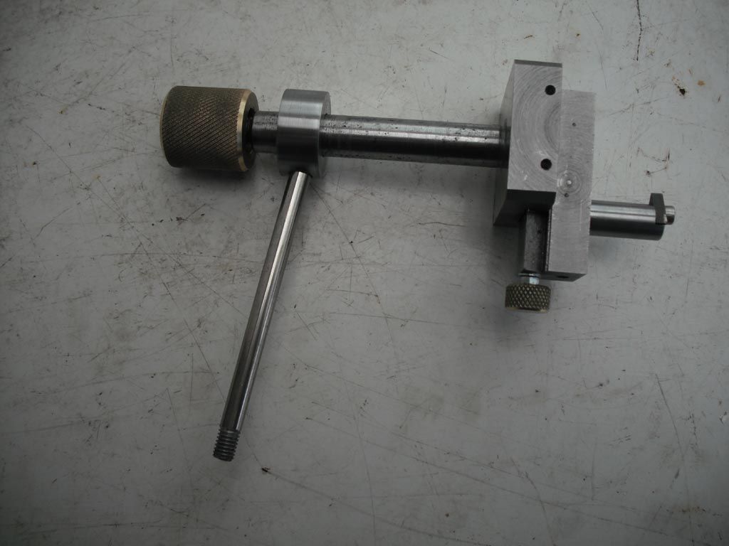

      I'm making the ball turner published in MEW, autumn 2017. Now gone as far as I can. I'm waiting for delivery of some 50 x 50 mm cast for the mounting block, which replaces the 4 way toolpost when fitted to the lathe.
      I had some problems on the way. Didn't have a suitable piece of flat steel for the top part of the dovetail, so I cut off a piece of 25mm bar and found a piece of 16mm x19mm rectangular bar inside.25mm_bar.jpg
      The dove tail assembly was a bit of a loose fit, so working on the principal of "if you can't make it accurate, make it adjustable", I machined a bit more off and fitted a gib strip. It's now a nice snug fit.

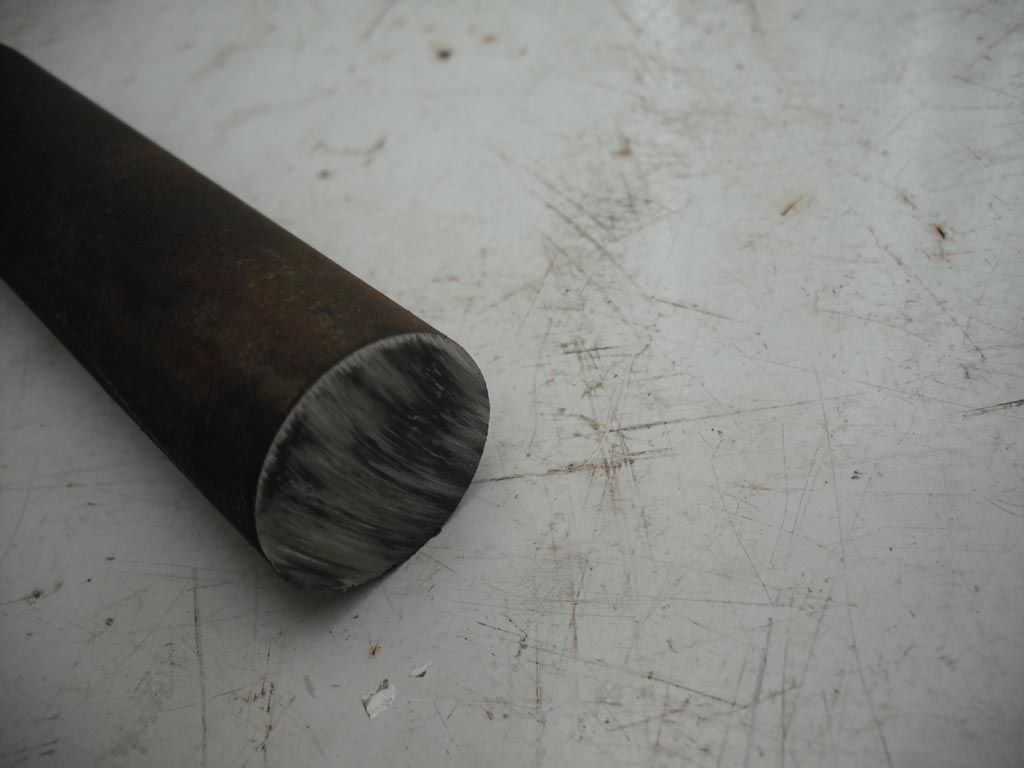

            It's made me think carefully about the metal I have in stock. I've always used 'new-to-me' materials, but am presently using some steel that even I might otherwise scrap as it's so corroded.
            It's a matter of cutting and machining the less affected metal to lose the worst pitting, and leave the remaining surfaces where it won't matter too much, and will be painted. Obviously those pitted surfaces are not on model components that will be visible so have to look right. Nor heavily-loaded, unless the steel is sufficiently over-size for cutting all surfaces below the corrosion. If loaded, I assess how it is loaded, and whether the weathering has weakened it too much for the application.
            This is to leave my precious, non-precious metals in decent condition, for where original size and good surface condition are important.

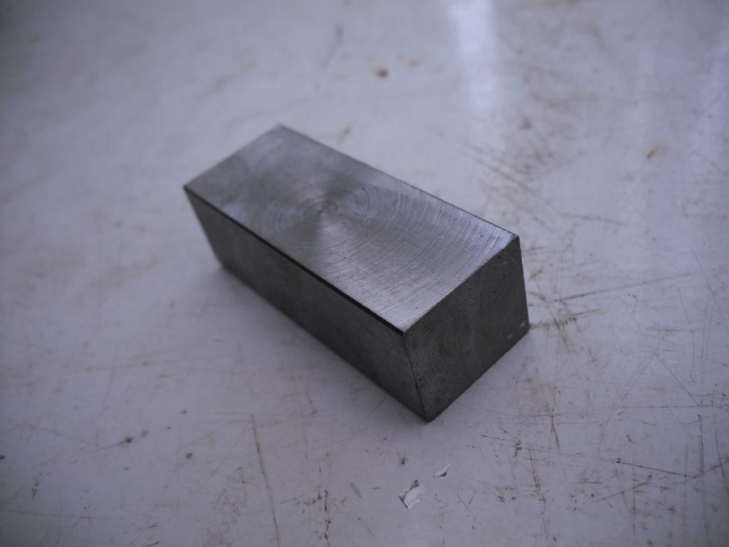

                                    compleated 5"*3"*2" block of cast steel on my horizontal small stub miller using a fly cutter with HSsteel tool.It cut the 3" side in one go with shallow cuts and slow feeds and several passes.Milled all round and I was more than a bit pleased at the results as the length was only 1to 2 th out.the ends were spot on and it is square all round.You might think why am I so pleased at this.I bought this miller that had been cleverly converted to a vertical mill by sawing off the bearing housings and planing level and building up with steel blocks bolted to the reduced housings and forming the vertical head on top.I dismantled this down to the reduced housings and formed them as near as possible to the originals as was possible.I have the original cut offs.To be able to fit these new housings I had to make them elongated to allow a fixing below the new ballraced spindle into the holes tapped for the previously alteration through the new oil hole.I made four pulleys with mullty v so they looked like the original flat belt.I used a laser to line up the spindle positions on the blank housings,bored the holes and fitted the new 2morse spindle I made.So you can see this could have been a right cock up.It turned out well.

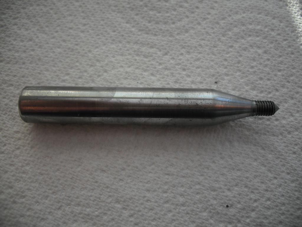

                                              Apart from sorting out my mitre saw, I've made a mandrel to use with the ball turner I'm making. I will be held in a 14mm ER collet when used. I'm waiting for a delivery of metal to make the mounting block for the ball turner and am a bit disappointed, as it was promised for today. Under the present circumstances, I don't suppose I can complain.

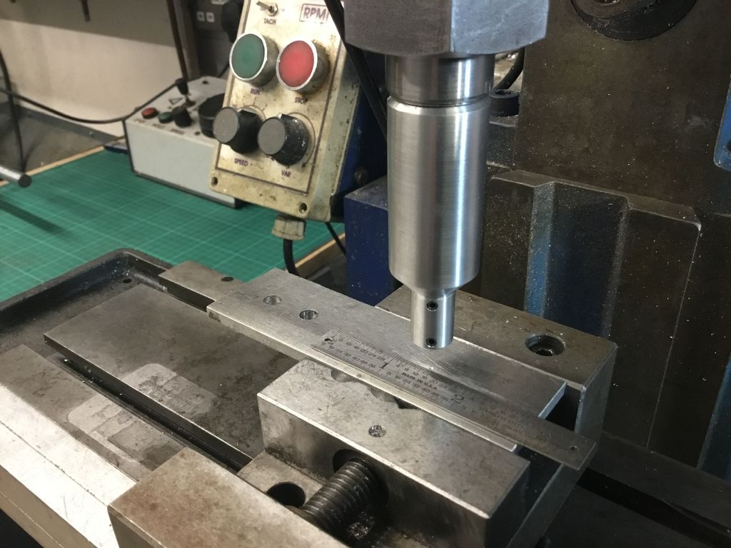

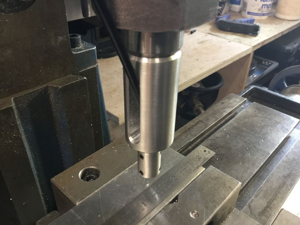

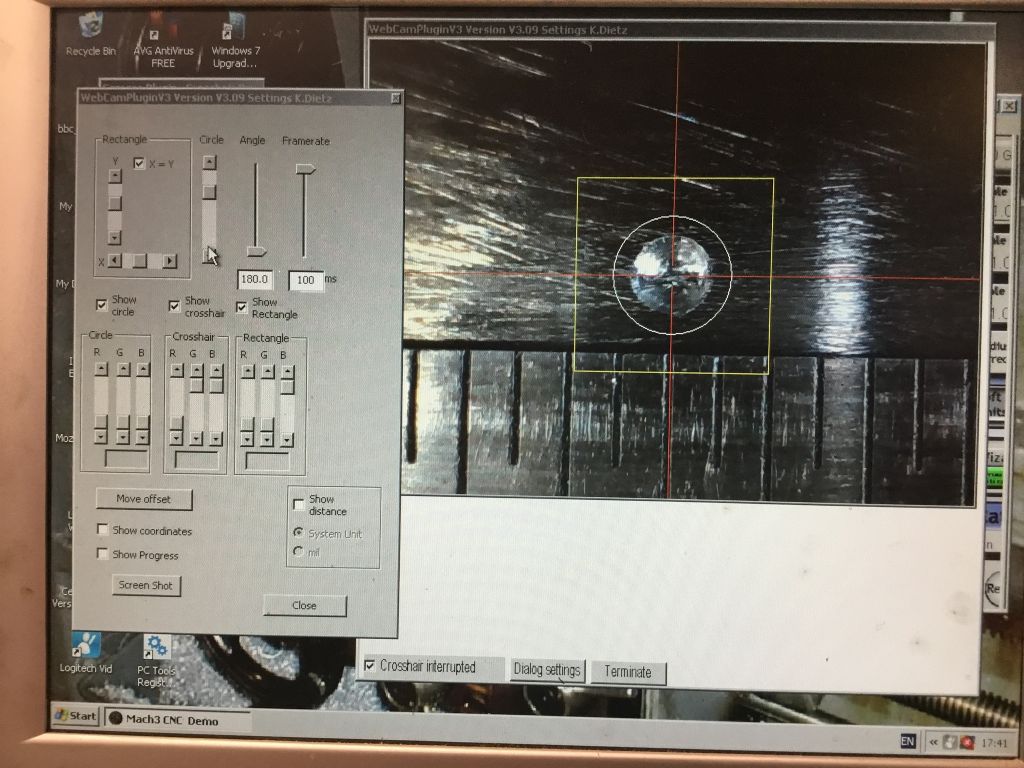

                                                    I've been using a USB 'Centrecam' with software by Mike Tretheway for some years now and it's been invaluable but unsupported for some time. Unfortunately it failed recently and having faffed around trying to fix it I decided it was time for a rethink.
                                                    I was given, as an xmas present, a rifle borescope, 5.5mm dia with built in leds so decided to see if I could adapt it to replace the Centrecam.
                                                    Ally housing machined up with M3 adjustment screws and fitted to original MT2 taper.
                                                    New centrecam
                                                    New centrecam 2
                                                    Screenshot  2
                                                    Downloaded and installed demo Mach 3 software and camera plug in LINK
                                                    Very pleased with the results – much smaller and easier to align with the centre of the quill and added bonus of a microscope able to look at the state of tool tips as shown surprise
