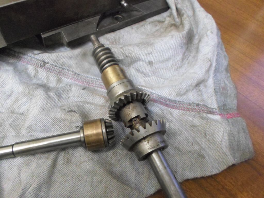

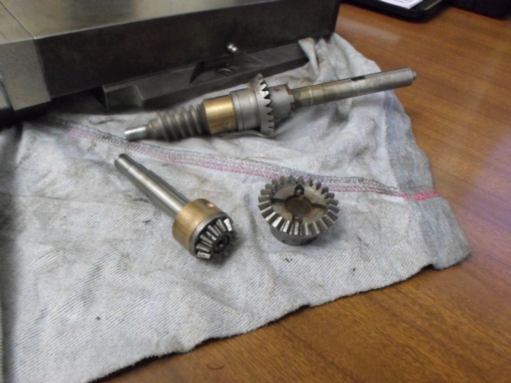

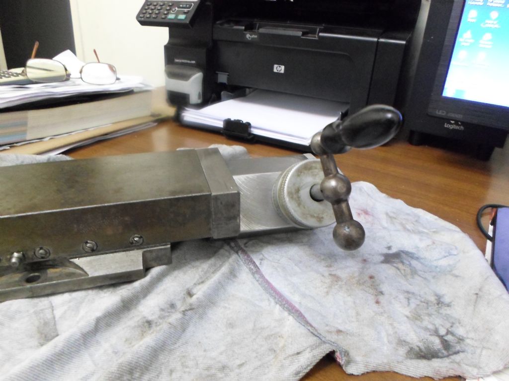

                                            Mikelkie
                                              @mikelkie
                                              I wanted to make some small taper pins, but the close proximity of the tail stock holding the work with a live centre makes it impossible to turn the top slide smoothly so i came up with this. (perhaps someone did this before?) The parts are all from redundend  Bridgeport quill feed gears
                                              Edited By Mikelkie on 13/11/2017 20:47:50
                                              #327015
                                              Mikelkie
                                                @mikelkie
                                                Angle drive
                                                #327016
                                                Mikelkie
                                                  @mikelkie
                                                  Angle drive
                                                  #327017
                                                  Mikelkie
                                                    @mikelkie
                                                    Angle drive
                                                    #327023
                                                      Nice one Mike. That too would make a neat article for MEW.
