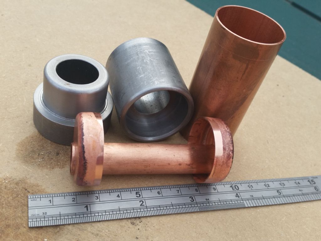

                        Today (well, over the whole weekend, starting Friday evening really) I have made a start on my little Cracker (32mm gauge oscillating live steam locomotive). I have turned a couple of bits of steel into formers for little boiler ends. I have annealed and pressed some copper into said ends, trimmed and cleaned them up, and drilled/bored an off-centre flue hole in each using a very dodgy mdf faceplate setup. I have also made my first posting in this thread… I am underway!
                        #184182
                          Nice looking endcaps, you are off to a good start.
                          I'll take the liberty of posting one of your photos here to save others going looking (More pics in Steven's album)
                          #184183
                          Steven Greenhough
                            @stevengreenhough56335
                            Thanks Jason. I’ve had a few goes at odd bits and bobs but mostly just mucking about witb the lathe to get a feel for it. If anyone does go looking at my album, be warned. I did not get a faceplate with my lathe and (at best “improvised,) set up is not at all pretty…

                              Steven
                              No need for the warning! Improvisation is at the heart of model engineering – be it for lack of the "correct" equipment or "correct " accessory. That you are able to achieve the desired result is what matters – with the proviso that you are able to do so safely. What you do have as a "hobby" ( obsession?) engineer is time. Looks to me that your method works!
                              Good luck!

                                Thanks Norman… The boiler ends are very light (1mm copper, 33mm dia (about 1.5 inches?)). I wouldn’t have used the same setup for anything heavier. I just figured as long as I went slow and kept my fingers out of the way the worst that could happen would be a chewed up piece of copper. So I went slow and nibbled away at it.

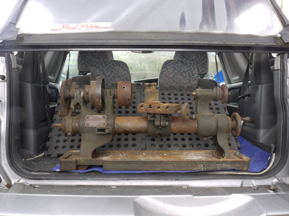

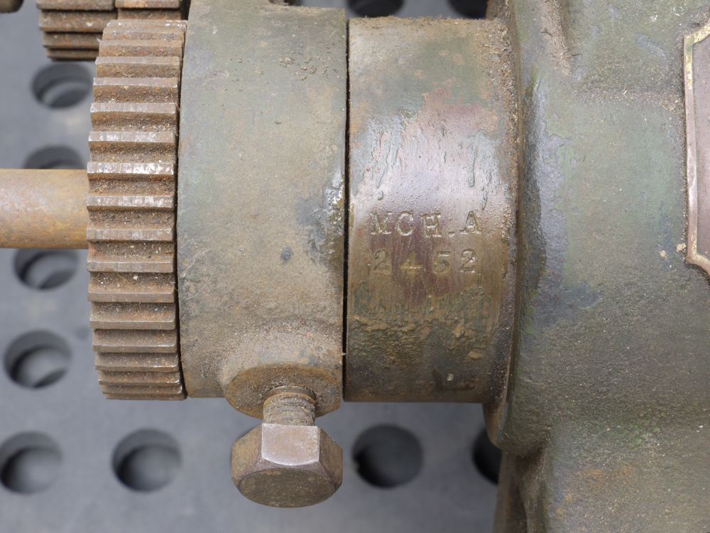

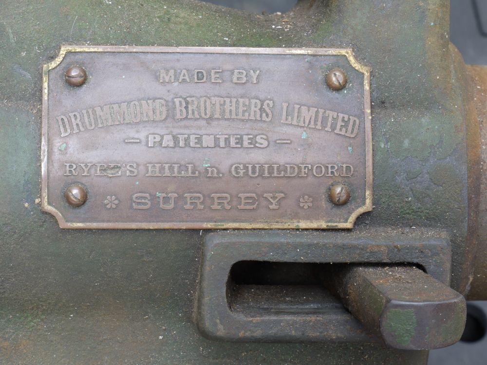

                                    Posted by Michael Gilligan on 18/03/2015 12:56:47:
                                    … Acquired yet another restoration project:
                                    An early model Drummond Round Bed lathe
                                    and today, I finally got around to removing it from 'The Skip' [as the old Suzuki GV2000 is affectionately known] and into the workshop.
                                    the lathe seems to be in remarkably good condition for its age, and I think it should 'scrub-up nicely'

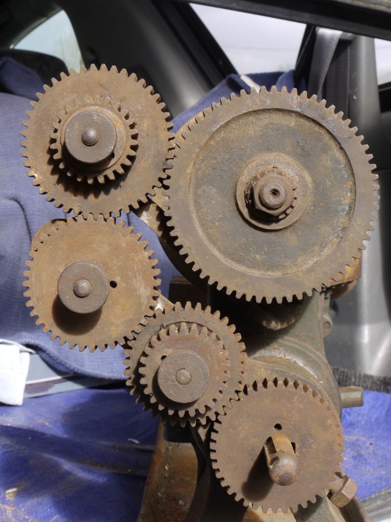

                                    I have pictured the change-wheel train 'as found' for your amusement.

                                      Keith Long
                                        @keithlong89920
                                        Micheal
                                        Looks as though most of the "discolouration" is muck rather than rust, even the bed appears in pretty good nick and as it's cast iron should only have a very light surface rust that will come away easily. I've found my lathes in much the same condition have come up pretty well with a good soak in oil followed by wiping down shifting most of the grime. Please give the bearings a good soaking in oil before you try to turn the spindle over – you might need some penetrating oil if they are tight – remember Drummonds don't stock spares!!
                                        The nut on the end of the mandrel looks decidely non-original, be interested to hear what thread you find on there, I've got two different threads among my machines – unfortunately so close together that you can't easily identify which is which just by looking but the end nuts are definitely NOT interchangeable.

                                          Michael,
                                          Big believer in Brick and patio cleaner from Toolstation.
                                          Before.
                                          After.
                                          Both photo's untouched, this is just how they went into the solution and how they came out.
                                          If you join the Drummond group on Yahoo and look in the files and photo section some of the owners converted theirs to a tumbler reverse, years since I have been on there so not sure what is there.
                                          What I do know is that I made a batch of the gears for these 2 or 3, not sure but I'm certain I have some left if you are interested in using this as opposed to leaving it standard.

                                            Thanks for the comments and suggestions, Gentlemen
                                            It will probably be next week before I can do any more to it; but today's preliminary investigations were very encouraging.
                                            • When removing the lathe from the baseplate [drip tray], I found two of the bolts already sheared, but, with a few drops of PlusGas these were out within the hour.
                                            • The only significant damage seems to be the handwheel on the slide, but that will be easy to fix by boring-out and fitting an insert.
                                            • The headstock spindle rotates nicely, and the beaings feel good.
                                            Not bad, considering it's about 100 years old.
                                            More in due course.
                                            P.S. [John] Thanks or mentioning the backgear, but I'm planning to keep it original [-ish].

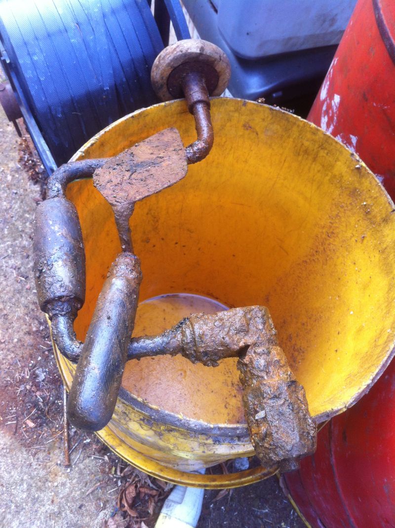

                                                Last year when I was sorting an old shed out ready to pull it down I found a builders bucket with some tools in it full of water where the roof had been leaking. These had been in there for 8 or 10 years and I was going to skip them but decided to see how good they would clean up.
                                                I think they are a bit far gone ?
                                                Anyway a full day in the tank and got this.
                                                The drill actually worked without any oil on it. It won't replace missing metal eaten away by the rust but it will remove the rust..
                                                I have read that you can do the same by electrolysis and washing soda with good results but just a tank you drop stuff in works for me with no faffing about.
