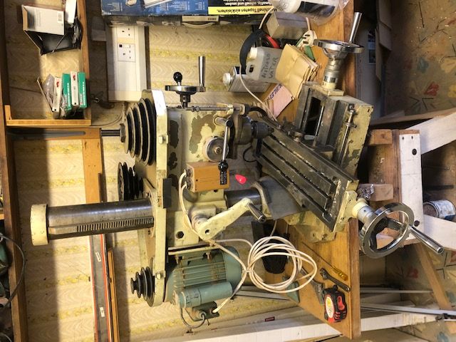

        Hi All,
        Today I finally took the plunge and brought myself my first mill. It's a second hand old Warco and I got it for a really good price. The model number VM 15 model and is driven by belts to adjust the speed.
        I was wondering if anyone has the same model and if so do you happen to have the instruction manual? If so, would you be able to email me a copy?
        The mill came with a box of end mills, face mills, drills, collet chuck etc but doesnt have a vice.

          How big is a VM15?
          #522142
          Pete.
            @pete-2
            Posted by not done it yet on 23/01/2021 20:
            How big is a VM15?
            Got a photo of this mill, a Google search doesn't reveal one of these machines?
                        Hi Pete,
                        Yes, I did have a google about but it didn’t bring anything up.
                        Please see attached the photos. Apologies for the quality I took them quickly when I brought it but then had to dissemble the mill into manageable pieces to get it out of a first floor flat workshop..

                                    hi Steve, I think you actually have an early Warco Economy mill/drill Warco Economy
                                    Regards Nick.

                                      Certainly looks like the Economy mill – I think it was 'badged' by a number of companies years ago. Good and solid assuming its not been abused, not much to go wrong otherwise (i.e. no Iffy electronics)
                                      I'v got a similar sized more modern machine (but dovetail column etc) and generally find that I use my ARC Precision Tool Vice Type 3 most of the time for a lot of things. I've 3 or 4 other vices of varying types but rarely use them, I do have an 'economy' tilting one that I bought when first starting out but don't think I've ever had call to use it.
                                      I would consider getting a couple of assorted slotted angle plates though if you don't already have any. So many clamping options avaiable with a bit of ingenuity!

                                          ..if you can't download the Grizzly manual ( 'now discontinued' ), in Nick's link above, an internet search for 'RF-25 mill manual' might bear fruit.
                                          Also the Grizzly manual for it's bigger brother, the G0705, is still available to download – notwithstanding slight differences in capacity and maybe detail variations, the layout of the controls and the manner of operation is pretty much the same, I think.
                                          Looks a useful machine, I like the stop on the Y axis, it shows some previous owner was thoughtful..

                                                    Thanks a lot. This worked a treat. It states in the manual that it's weights circa 200 kilos. I can now reflect on how much fun it was (or rather not) getting it out of a first floor workshop without a lift!
