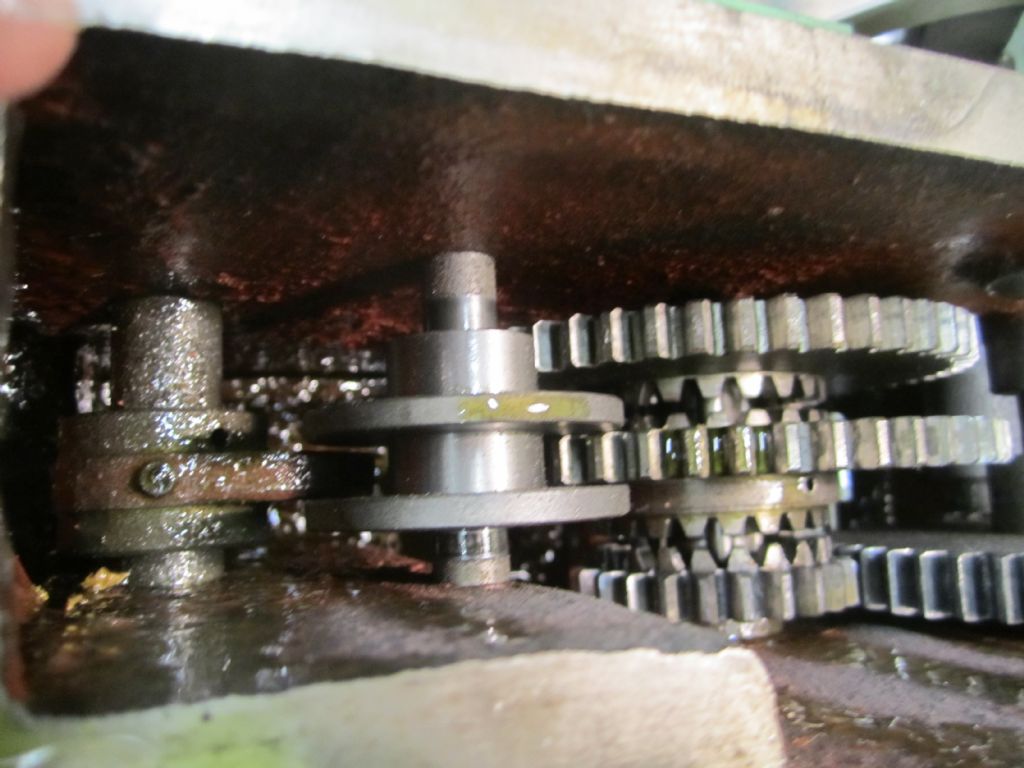

      Looking for help and advice on my Warco GH 1224
      I have been attempting to screw cut on my lathe, and it was disastrous, I followed the chart that is on the lathe – selected the correct gears to cut a 1.25 metric thread, treated myself to an external and internal cutting tool with the correct bit attached, set the lathe to a slow speed and put a light cut on
      Engaged No 1 on the dial and away it went, stopped put the saddle back to the start and set it going again this time it cut right in the middle of the first cut….!!!
      started again with the same result, then noticed a lot of back lash in the saddle and the cross slide – See Photo's in the album
      Question 1 what am I doing wrong
      Question 2 what can I do to get rid of the back lash
      Suggestions please

          I have actually removed the saddle completely off the lathe and have begun to strip it down and have found several things that do not look to clever, for example the siliconed plug – bear in mind this is how it arrived from New, I never saw it as its located on the base of the saddle
          #142268
          Trevorh
            @trevorh
            Then there's all the dirt in the bottom of the housing

              All machines have a degree of backlash in the system and for this reason thread cutting etc are always approached from one direction to eliminate/minimize the effect. Just a couple of questions, (a) were you using a thread cutting dial to align the tool to the thread, (b) if so were you engaging the half nuts at the correct point as indicated on the dial. If in doubt then then pick a particular interval line on the thread dial and use this for each pass of the tool. It takes more time as one has to wait for that interval/marker to become aligned with the indicator datum mark. I assume that the half nuts were fully engaged during each pass and the control lever in the fully engaged position.
              When the half nuts are fully engaged there should be little if any longitudinal free play on the saddle. If there is check for play and/or wear in the lead screw, half nuts etc and adjust so that this is all at a minimum.
