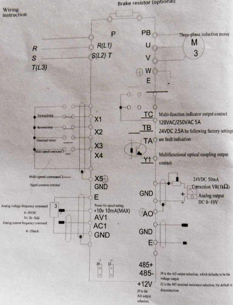

      I am fully aware of the 'you only get what you pay for' expression relating to purchasing cheap tools and equipment. I recently bought a VFD off Amazon mainly because I needed it quickly and my order placed very late in the afternoon arrived noon the next day. I could have got one from one of the respected well known UK suppliers but I imagine the lateness of me phoning them and the cost of next day delivery (even if it was possible to arrange) would be at a significantly higher cost than the Chinese cheapie now driving my lathe. (It cost £64 for a 2.2KW unit)
      There is a downside to this bargain VFD, Its not quite plug and play!
      Documentation accompanying many Chinese manufactured products has for a long time been known to be of poor quality, typically bad translation with spelling mistakes and often serious error and omissions. This VFD came with a small stapled booklet which is virtually all text (well tables of all the parameters etc) plus three diagrams, one of which is this one,vfd wiring diagram.jpg I've done my best to enhance the contrast and fit the image to the available resolution on this site. The diagram seems to have been printed in grey and black ink with scant regard to registration and even less regard for accuracy.
      Unusually there is not the usual 'quick install' or wiring guide and no views of the physical terminal blocks so the unsuspecting end user is left to their own devices. Being accustomed to VFD's in general I was able to connect the mains input and the three motor phases so was soon able to run the motor with the VFDs own panel. The fun starts when one wants to connect a remote pendant when the supplied diagram is not much help.
      I was able to work out and get the remote controls operating and have no complaints about my purchase now but I just wanted to point out to anyone on here that its sometimes spending a little more (probably double in my care) to get a recognised brand of product that comes with support.

            Interesting diagram. The part that concerns me most is that the motor is shown connected to PB, U and V, with W connected to ground (earth).
            That is the kind of image that perhaps you should not post online anywhere as if it escapes into the wild, it could have consequences.

                    From what I can see it seems the printing has slipped down with regard to the outline and terminals of the VFD outline drawing. So the top right hand 3 terminal should be U, V, W from top down.
                    I can see how this may lead to confusion but the VFD terminal designations do match the common format for other makes.
                    Ian P if you can PM me I can help correct the errors.

                      I agree with Clive in that the terminal labelling is all out of line with the functions. Very scary ansd potentially dangerous for those not familiar with such devices. It can be confusing enough undertanding these devices even with a correct diagram. I have to say if quality control lets this slip though in the manual, what else could be wrong?

                        Like DC3 and clive I was concerned that the terminals and the lettering seemed to have slipped, the one that caught my eye was U,V,W, that should have been the 3 phases to the motor. PB ? Very dangerous ! May be the Mods should remove the diagram lest it be copied or used by someone with NO understanding of electrics and come to harm ? Noel

                          I do not think anyone who came across this image on the internet could somehow make use of it to wire anything up. Even with the actual VFD (which I did not identify) I found the diagram bore no relation to what I had in front of me on the bench.
                          If we think diagram's P, PB, and the UVW motor terminal connections are badly labelled then what about the mains input! I would say that since the L1, L2 and L3 are only shown (in random positions) on the diagram and not on the VFD own terminals then anyone unfamiliar with this type of product might not even be able to get mains into it. On that basis I doubt leaving this image online can be any sort of risk.
