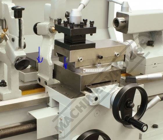

      i'm going round and round trying to decide on a first lathe. the initial goal with be parts related to vintage motorcycles and then whatever else comes along. Initially i was looking at the optimum tu-2506v (25×500 x26mm spindle bore) with a bolt-on BV20AF mill combo. but the minimum speed is 150 for threads and the few reviews I've read suggest milling combo machines end up being quite limited. And i think the quality may be a bit variable on these lathes.
      today's idea is an AL-320 (320×600 x 38mm spindle bore)- much sturdier machine and 60rpm minimum speed – and add a vertical milling attachment to it. that overall costs about the same as the option above, for a much better lathe (I think). but the milling capability will be more limited.
      so the question – is a vertical milling attachment on a larger sturdier lathe going to be a lot worse than a smaller lathe with the combo attachment.? is this trade-off worth it? truth is I have no immediate plans or specifications for the mill but a month ago i did and had to get someone else to do it for me.
      in case you were wondering, the budget has been increased significantly at least twice. it cant go much higher as i still need tooling etc.
      thanks for any comments you can make.

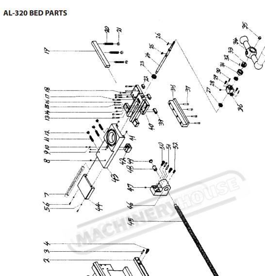

                      Before you go making any decisions about using a vertical slide or the cross slide to hold work for milling take a closer look at the AL320 you are thinking about.
                      Unlike the smaller hobby lathes it does not have a slotted cross slide and the surface is not even flat across the whole depth so you are going to have to start drilling the machine to mount a slide and there is no easy way to mount work direct to the cross slide.
                      I would also doubt that it has the flat area at the back of the bed to mount a column which a lot of the hobby lathes do.

                                  Jason / Howard – re the cross slide lacking tee slots, there are a number of videos of people drilling/tapping holes into the cross slide to mount the vertical slide…. is this a bad idea? eg this: **LINK**
                                  thaiguzzi – in an ideal wold, yes. I get the point that milling would be compromised. but i am constrained by space and money. so i'm looking for a viable start (lathe first) and maybe upgrade milling options later.
                                  cheers
                                  #385406
                                    I did say in my previous post that you would have to drill the cross slide, some people are happy to do that others would not want to touch their machines. A lot will depend on where the holes can be placed and how much metal you have to cut into.
                                    As I also mentioned and unlike the lathe in your video the AL320 looks to have the cross slide stepped up where the top slide mounts. This will limit what size vertical slide can be mounted and won't allow it to be positioned anywhere along the cross slide which is useful to allow you to get the longest movement for milling. The lower half of the slide would be quite thin so you are not going to get very deep threads into that.
                                    Also think about working on parts that are larger than the milling slide will handle, I often fix large items directly to the cross slide making use of the tee slots. It would be possible to make up a sub table with matching stepped bottom but the thickness of the table reduces ctr height so what you gain in one way you lose in the other.

                                      #385413
                                        That looks like the one in the video. Just had a quick look at the manual and the thicker area under the topslide does not look like you will have much to play with due to the large hole so it really comes down to how much metal there is to tap in the lower section.
                                        #385414
                                        Mike B 1
                                          @mikeb1
                                          tomorrow i'll go and measure the thickness of the lower cross slide section. obvioulsy thicker is better for tapping a thread into. any estimates of a minimum thickness that you would feel comfortable with?

                                                    I would think a slide that size takes M10 or M12 fixings so around one diameter minimum to be sure
                                                    #385585
                                                    Mike B 1
                                                      @mikeb1
                                                      ok so i'm retreating form the al320 after looking carefully at the stepped compound slide and its lack of T slots. otherwise a nice machine for my purposes. I don't have space (or $) for a separate mill and a small mill/drill would not replace my drill adequately. So back to 26mm spindle bore machines with slotted slides. So maybe back to the tu2506 with (or not) and back standing milling attachment or maybe an older cq6128 (250x270x26) which is heavier and more solid than the tu2506 but with the same bed width tho the downside being belts to change the speed and still a minimum speed of 125.
                                                      i did have a long chat to a retired tool maker who spoke positively about doing lots of milling on a lathe with various attachments to the cross slide so that just makes it more confusing.
                                                      when someone said there was not the perfect lathe i didn't think it would be this tricky! the search continues…
