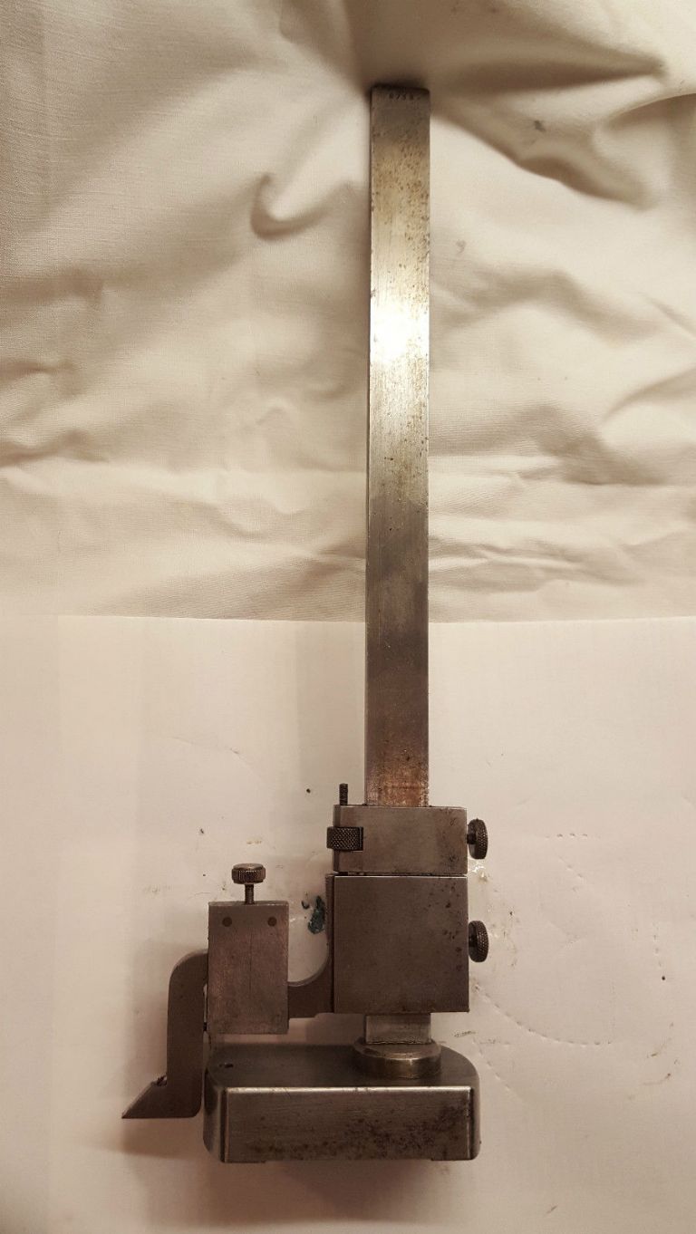

        I've just acquired an 11" English N.S.F. Co Ltd vertical height gauge from the bay of e
        It is missing the scribe and clamp, does anyone have drawings and measurement details for the scribe please?
        Or where I can get a suitable replacement?

              Hello Roger
              I have the same height gauge and I have the dimensions of the holder and the blade.The holder is 1.168" long .581 high .275 wide the slot is 50th from the end and .737 long with a knurled screw in the end,The blade is .175 wide 2.252" long .360 high with a 30 degree slope.Let me know if you require any more information.Hope this helps.

                              Hi Frank,
                              Thanks for the info, do you happen to have a photo please? Can't quite visualise it sitting on the gauge, the one's I've seen have a step so they line up with the bottom of the vernier. Is it like that or does it line up with the top?

                                Hi Roger
                                The scale on mine which is only imperial starts 1" above the base. The blade on mine is straight and there is no place in the box for a cranked blade.I set the workpiece on an 1" block for marking below 1".There is a screw in the top of the block which the blade holder sits on .I can't get the hang of posting photographs I'm sorry.

                                  The crank in the scriber allows you to set scale zero with reference to the table surface. mine has a cranked scriber and the scribing/cutter is only a small piece of carbide silver soldered to the bottom of the cranked arm.

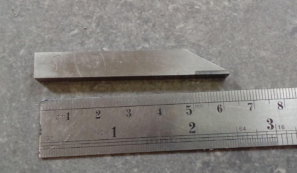

                                  #300431
                                    If you have a google you will find some old adverts that show it with the straight blade.
                                    From Bricky's description it sounds like this one I have

                                      The blade on top of the arm with the slope upwards the vernier aligns at 1" but is 1.375 above the base,this is the only position that makes sense as the other configurations of the blde do not zero on 1" on the vernier,has anyone got an explanation for this.

                                              How far off zero does it measure when the scribe is fitted slope down, must be close to zero as the scribes are just under 3/8" so that would take care of most of your 1.375" any small amount remaining can be adjusted by the two small screws that hold the venier scale

                                                I'm thinking it should be more like this one:

                                                  Though the images that I found on Google mentioned earlier and Micheal's link show them all with straight scribes
