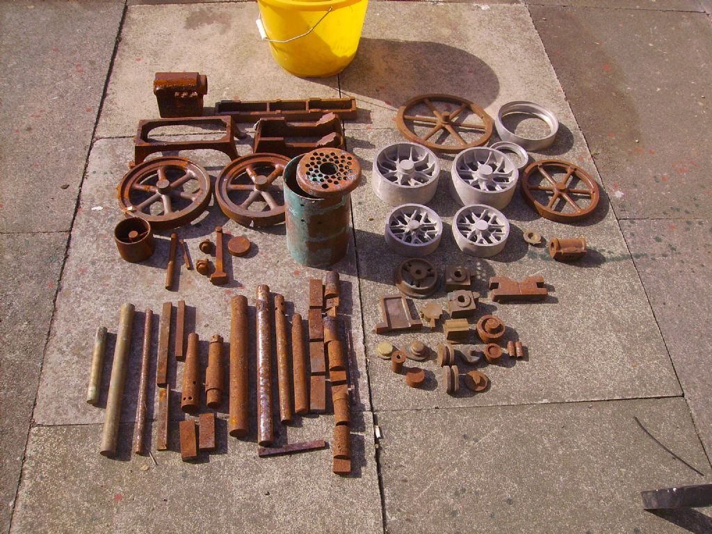

      pict0067.jpgFor sale on Ebay are some castings which I own but have not much idea what they are I do know there are some castings for the Clayton. Thanks

          Most of the bits top left are for a Perkins Hit and Miss engine
          Long thin one just below the bucket is a Stuart Victoria bed casting, the smaller flywheel and cylinder casting just below it are probably from the same engine though they are used on several Stuart engines. Looks like Pulley and cylinder end cover in with the smaller items bottom right
          upside down "tee" shaped casting nearest the middle paving joint is a Stuart beam outrigger bearing support.
          Some traction engine read hubs in the bottom right group too.
