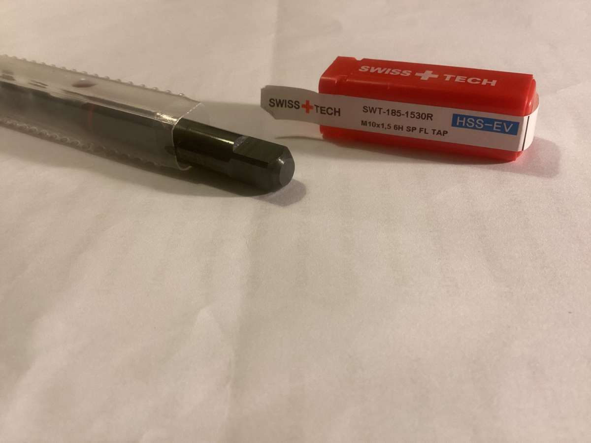

      I’ve noticed that an increasing number of newly made taps out there have a square end like the one in the picture, i.e. with no hole or point to accept the male or female end of a typical spring-loaded tapping guide.
      When tapping by hand with one of these taps held in the spindle of a milling machine, what type of tapping guide is it feasible to make to guide the tap?
      I’ve made some tapping guide ends with 90 degree recesses courtesy of spotting drills, but because of the fairly extensive width of the round tables on the ends of these sorts of taps the tapping guide ends inevitably end up being a little too wide to fit within the jaws of a standard 90-degree-jawed tap wrench.
      As an alternative solution, I’ve drilled small recesses in the ends of some of these taps with carbide drills, but I’d prefer not to have to do this. I’d also prefer the 90 degree jaws of my tap wrenches not to grip on the round shanks of the taps but on the corners of their square ends.
      Obviously a chuck-type tap wrench would get round the problem, assuming the wrench itself had a recess in the top of it, but you can’t apply very much torque with chuck-type tap wrenches because, being designed for taps at the smaller end of the size range, they have relatively short handles.
      While we’re at it, does anyone know why taps increasingly have these sorts of ends on them? The answer that they’re primarily designed for tapping under power doesn’t seem to be the explanation.

        The hole was there to hold the tap while it was being ground during manufacture; nothing to do with using a guide when tapping. Changes in manufacture mean that the hole is no longer needed.

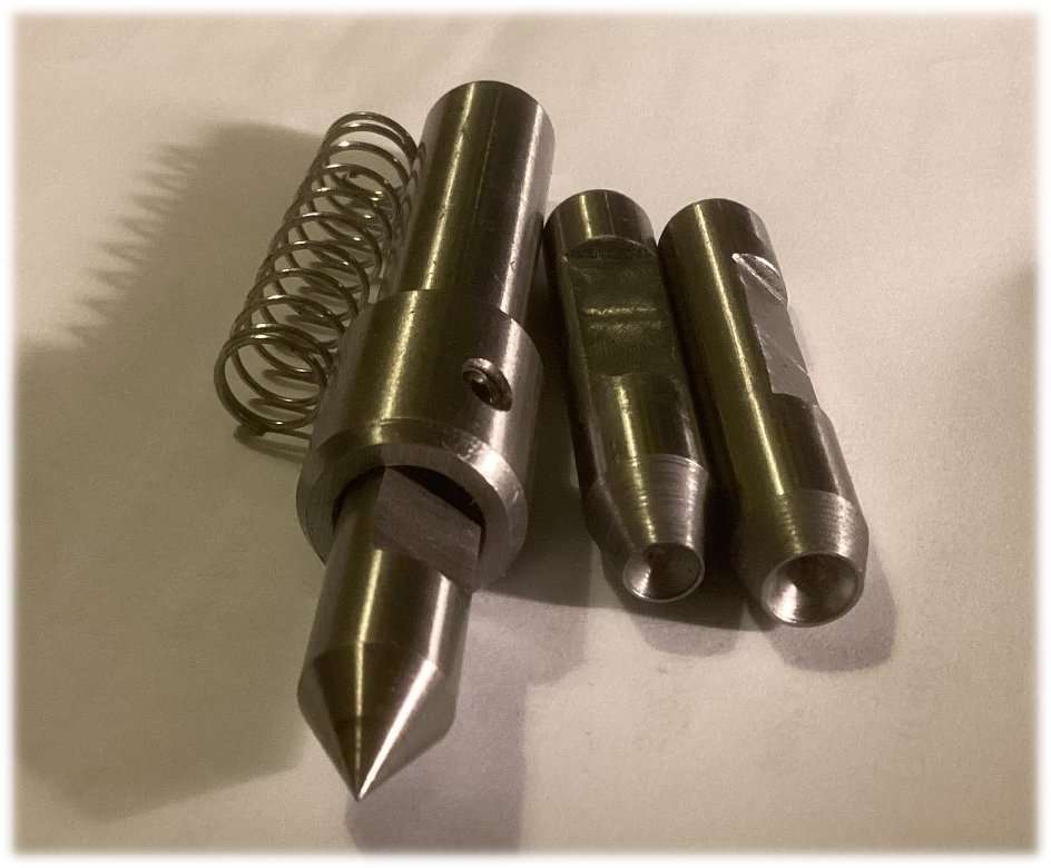

          I have a piece of 6mm silver steel drilled one end with a ctr drill and a 60deg point turned on the other. That goes into the collet or drill chuck after drilling the tapping size hole and I bring the quill down so it engages with the tap and apply light pressure while turning the tap wrench. Small taps may need the wrench positioned to grip on the round shank not the square but that is no problem.
          DSC00592
          If you are using a commercial sprung guide then rather than a point on the opposite end just drill a hole so it slips over the end of your guide’s point.

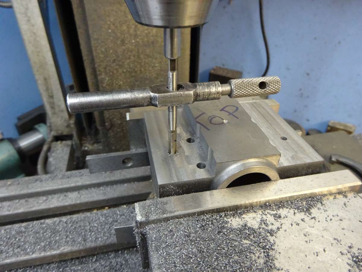

            I use one of the 3 sizes of eclipse chuck type tap wrenches and put the centre (dead or live) in the tailstock or spindle  and use the hole in the end of the tap wrench. Even the small BA sized one has a hole.  Noel.

              Might just be easier to get a tapping guide that can do both, this one has a reversable male/female end

                    The series of Tap Tru tap guides includes spring loaded guides / supports with both concave and convex ends.
                    Using chuck type tap holder (In the spindle provides support) or in a chuck type holder which can have a centre drilling for location, will maintain support and location.
                    Support is important; Taps don’t withstand being bent!

                              Tap Tru tap guides came as a set of three with spring loaded coned ends, three with spring loaded concave ends.
                              Each one is held in a drill chuck and the chuck is lowered onto the tap (with tap Wrench in place).
                              This compresses a spring, moving a small pin down a short slot in the body , so that as the tap “bites” and begins to move into the work, the tap is still guided/supported by the end piece,
                              When the travel of the pin is exhausted, the chuck is merely moved down to maintain the support.

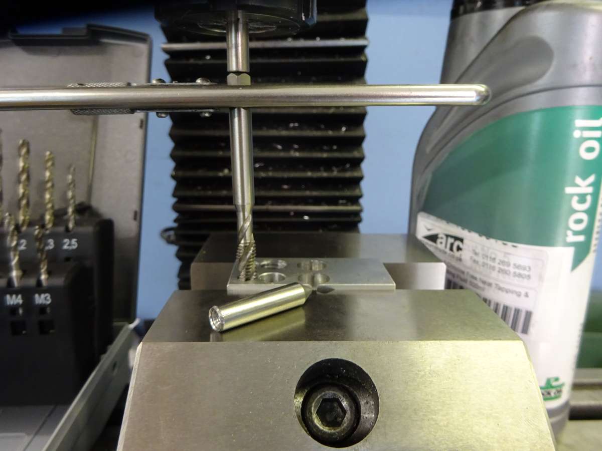

                                Being the owner of a dire set of metric carbon taps more useful for cleaning threads than actual tapping, I tried a cheap 11 quid set of the spiral taps as Jason’s borrowed photo above.
                                Having used them they start very easily and follow the hole, they don’t need backing and they act like a drill bit with swarf coming out of the hole at 60 odd rpm which makes me wonder why there’s a tap wrench in use at all in that photo.
                                #698244
                                  One that is not such a cheap set and two it was taken to illustrate the use of a tap guide in my series in MEW and my book so needs to be taken in context with the text. Taps were also supplied by ARC Euro Trade who sponsored the articles in the mag that formed the basis of my book so they got used for the photos.
                                  Machine taps be they spiral flute or spiral point can still be used by hand not only for their swarf clearing capacity but also to save time backing off and/or following up with a 2nd or plug.
                                  You do also have to be careful when using the spiral flute taps in blind holes that you don’t hit the bottom when power tapping, so doing it by hand can be safer. Unless of course you have rigid tapping on your CNC which will stop at the required depth.
                                  60rpm is a bit tame, the SX2.7 is limited to 500rpm in tapping mode but I find 200-250rpm OK for steel and you get time to react and reverse the tap before it gets drawn in too far. This is M6 into a 5mm hole in steel
