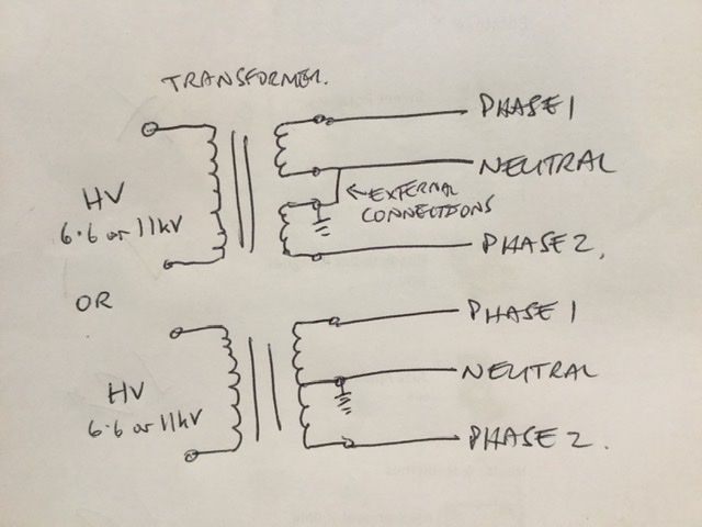

      Posted by Ian Parkin on 16/05/2020 10:45:28:
      So was Stuarts post a typo about 180 degrees and 500v between phases rather than 415v ?
      No, it wasn’t a typo. The split phase arrangement is used in some rural areas in the U.K. where there is only a single phase (2 wire) HV 11kV or 6.6kV overhead network available. It is now considered to be non-standard and only used when there is no alternative. For normal single phase supplies, a standard single phase transformer is used with a phase and either separate neutral and earth conductors or a combined neutral/earth conductor.
      With a split phase network, a transformer with a single HV winding and either a centre tapped secondary winding or two separate windings connected as below:-
      The neutral is common, but the two phases are 180 degrees apart. So between each phase and neutral you get a nominal 230v (actually up to 253 v depending on transformer tapping and voltage drops etc). Between the two phases you will get double this. In a single property, you could have say storage heaters on one and the rest of the house on the other ( with 2 consumer units).
      In this case, running the workshop (with a single phase to 3 phase converter for the lathe) from one supply and rest of the property from the other.
      Obviously in all cases needs there to be separation and labelling so that anyone doing work understands that there could be up to 500 volts between items on the 2 supplies.

                              Hi the simple diagram at the bottom shows a centre tap transformer with a single phase input, the sine waves showing the input to the diodes is what you get from the transformer. Pretty much stands to reason really.
                              Regards Nick.

                                Ian
                                The voltages are 180 degrees apart because the opposite ends of the LV windings are connected to neutral ( and earthed at the transformer). So when the ac voltage in one winding is at its maximum positive value, the one in the other winding is at its maximum negative value (relative to the common neutral connection).
                                Andrew
                                Single phase distribution transformers are connected across 2 of the HV (usually 11kV or 6.6kV) phase conductors.
                                Duncan
                                My previous post explains how a split phase transformer is connected. It is not the same as 2 of the phases in a 3 phase system which are 120 degrees apart. This is not unique to the Shetlands and could be found anywhere where there is only a single phase (ie 2 wire) HV line. It is not that common, the standard supplies provided now are either single phase or 3 phase.

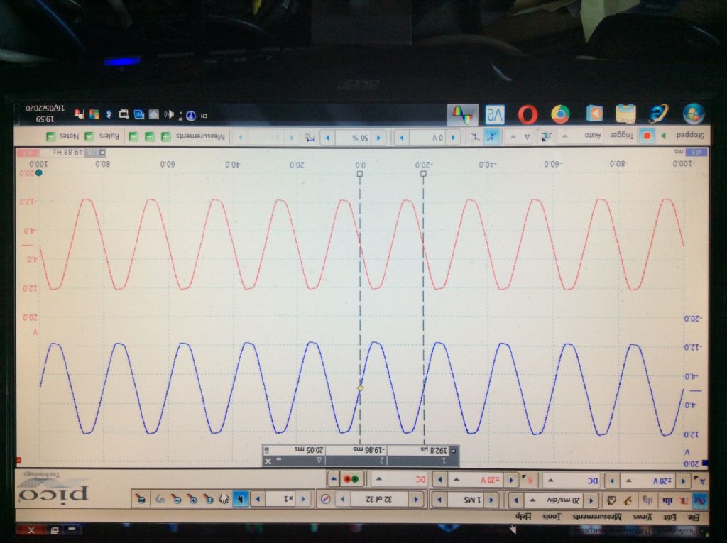

                                #472288
                                Maurice Taylor
                                  @mauricetaylor82093
                                  This is the output from a 18volt center tapped transformer with center tap as neutral.Showing 180 degree phase shift.
                                  Edited By Maurice Taylor on 16/05/2020 21:07:15
