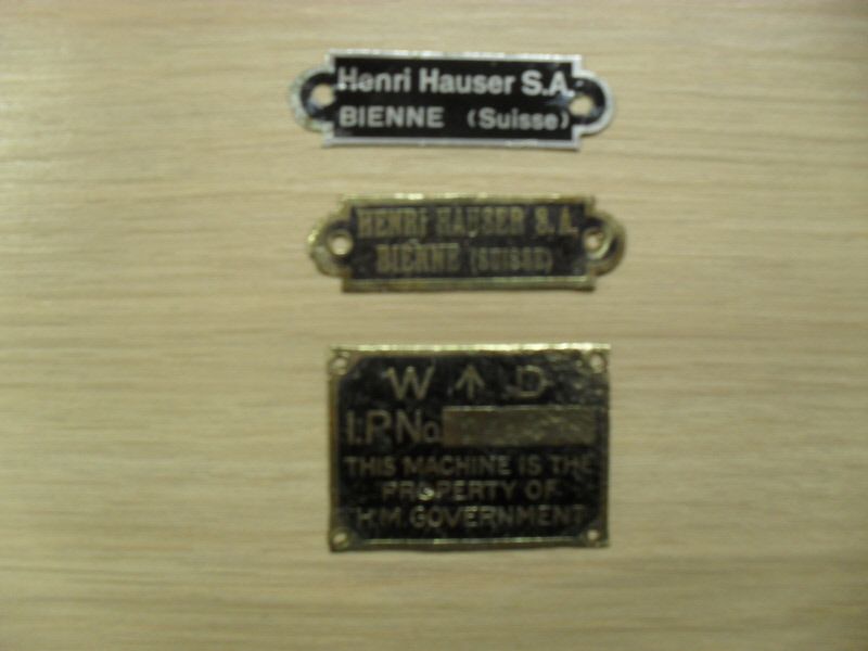

                                              Hi Stuart – Interested to hear that the spindle of my Hauser may have been manufactured at Woolwich Arsenal. The tool holder illustrated at the top of the post is one of several I have made up to accept 1/4" shank endmills (and small slitting saws) and is a very easy way of overcoming the need to source 9mm collet chucks thanks to the nominal 40 deg taper. The photo shows the makers plate attached to my machine.

                                                Dear Greensands,
                                                Thank you for posting a photo of your makers plate. It shows that your machine is not a Woolwich cast off and that Hauser produced 9 mm. spindles for other buyers. The same supplier sold the machine depicted on the Lathes.co.uk website. Is it yours?

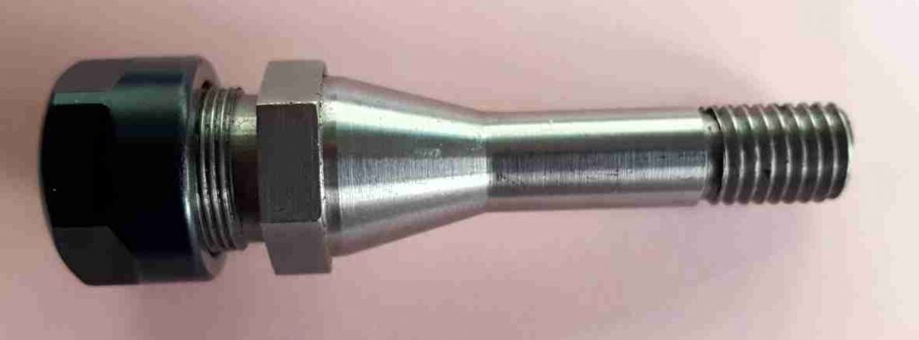

                                                The photo shows the 9mm ER11 collet holder that I have made and used succesfully. I used the 30 degree cone to centre the collet rather than the body.

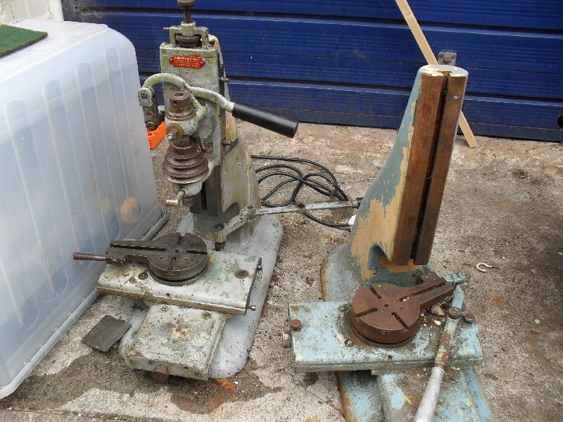

                                                    sdc10997(1).jpgGreat to see the photos and the info that some of these machines were designed specifically for Woolwich Arsenal. The two that I was given both came from Ferranti's in Manchester and may have been engaged on War work as while both have the Hauser badge (one brass and the other more a chrome appearance) one has a MOD badge as well. I assume they both came from the same batch as all the individual castings are numbered (one no 10 and the other No 11). As you can see, they were in pretty poor condition when I got them with one more or less complete and the other missing the milling carriage (I've since found some of it) so I need to do some extensive repainting and fettling. Fun project if we have a new lockdown!
                                                    Can I suggest to the moderator that it might be a good idea to rename this thread to "Hauser mill" as info one these machines is difficult to find and a better title would make life easier for someone doing a search.sdc11208(1).jpg
