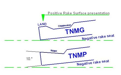

                                            I use TNMG negative inserts and find them to be effective, unless they are chipped by a hard bump against them or the spindle is stopped without withdrawing the insert from the work.
                                            Much higher spindle speeds produce better finishes. Also, better results occur if minimum depth of cut is .005" The inserts have a built-in chip-breaker groove which produces a virtual positive rake IF the cut-depth of .005" is met.
                                            This has generally increased the speed I run my small lathe, including parting-off at 300 RPM!
                                            The toolholder must hold the insert with negative rake to provide relief. If you view the insert edge it lacks any relief as it is molded at 90 deg.
                                              Quality TNMG inserts are able to take moderate interrupted cuts without chipping. Higher RPM seems to fix  problems with carbide inserts (and this was a difficult transition away from slow and careful). The quality holder I purchased from PlasTools 10 years ago is a "turn and face" style. You set it to face without a pip and then you begin turning.
                                              I made this drawing to illustrate the differences of TNMG vs TNMP (the TNMS is 20° compared to the TNMP's 10°. Note that these inserts must be mounted in a tool seat at a negative rake. In the illustration, the seat is approximately 7° compared to the phantom green base line. TNMP do not like interrupted cuts.
                                              The width of the land determines the minimum cut. If you take cuts less than .005", the insert will not be cutting in the positive ramp area behind the LAND, so it will exhibit tendencies of other negative rake tools (higher pressures, not-as-nice finishes). The TNMG inserts I have used have a very narrow land and I can remove .001". Eventually this land wears from heavy use and you then won't be able to take fine cuts. But, the price per insert tip (6 tips) is attractive and if you follow the guidelines, the name brand TNMG inserts last a long time.
                                              At higher rpm, the chips turn blue, the insert stays cool, the workpiece stays cool and the finish is very nice. Try .025" (radius) cuts in mild steel at 300 sfm and see what TNMG will do on your machine.
