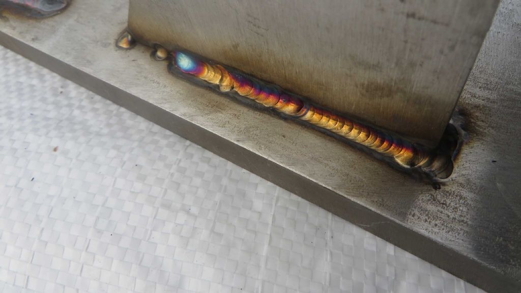

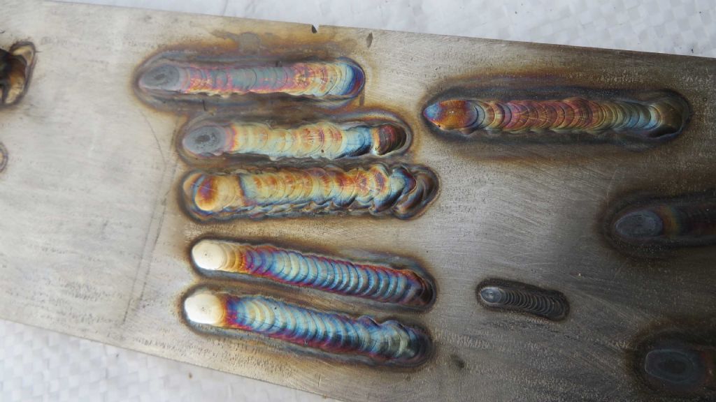

                      First go on some stainless scrap was this:
                      just ran some beads then tried a corner joint.
                      starting and stopping are the messy bits but as long as you get REALLY comfortable BEFORE you start it makes life much easier; any tension in your posture or position seems to translate directly to the work.
