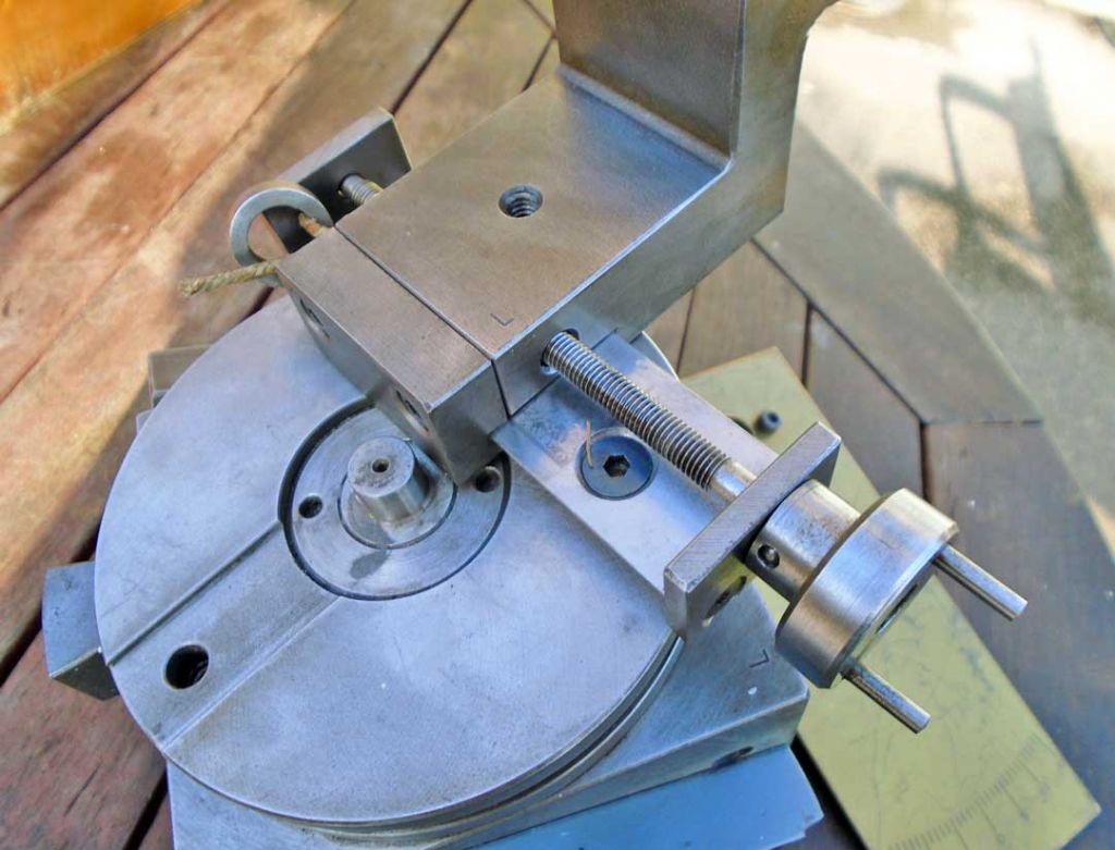

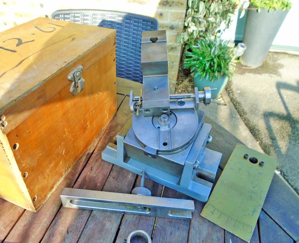

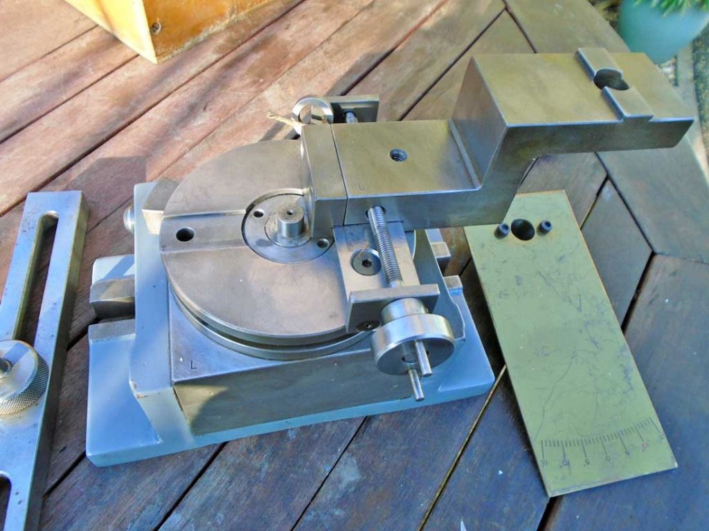

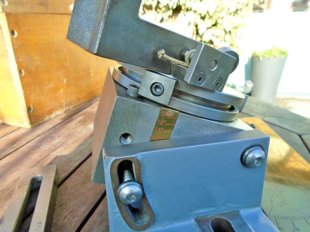

      Hi All, Got this today at our local car boot, very heavy but cleaned up nicely.
      My only thoughts are that it might be part of a tool & cutter grinder?
      No makers marks anywhere so I assume it is user made. Any help would be welcome.
      Cheers, Martin

        #392139
        Baz
          @baz89810
          Congratulations! You have got yourself a Clarkson radius grinding attachment and the brass plate is an angle gauge for clearance angles on cutter flutes.
          #392140
          Martin King 2
            @martinking2
            Hi Baz, Thanks for the info. Cannot seem to see how the odd bits fit on the main part? Is it complete?

            #392144
            David George 1
              @davidgeorge1
              Hi Martin have a look on Lathes.co.uk Clarkson tool and cutter attachments.
              David
              #392145
              peak4
                @peak4
                Congratulations on a rather good value purchase.I never see anything like that at our local car boot sales.
                Bedroom Workshop is one of the better resources for Clarkson stuff.
                Bill
                #392149
                Baz
                  @baz89810
                  Hi Martin, I think you have a couple of bits missing, will dig my one out tomorrow and try and get a photo.
                  #392151
                  Martin King 2
                    @martinking2
                    Thanks guys, that is all really helpful info. The guy I got it from said he has more to clear from the same source and I have his number so will check to see if the rest of it might come to light.
                    Cheers, Martin
