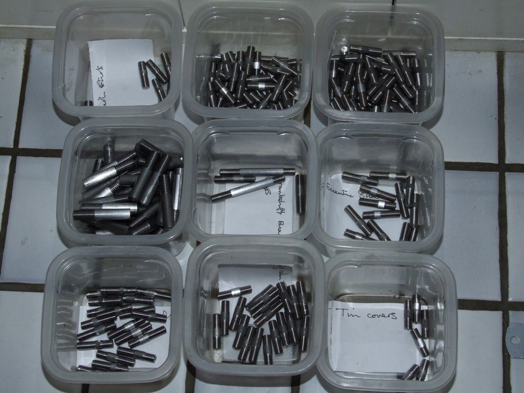

                Bright drawn round rod is usually a thou or two undersize to start with. A UNF thread isn't coarse pitch so I wouldn't bother with a chamfer, turning down or multiple passes. Just set the die and cut the thread in one pass – job done. The time saved can be used to down a beer or two.
                I've made hundreds of studs for my traction engines, all from stock material, no chamfer and cut in one pass:
                I'll state that the studs have been made on a repetition lathe, largely using a Coventry diehead, but the end result is the same. Some of the studs were made using a split die, where I didn't have, or couldn't find, the requisite Coventry dies.
                Andrew
