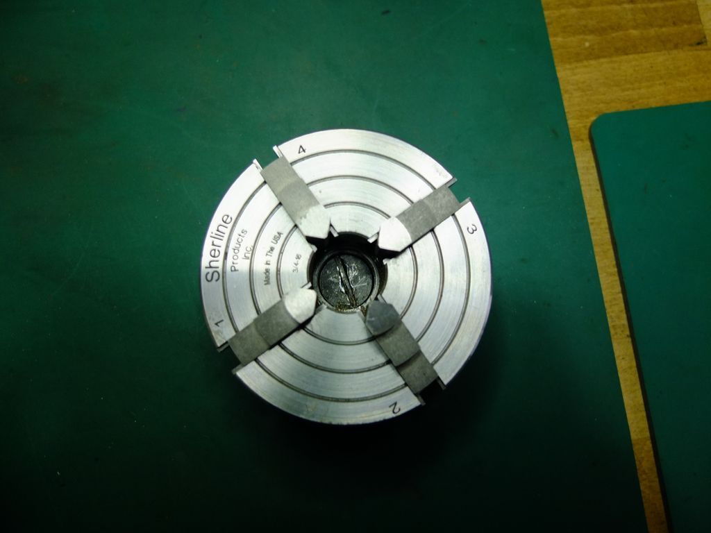

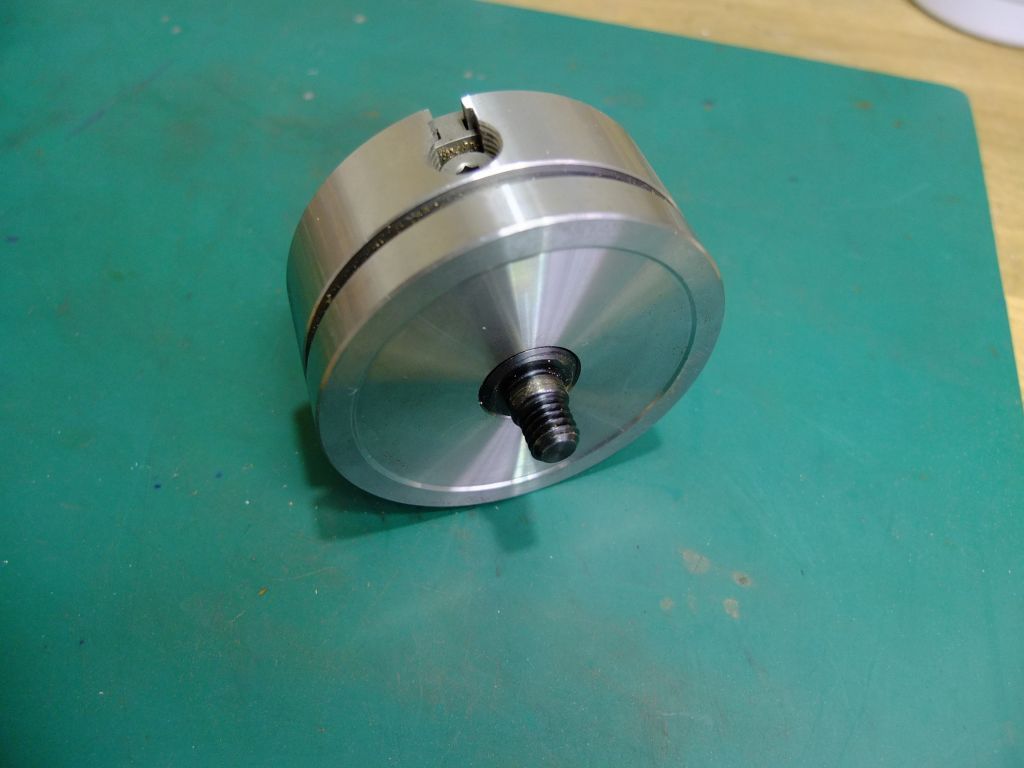

        Here are some pictures of my 4 jaw chuck with a rotary table adaptor.
        I've never had a problem before but somehow the adaptor has become stuck in the chuck.

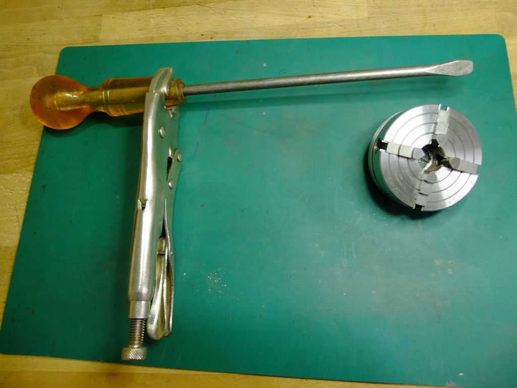

        I tried holding the adaptor in brass jaws in the vice and turning the chuck but I couldn't get the vice tight enough to grip.
        Next I got the biggest, baddest screwdriver and ground the end to fit the slot exactly, put the chuck in the vice – didn't budge.
        Even with mole grips on the screwdriver – same result.
        I thought of locking nuts on the spindle and turning it off with a spanner but there is just enough thread for one full nut never mind two.
        I would rather not damage the adaptor but will if I have to.
        Anyone got any ideas?
        Cheers
        Steve

          It's not one of those datt things where it happens to have a L hand thread and you've forgotten?
          Other obvious options heat or freeze to hope some differential expansion loosens it? A tap on the bottom? Soak the whole thing in penerating oil overnight? Make up a T-handled driver for even more purchase?

            Have you got an impact driver, the kind with the 1/2" square drive? Mine has an adaptor which takes flat screwdriver bits up to 1/2" wide.

              Maybe you need an even bigger, badder screwdriver with a shorter shank, or an adjustable spanner on a piece of steel flat ground to fit the slot over its full width or near ?

                Even better if you could hold a hexagon shank screwdriver bit (Make one? ) in a socket in an air Impact gun. It might eventually hammer loose.

                    Try warming the chuck before you get too violent. If you've got a nut that fits the thread saw though half way on a point, so that when you put it in the vice the nut will close up on the thread, that will help to prevent damage to the thread, and the mass of the vice will tend to keep the threaded bit cool.

                        The structure of the part would be good. If you are trying to loosen the chuck, while being clamped on both sides will need considerable force – and it may just slip at that point.
                        If the screw inside the chuck is simply threaded into the rear piece, they did not make that slot that length for no good reason!
                        Make a wide blade to fit the whole length of the slot and then apply a turning force – in the correct direction. Two adjustables would suffice. Preferably one being of the ‘mole wrench’ type. Securing the chuck in a vise is likely better than holding the rear thread until loosened.

                          I am not familiar with Sherline lathes but it seems odd that its mandrel has a 3/8" UNC internal thread rather than the conventional male thread and register for the chuck/faceplate etc.
                          In any event does the screw with a slotted head actually have a shoulder at some point or does it just like a large grub screw that converts the UNC to the chuck thread?
                          I know the above does not solve the problem, but AIUI (or dont understand it) what it the screw stuck against?

                            Are you are able to drill a hole for a 'tommy bar' into the side of the adapter, say 5/16" dia x 1" deep?
                            If so then, by removing two of the chuck's jaws, you should be able to grip the chuck in a bench vice using the remaining chuck jaws (the front face of the chuck will be lying flat on the top of the vice). Then insert a bar – an Allen Key may do – in the drilled hole and clout the bar (gently at first) to remove the adapter.

                                This should make it clearer, Ian : **LINK**
                                Chuck Adapters for Rotary Table

                                    Thanks Michael, your link shows what that the adapter larger diameter thread fits the chuck body.
                                    I now assume that the chuck thread has a shoulder or restriction (where the thread runs into the smaller tapping diameter) otherwise the adapter would pass right through the chuck body. If not what is it jammed against?
